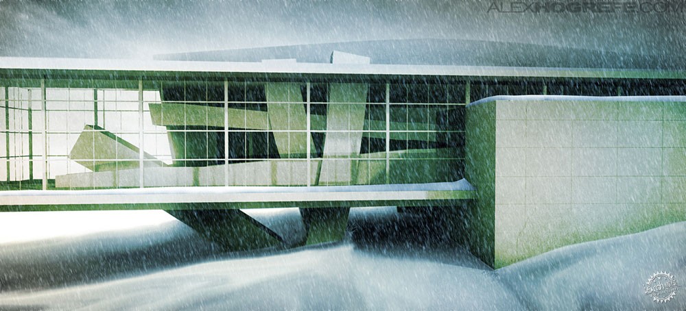

冬季特效图#5第1张图片
Winter Special #5
由专筑网严越,刘庆新编译
自从去年的失误,今年我挑选新东西来做冬季特效图的研究实验室设计。这次将照相机移动到体系结构下方,以便提供在靠近入口时体验的感觉。图像是直接用许多周边环境纹理和风景快速地创造。你会看到的屏幕和半透明的面板是在 photoshop 中添加的。我仍然在试验这一部分的设计,但通过这个图像,我能够专注于细节。下面是一个快速的指导,然后有所有以前的冬季特效图的链接。
Since I dropped the ball last year, I am picking things back up this year with a new winter special illustration of the research lab design. This view moves the camera underneath the architecture to give a sense of the experience one has when approaching the entrance. The image was pretty straight forward to create with much of the context texture and landscape coming together quickly. You will see that the screens and translucent panels were all added in Photoshop. I am still experimenting with this part of the design but was able to narrow in on final detailing through this image. Below is a super quick breakdown followed by links to all previous winter special posts.
