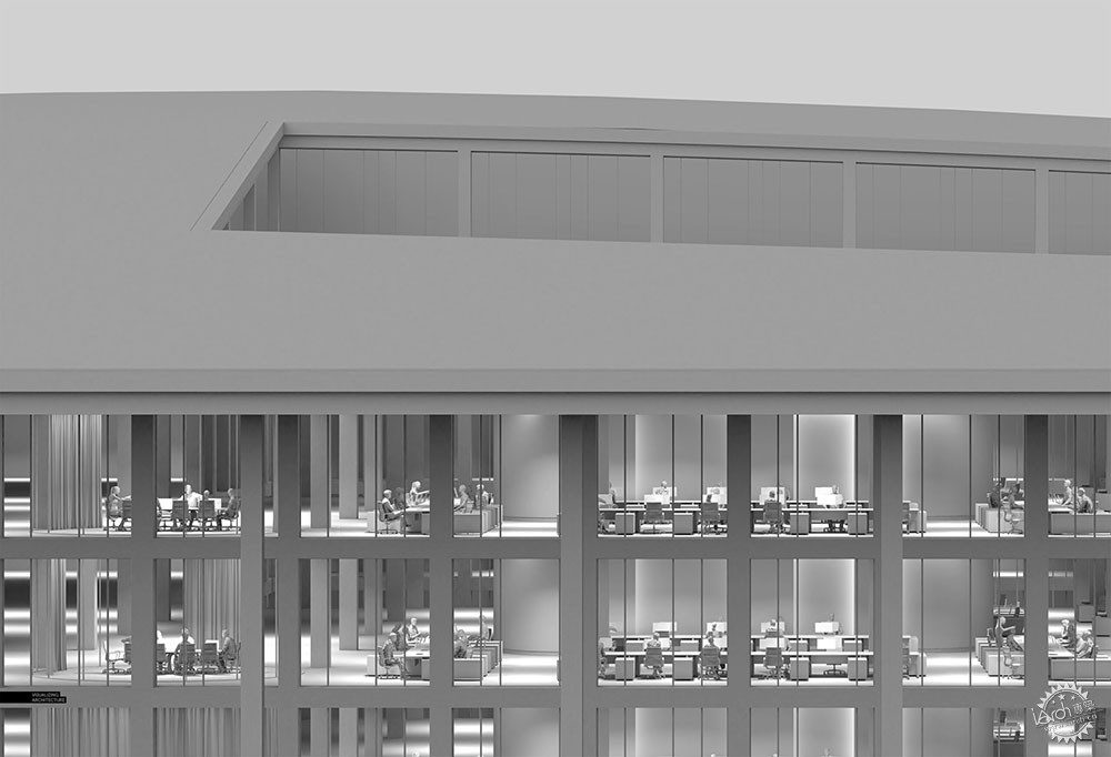

V-Ray白模细部
V-Ray Clay Model Rendering Close Up
在这样的画面中,如果想要通过蒙版来表达如此多办公桌旁边的人简直太艰难了,除此之外,这个空间的照明位于正上方,因此要找到合适的剪影也相当困难。因此,我在这个场景中应用了3D人物,在Design Distill中,我们一直在画面中应用3D人物,这样能够很好地捕捉场景中的灯光,并且节省时间,因为不需要通过PS的蒙版操作。3D人物在近景中不太好看,但是远景却很完美。
如果我的时间比较充裕,那么我会在桌子表面表达多一些的细节,并且在目前看来有些空旷的地面区域添加一些休息区,这里有很多的细节来表达,但是时间有限,我只能做到这样了。
For an image like this, trying to mask so many people around desks would have been a nightmare. On top of that, the lighting for the space is directly overhead, so finding enough cutout people with the proper lighting would have been equally difficult. Therefore, I used mostly 3D people for this scene. At Design Distill, we use 3d people all of the time in the images we make because of the fact that they perfectly pick up the lighting of the scene and the time that it saves not masking in Photoshop. The 3d people do not always look great up close, but are perfect for situations like this where they are seen from a distance.
If I had a little more time, I would have liked to add in more details on the desk surfaces and add a few floating lounge spaces in the areas of the floors that are still a little bare. There is simply an endless amount of detail and little narratives that could go into a view like this but the weekend was coming to an end so I had to call it.
