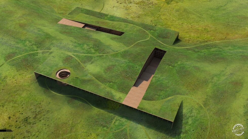

V-Ray基础渲染
V-Ray Base Rendering
我的大多数基础渲染作品在一开始看起来都很丑,这张看起来也是一样,在我一开始看到它的时候,我甚至想立刻关闭它。
Most of my base renderings look bad starting out, but this one looks exceptionally horrible. Getting started on this image, I saw this base rendering and this was one of the moments that I just about backed out of this image haha.

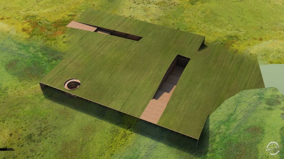

我应用了多种不同的肌理,在场地上构成不同的色调和密度,并且保持一定的清晰度,在这个方面我花了很多时间,从而构成了山坡的空间感,你会发现其实有很多重复的肌理,但是在我添加道路和植物之后,这些重复的感觉就会被弱化。
As I mentioned above, I combined many different textures to build in a diversity of color tones and densities throughout the site while maintaining sharpness and detail up close. There was quite a bit of time spent rotating and skewing the textures so that they had the feeling of going up and down hills. You may notice that towards the end, you start to see a lot of repeat textures, however, this gets broken up and lost in some of the following steps as I add in paths and trees.

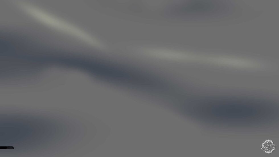

教程:德州草原办公楼鸟瞰图第13张图片
独立的细节
Details Isolated
教程:德州草原办公楼鸟瞰图第14张图片
在画面中加入细节
Details Inserted into Image
添加草地之后,我开始在其中添加一些细节,树木能够很好地强调整个项目的景观设计理念,另外,一些小路已经形成了,因此我按照流线来摆放树木,除此之外我还增加了一些人物,让画面更有肌理感。
With the grasses in place, I could start to add in the details. The trees were important to emphasizing the idea of the landscape flowing around and over the project. Again, since the paths were in place, I used them as a framework to help place the trees. I also added lots of people which at this point, was just another way to build in a little more texture.
