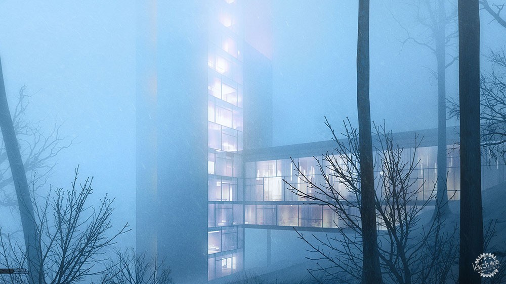

对于今年的冬日场景效果图,我希望制作一系列的图像,一部分是因为我无法决定某个视角,同时也是因为想要测试一下不同角度的雨雪对于画面的影响。相比于建筑图像的清晰度,我更比较看重空气的深度和光线色彩在雪中的呈现效果。因此我希望自己少花一些时间在这些图面上,这样才能不会被细节所影响,把更多的时间放在真正应该注意部分之中。
我将步骤分解如下,这样能够更清晰地表达结合在图面之中的色彩与雾面,最为重要的步骤是将光线分隔出来,然后添加在雾面之上,因为这样能够表达出光线穿过雾气的效果,同时其他部分也会结合雾气的色彩来呈现。
For this year’s Winter Special illustration, I decided to create a series of images partly because I couldn’t decide on one view, but also to experiment with the effects of thick snow at different view angles. I was less interested in the architectural clarity of the images and more interested in the atmospheric depth and how light and color react in a thick snow storm. I also forced myself to spend less time on these images than I normally would so that I would get less distracted by the details and focus more on the big moves.
I am breaking down one of the images below to show the layers of color and fog inserted into the image throughout the process. One of the most important steps was to separate out the light and move it above the fog because of how light seems to cut through the haze whereas everything else softens and absorbs the tones of the fog.
