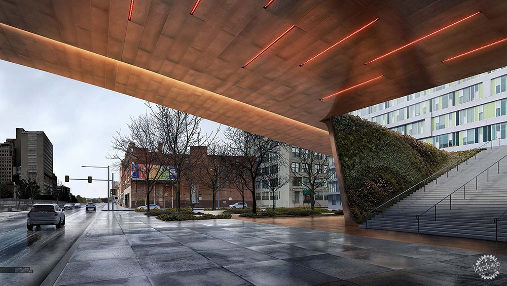

4、通道顶部|Bridge Ceiling
教程:冬季雪景风格效果图制作第6张图片
在这里我想着重于桥体的表达,因此我调亮了其饱和度,并且添加了一些LED照明设备。我不想桥体底部因过于黑暗而失去吸引力。然后我也为LED照明设备增加了一些动感元素。
I wanted to do something to draw attention to the bridge, so I dropped in some LED lights and amped up the saturation of the panels. I didn’t want the underside of the bridge to read too dark and uninviting. The LED’s also add some much needed movement to the image.

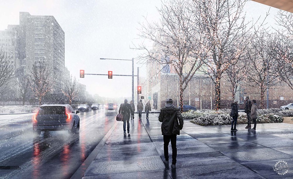

10、雪花|Snow
教程:冬季雪景风格效果图制作第12张图片
教程:冬季雪景风格效果图制作第13张图片
教程:冬季雪景风格效果图制作第14张图片
雪花最后再加入,覆盖在部分背景之上,将桥体投影与其他物体之间形成对比。你可以在我曾经发布过的教程中找出雪花的添加步骤。
Finally, the snow was added washing out some of the background and creating more contrast between the shadow of the bridge and everything else. You can find a tutorial on adding snow HERE.
