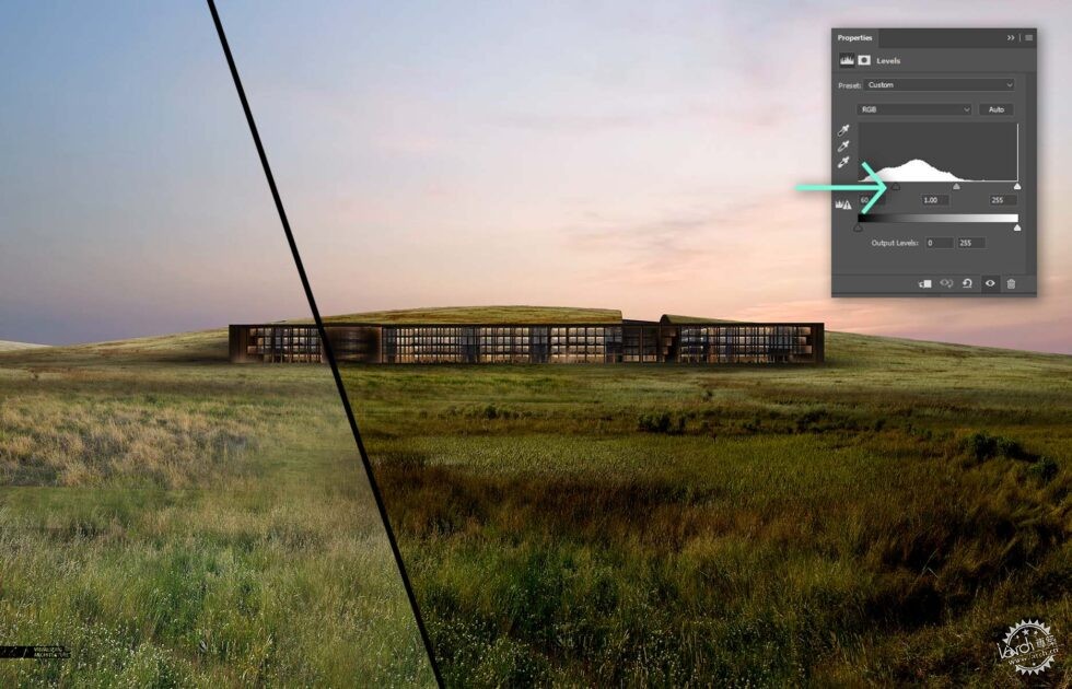

在变暗之前,我首次展示了草地,它由四到五种不同的肌理构成,并且有着类似的灰绿色。我把肌理结合在一起,并且需要让草地变暗一些,我分成了两个步骤,首先,我调整了图层,强调对比度,加深阴影,但是草地的深色部分会由于阴影的加深而失去一些细节。
1. Toning the Grass
I am first showing the the grass before it was darkened. The grass is made up of four or five different textures and toned to have a similar desaturated grayish green. Once I had the textures stitched together, I needed to darken the grass significantly. I did this in two steps. First, I adjusted the levels to punch up the contrast and to deepen the shadows. In some cases, the darker parts of the grass started to lose some of the detail in the shadows.

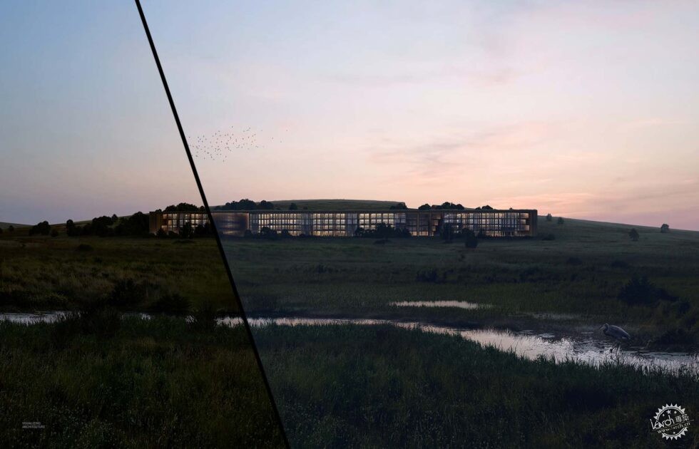

我在画面上添加了树木和溪流,在目前的状态下,它们要么变暗要么变亮,对比比较极端,那么针对水流,我设置了蒙版,翻转天空,这样水流就能反射同样的色调了。
2. Additional Details
I added in lots of trees and a stream cutting across the image. In both cases, they are either shifting really dark or really light continuing the extreme contrast. For the water, I setup a mask and simply flipped the sky so that the water reflected the exact same tones.
