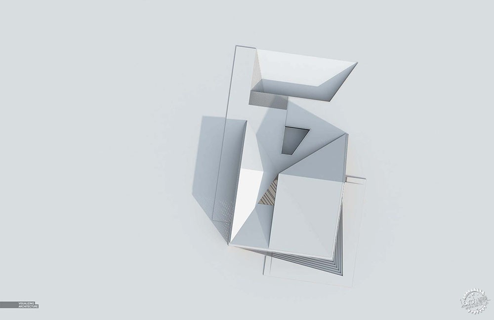

1、快速渲染
教程:沙漠场地平面图制作第3张图片
以上是SU的截图
1. Quick Clay Rendering
Above, Sketchup Screenshot
教程:沙漠场地平面图制作第4张图片
V-Ray渲染模型。我想要通过一些材质来表达画面,因此并不希望它在一开始渲染的时候就固定基调,这样能为后期的PS处理留出更多的可能性。
V-Ray Clay Model rendering. I am still thinking through materiality and didn’t want to have them baked into the rendering giving me some flexibility to experiment in Photoshop.

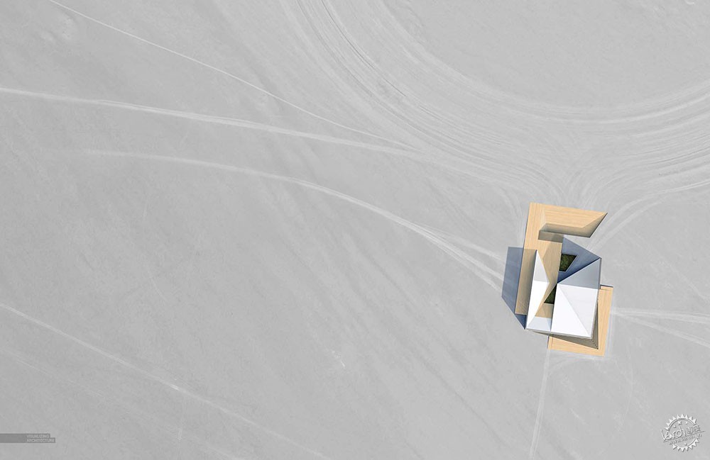

2、添加肌理
教程:沙漠场地平面图制作第5张图片
首先我需要从材质库中找到适合的纹理,最快速的方法就是谷歌地球的截图。
2. Adding Textures
I first needed to compile a library of textures that I could quickly pull from. Google Earth screenshots ended up being the best resource for this.
教程:沙漠场地平面图制作第6张图片

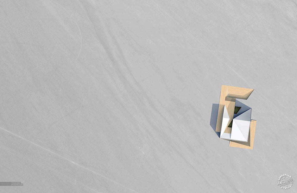

然后再分图层进行处理,首先先为整个图面添加一个基本纹理。我特意选择了一张有着方向引导性的贴图。
I then layered in the textures starting with a base texture covering the entire image. I purposely chose something with a little directionality to give some movement to the illustration.

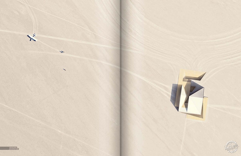

最后,我还设置了一个小型停机坪,并且为人们留出到达这座沙漠住宅的通道。
Finally, I introduced a little narrative and scale by dropping in a plane and people crossing the desert to get to the house.
