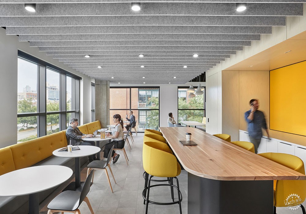

针对4人以上的空间,可以考虑宽敞或圆形布局来取代线性布局,这样能够构成开放交流区域,让人们可以看到彼此。移动式家具可以用于限定不同的功能用房,而在流线方面,重要的是构成人们能够看到彼此的安全流线,那么此时就可以适当地应用坡道、自动门、平面安全元素、标识系统等等。
亮度、光线与反射
那么由于类似的原因,光线能够起到基础的舒适性作用,同时也有着沟通的作用。与肤色形成对比的颜色能够让其他人了解到对方的面部表情和手部动作。自然或是人工照明需要保持充足,这样视觉效果才能够清晰,但是需要避免眩光,避免突然性的环境变化,这样会让人感到不安。因此可以借助窗户、玻璃、镜面来调节室内光线。专家们认为,镜子能够给环境空间带来视觉上的控制,因此需要把它们应用在恰当的位置,否则会适得其反。
Considering wide or circular rather than linear distributions for spaces of more than 4 people can facilitate an open communication channel where all participants can see each other. Divisions and mobile furniture can help organize rooms with these characteristics. In terms of mobility, it is important to generate routes that allow people to look at each other while walking and still cross the space safely. Ramps, automatic doors, graphic security elements, and signage are equally useful in this case.
Brightness, light and reflections
For similar reasons, light plays a fundamental role in ensuring not only comfort, but in this case communication. Colors that contrast with skin tones help other people better perceive facial expressions and hand movements. Natural or artificial lighting needs to be sufficient to ensure clear vision but avoid glare, and continuous to avoid sudden changes in the atmosphere that can be disturbing. Windows must regulate interior light, as well as glass and mirrors. Some specialists recommend the use of mirrors to maintain greater visual control of the environment, as long as they are well placed and do not contribute to confusion in understanding the space.

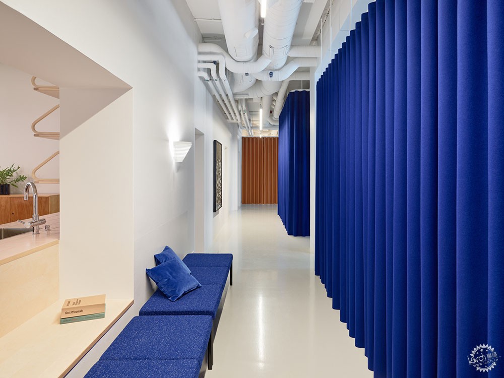

当一个人失去某种感官感受时,其他感官就会变得敏锐,因此,色彩、光影、震动都能够帮助听力丧失人群更好地感受周围的环境变化。在当前高度视觉文化中,人们常常忘记空间的体验其实包含了所有的感官,那么来源于上世纪50年代的多感设计,就是通过感官来享受整个空间,开放多感官体验,满足不同的使用者。直至现在位置,多感空间的设计策略应用在了许多艺术装置之中,而这些装置也展示了多感空间在建筑领域对于人们的吸引力。
Multisensory spaces
They say that when a person loses a sense, others become more acute. Colors, shadows, and even vibrations can help people with hearing limitations better understand or be alert to their surroundings. In a highly visual culture, we tend to forget that the experience of space encompasses all the senses. Multisensory design, rooted in the 1950s, proposes an enjoyment of space that occurs through the senses, demonstrating that by opening up to multi-sensory experience it is possible to satisfy a wider range of users. Until now, tactics for multi-sensory design have been most heavily explored in art exhibitions and installations, though these examples demonstrate their potential to reach a broader audience in the field of architecture.

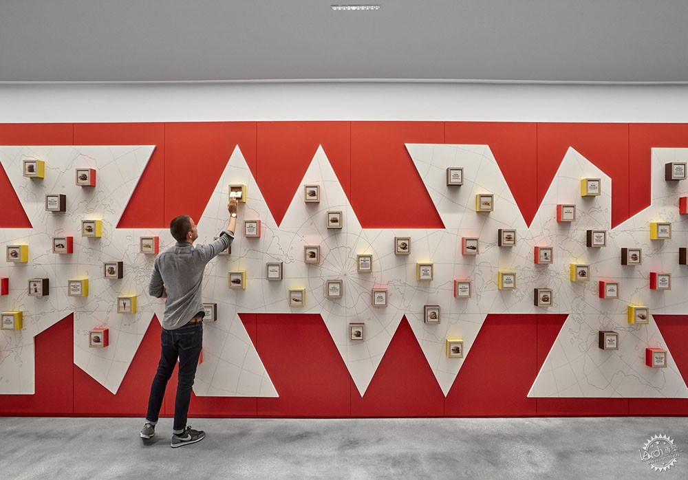

与人们的认知相反的是,噪音不仅会让人们的听力受损,它也是低听力水平人群的健康关键因素。无论低听力水平的等级如何,此类人群能够以高度分散的方式来感知声音,尤其是针对使用辅助设备的人。声波造成的混响和坚硬表面的反射能够造成分散,这会让人感到痛苦。那么为了改善室内环境就需要遵循基本的声学远离,识别周围材质的吸收水平、正确分散噪音或扬声器的声源、根据空间的使用来考虑噪音梯度,都能够有效地降低混响程度。
Acoustic optimization
Contrary to popular belief, noise - in addition to being a serious cause of hearing loss - is a critical factor in the well-being of people with low hearing levels. Regardless of grade, people with low hearing levels do perceive sound in ways that can be highly distracting, especially for individuals with assistive devices. Reverberation caused by sound waves and reflected by hard surfaces can be distracting and even painful for them. To improve these indoor conditions, following basic acoustic principles is sufficient. Improving the acoustics of indoor spaces consists mainly of reducing reverberation by recognizing the absorption level of surrounding materials, correctly distributing noise or sound sources such as machines or speakers, and considering an ambient noise gradient according to the use of each space.
