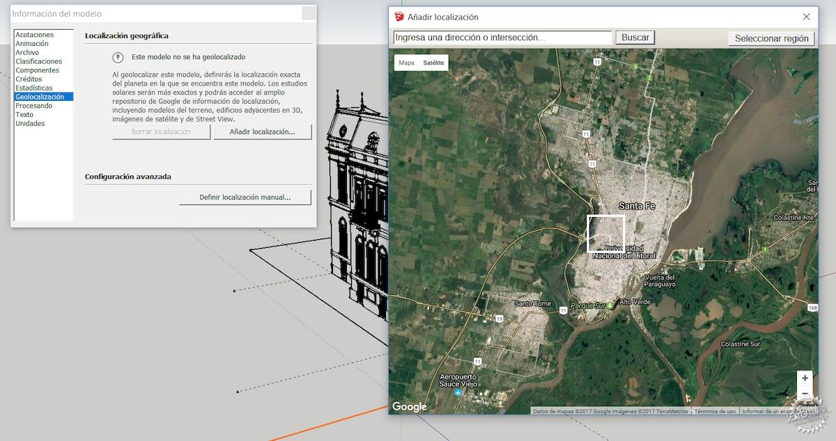

2. 地质定位
SketchUp让您能够对模型进行地理定位,即窗口>模型信息>地理定位>添加位置/定义位置手动访问模型(Window> Model Information>Geolocation>Add location/ Define location manually)。这一点在项目的概念阶段尤其重要。此外,随着项目从一个位置移动到另一个位置,项目所投出的阴影也会有所不同。
2. Geo-locate
Sketchup allows you to geolocate your model – accessible from Window> Model Information>Geolocation>Add location/ Define location manually. This is especially important as the conceptualization of a project requires the reallocation. Moreover, the shadows cast by the project varies as you move the project from one location to another.

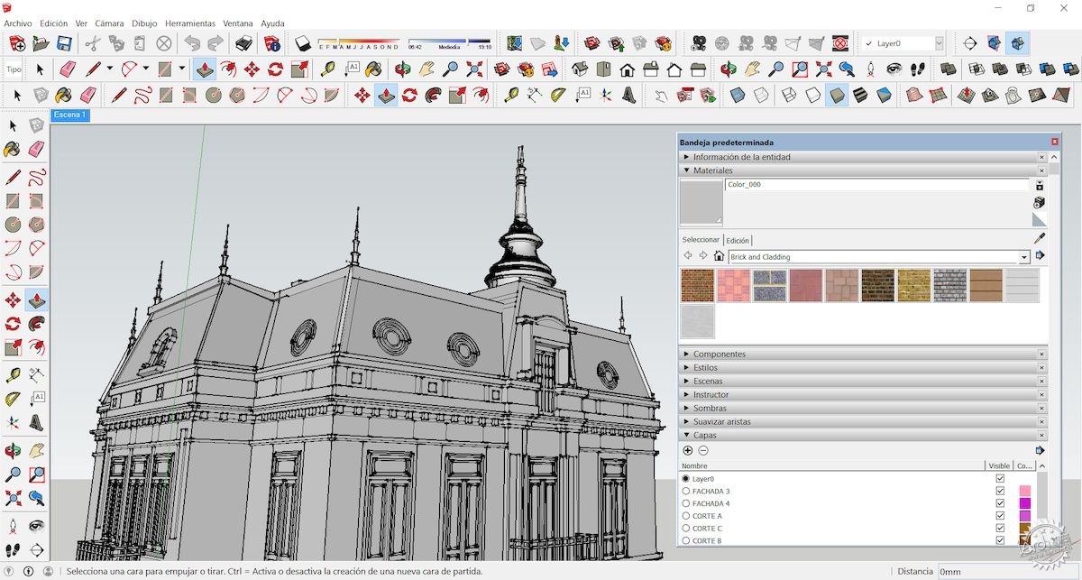

4. 自定义工具栏
根据您的需要和偏好定制的工作环境将帮助您有效地完成工作。组织工具栏需要相当长的时间,但它对您的工作有很大帮助。最终的结果需要花时间去完成,因为它为您提供了更好的设计和细节环境。

4. Customize your Toolbar
A work environment customized to your needs and preferences will help you execute tasks efficiently.  It takes a considerable amount of time to organize your toolbar, but it helps out a lot. The end result is worth the time is taken as it offers you a better environment to design and detail.

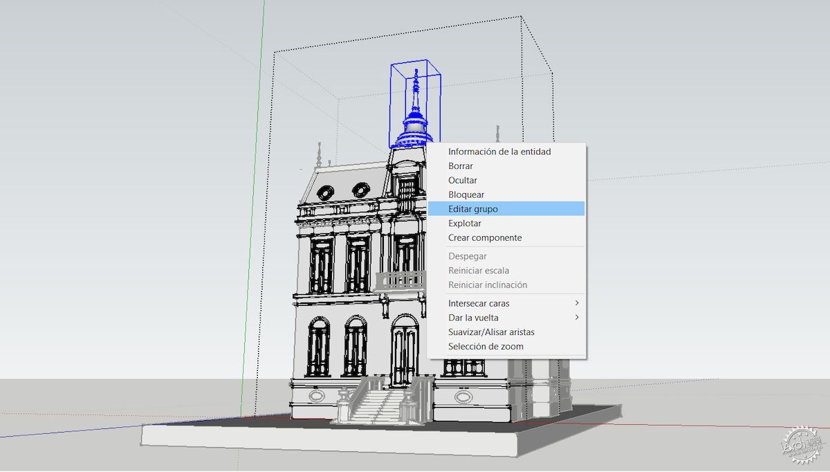

5. 建组
如果要在模型建成之后对模型进行修改,那么使用组件非常有益。您可以将模型的部分组成组件,这让您可以对模型进行部分修改,而不影响附加在模型上的表面和线条。单击表面/线条/图形,右击>创建组(surfaces/lines/figures, right-click>create a group)。双击组件就可以方便地进行编辑。
5. Group It
Using a group is extremely beneficial if you have to make changes to your model later in time. Organizing parts of the model into groups allows you to alter one part of your model without affecting the faces and lines attached to it. Click on the surfaces/lines/figures, right-click>create a group. Double-click the group to easily edit it.

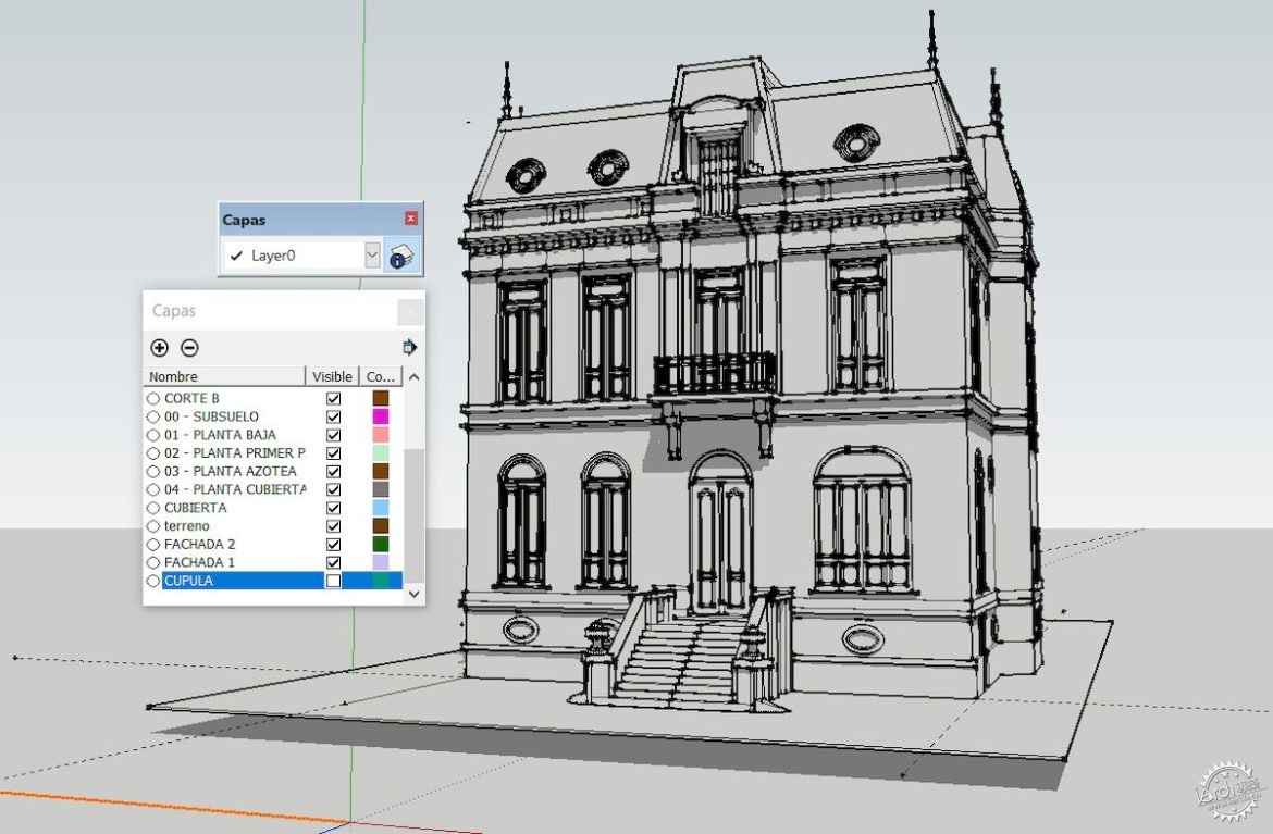

6. 层——但不要太多
使用图层来顺利地进行工作。如果您要将其他模型或cad文件导入到SketchUp中,可能会有无数新层形成,如果您删除任何一层,请小心它们可能来自cad文件或其他模型。隐藏未使用的层(windows>Layers)能有效地隐藏当前未使用的模型部分。
6. Layers – but not too many
Use layers to perform work smoothly. If you are importing other models or CAD files into SketchUp, there might be innumerable new layers added from them. If you choose to delete any layers, be careful – they might be from the CAD file or other models. Hide the layers you are not using (Windows>Layers) to hide the parts of the model you are not currently using.

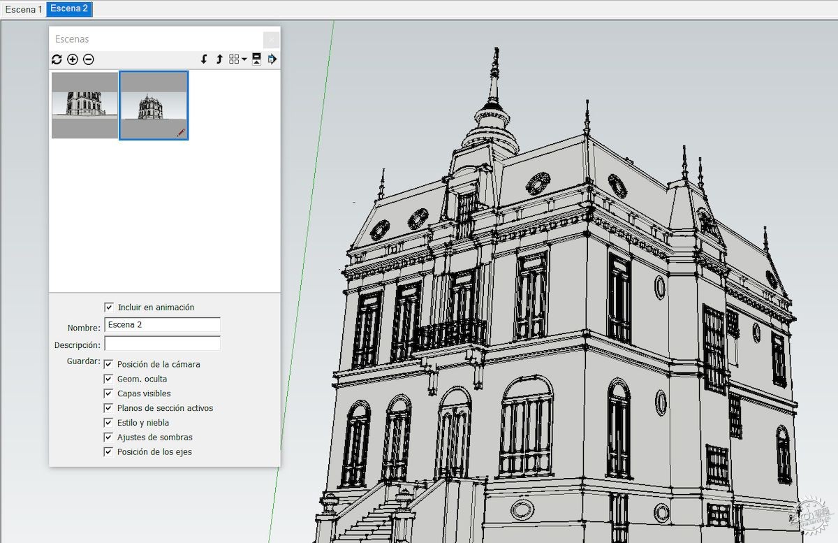

10. 场景管理器
场景管理器(Windows>Scene)允许您创建不同的镜头角度或场景。这些将有助于沟通、理解项目。这是非常有用的工具,能够控制相机相对于地面的高度。此外,如果您正在为一个特定的房间设计不同的内部布局,您可以添加场景到场景管理库,形成固定的视角。同样,它也可以用于项目的外部外观。
10. Scene Manager
Scene manager (Windows>Scene) allows you to create different camera angles or scenes. These help in communicating, understanding and animating the project. It is a useful precision tool to control the height of the camera in relation to the ground.
Moreover, adding a scene to the scene manager allows you to have one viewpoint if you are presenting different interior layout options for one particular room. Similarly, it can be used for exterior facades of a project.
