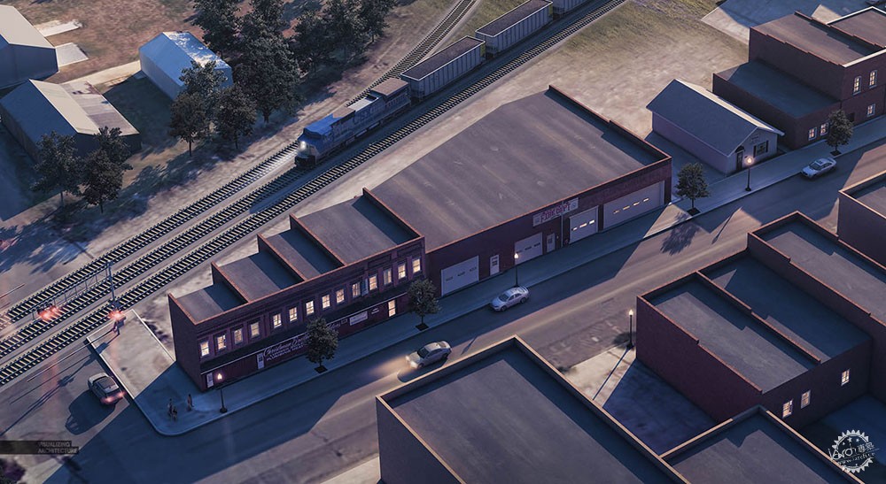

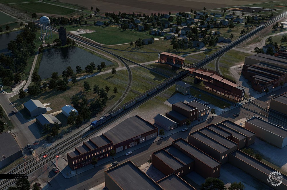

火车站鸟瞰图制作/ Alex Hogrefe第7张图片
火车站鸟瞰图制作/ Alex Hogrefe第8张图片
火车站鸟瞰图制作/ Alex Hogrefe第9张图片
火车站鸟瞰图制作/ Alex Hogrefe第10张图片
最后需要注意的几点,我是根据折叠后对图片影响最小来选择视角的。尽管这张图片是鸟瞰图,而且所有的细节都非常小,但是我还是需要确保我图中设计的所有重要的信息不会在折叠后消失。另外,我渲染的所有东西都采用了高分辨率(高于平常的6,500 px宽),所以读者可以近距离地看到这些细节。因而,我们的PS文件有3.5GB之大,所以在我的笔记本上不太容易操作。
Some final notes, I chose the view based on where the fold of the spread would have minimal impact. Since the image is an aerial and all of the detail is so small, I had to make sure the view was designed in such a way that none of the important information was getting lost in the fold. I also rendered everything at a higher resolution than normal (6,500 px wide) so that the detail remains sharp as viewers get close to the page. This meant a very large Photoshop file of over 3.5 GBs though still easily manageable on my laptop.
