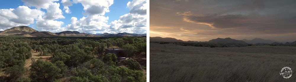

该地区的生物多样性是更大的Madrean群岛的一部分,从索诺兰沙漠延伸到奇瓦瓦沙漠。亚利桑那州南部部分地区、新墨西哥南部、远西德克萨斯部分地区和天空岛山脉作为广阔沙漠风光里生命和居民的灯塔。它们是链条中的环节,这个链条连接墨西哥马德雷山脉北端,它们是当地生命故事中必不可少的。项目形式上用作迁移部落、鸟类和食肉动物的庇护所和资源库,帮助它们穿过广阔的空地。

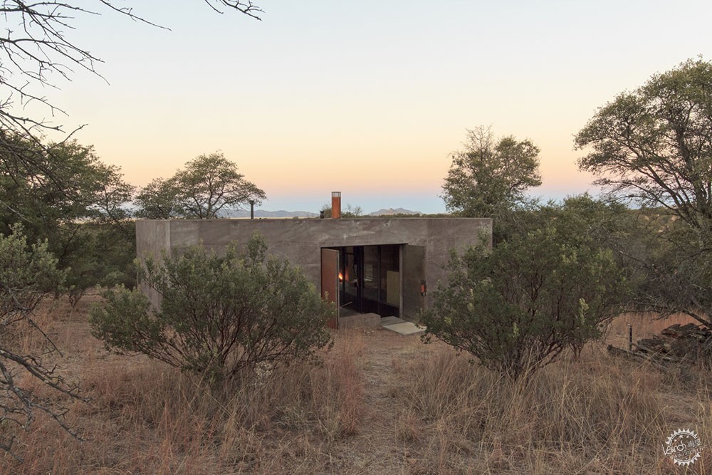

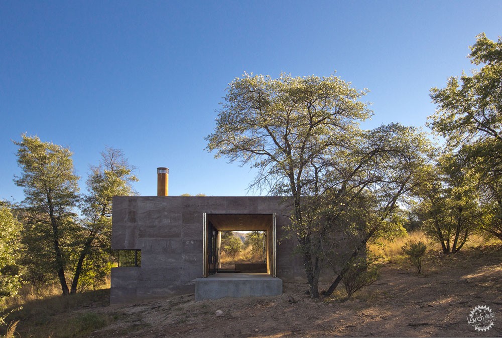

Casa Caldera房屋正是从这种历史和环境中发展。这个小小庇护所受到气候条件的强烈影响,适应自然、社会、政治和经济环境。每个都有自己的不同加权度。项目位于美国和墨西哥之间的国际边界以北15英里。
It is this history and context that Casa Caldera grows from.   This small shelter is strongly informed by the climatic conditions; adapting to the natural, social, political, and economical environments.  Each to its own weighted and varying degree.   It is located 15 miles north of the international border between U.S. and Mexico.

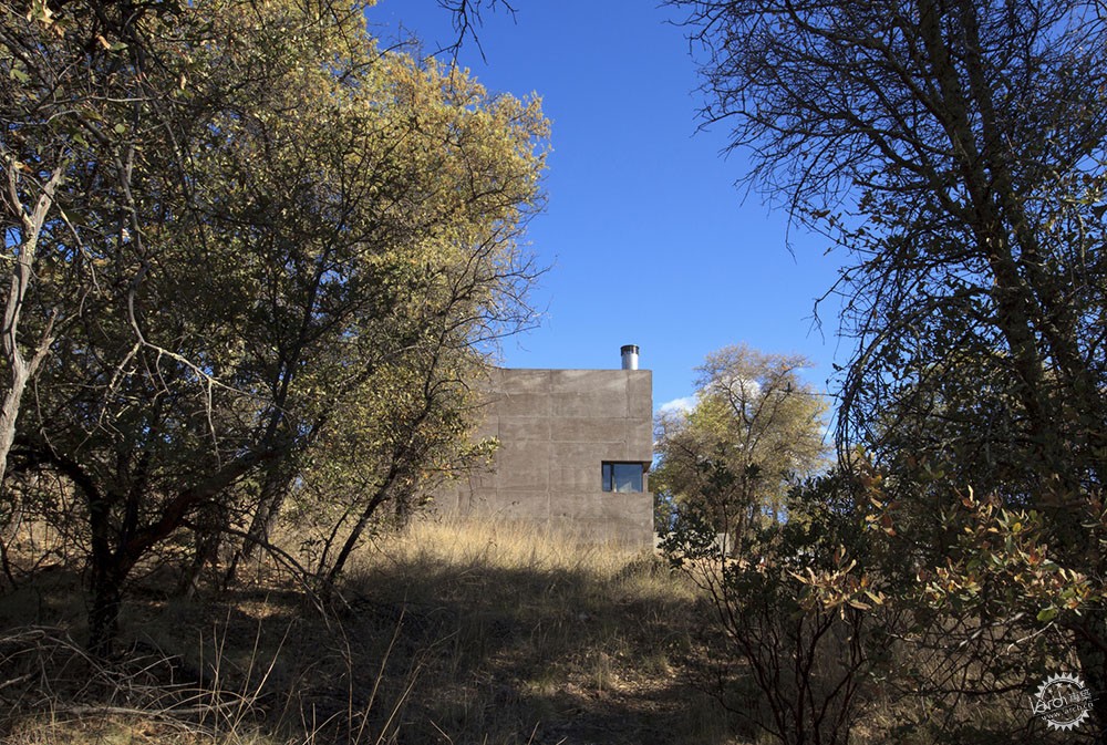

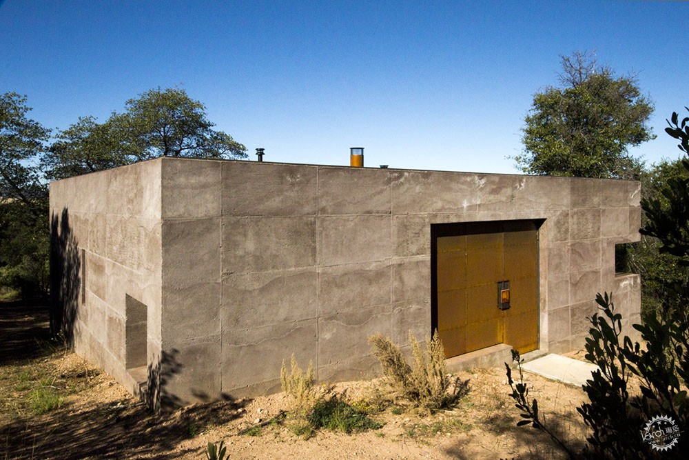

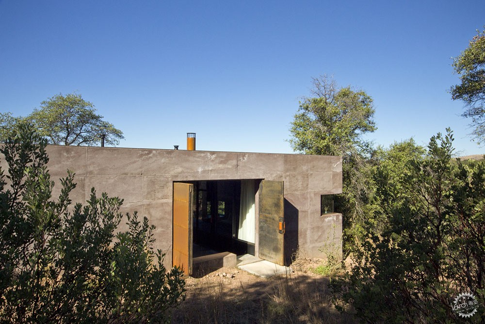

房屋从地面升起,用火山渣建成简单的矩形。原始材料和火山渣选为主要的建筑材料,并参考山谷的地质形成、场地及其附近土壤和岩石的颜色,和谐地与景观融合。火山渣墙由多孔、重量轻的红色火山岩集料建成,经过混合形成自支撑的半流体,被夯入模板,这类似夯土。
The house rises from the ground in a simple rectangular form made of Scoria. The material, Scoria, selected as the main building material in reference the Valleys Geologic formation and the color of earth and stone on and near the site, blends harmoniously with the landscape. Scoria walls are made from a porous, lightweight red volcanic aggregate which is mixed to form a self- supporting semi-fluid and rammed into formwork similar to the process of rammed earth.

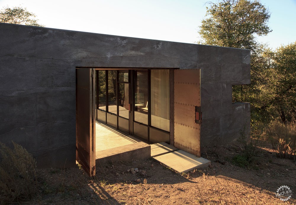

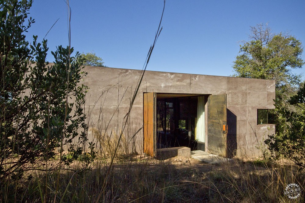

客户要求有户外生活区和睡眠区,这促使建筑师重新发现当地住宅规划的一种原型,它也用作Casa Caldera房屋的主要组织概念 —— 门廊。
The clients request of having outdoor living and sleeping zones lead to the re-discovery of a local vernacular house planning typology that was used as the main organizing concept of Casa Caldera – a Zaguan.

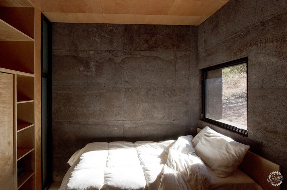

Casa Calderas房屋的可居空间880平方英尺,分为3个小的矩形区,其中居住空间265平方英尺,265平方英尺的睡眠/洗浴空间被中央门廊一分为二,主要的户外生活空间270平方英尺,带有一个80平方英尺的朝西中庭。房屋占地面积1060平方英尺。山下有个100平方英尺的偏僻独立露台,项目总面积1160平方英尺。
Casa Calderas livable space of 880 sq. ft. is broken into 3 small rectangular zones; 265 sq. ft. of living space, and 265 sq. ft. of sleeping/bathing space which are bisected by a central Zaguan, the main outdoor living space (270 sq. ft.) with a patio to the west (80 sq. ft.). The footprint of the house covers 1060 sq. ft. with a remote isolated patio down the hill of (100 sq ft.) (Total project sq. ft. 1160)

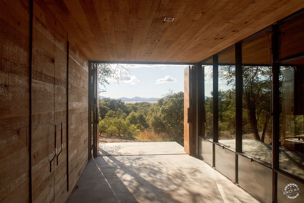

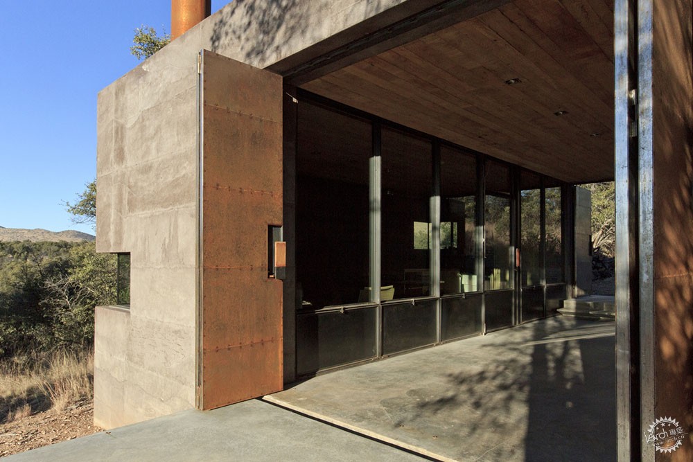

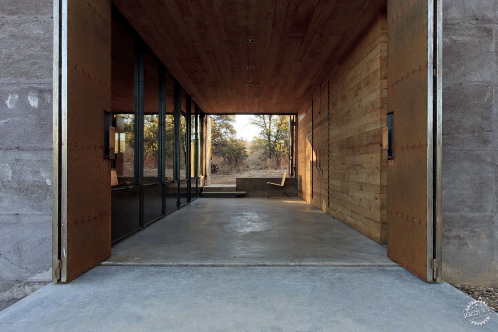

大型金属双折门在门廊两端,将有顶的生活空间连接到远处的景观。向东,门廊敞开像全尺寸的透视画,向西,景色延伸到圣拉斐尔山谷和巴塔哥尼亚山脉的远处。双折门提供自然光,打开时利用被动降温的微风,关闭时保障安全。门能以多种方式安装,随着季节、用途和生活方式的变化业主可自由使用,使用双折门控制太阳能的光照量,或以不同方式利用微风。当温度合适时,门廊是受保护的遮盖空间,可用于休息、餐饮和睡眠。
Large bifolding metal doors on either end of the Zaguan connect the covered living space to the landscape beyond. To the east the Zaguan opens up like a full scale diorama and to the west the story book view stretches to the distant landscape across San Rafael Valley and the Patagonia Mountains. The bi-folding doors deliver natural light and harness passive cooling breezes when open and security when closed. The doors can be configured in a myriad of ways, as seasons, use, and lifestyle requires the owner to interact and respond, using the bi-folding doors to control the solar gain or harness the breezes in different ways. When the temperatures are appropriate the Zaguan is a protected covered space used for lounging, dining and sleeping.

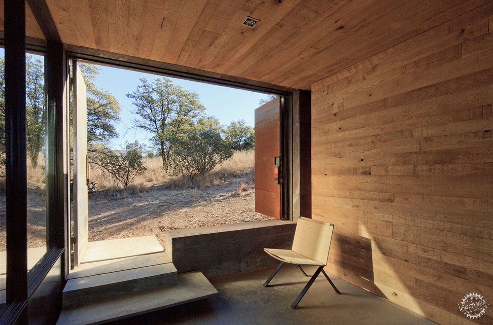

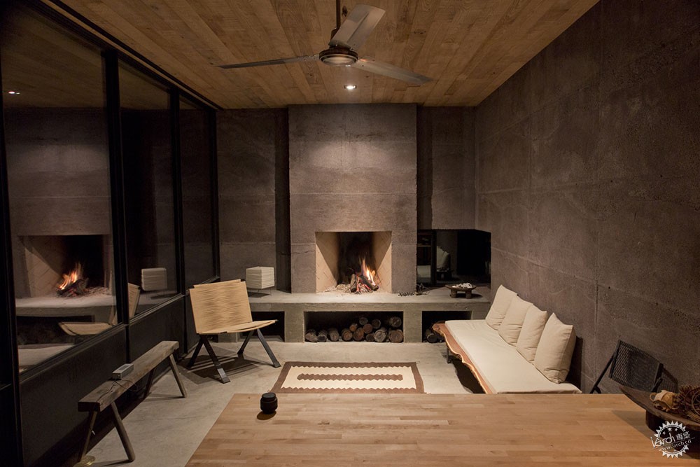

门廊作为空间提供了难得的体验,人们能在这里放慢脚步或逗留,并以独特的集中视野简单领略自然环境,在自然中感受时间的流逝。唯一的热源是烧柴炉和壁炉。根据经验,在冬天醒来时想到的第一件事就是火。亚利桑那州橡树燃烧的气味在记忆中进一步强调了房屋的体验属性。降温是通过18”厚火山渣墙壁的热量传递和空气自然流动来实现的,空气因两侧的正负压力而穿过门廊。外窗的布置仔细考虑了太阳方位,保持小尺寸使夏天的直射太阳得热最小。
The Zaguan as a space offers the rare experience where one can slow down or stop altogether,  and simply take in the natural environment in a single focused view and physically witness time passing.The only sources of heat are a wood burning stove and fireplace.  Experientially, in the winter, the first thing one thinks of when they wake is fire.  The smell of the Arizona Emory oaks burning further distinguishes the experiential nature of the house in the memory of scent. Cooling is achieved through the thermal offset of 18” thick scoria walls and the natural flow of air that moves through the Zaguan due to the positive and negative pressures on either side. Solar orientation was carefully considered in the placement of exterior windows, which were kept small to minimize direct solar heat gain in the summer.

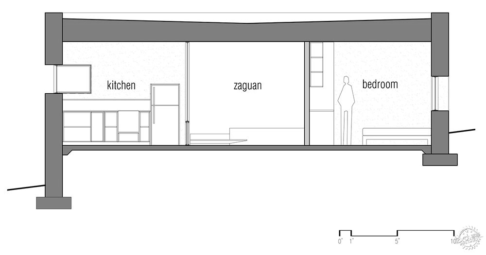

Section/截面图
所有窗户都是可操作的,还有客厅窗户墙的踢脚线和横梁、卧室入口、槽窗也可操作,槽窗利用空气,将空气引出门廊,穿过生活区和睡眠区。通往睡眠区的通道另外增加了一扇门,当两者都打开时,小的烧柴炉还能给门廊空间供暖,需要时用于宴会和小聚会。这种可操作性进一步吸引业主积极参与房屋的各种体验。
现有水井为房屋供水,一个小型太阳能电力系统位于远离房屋的地方,提供基本的用电。房屋使用最少的照明设备,所有都是低压LED。做饭、水暖和制冷都是由丙烷气提供能量。
All of the windows are operable, as well as the kicks and transoms of the living room window wall, bedroom entry and slot windows that harness and pull air out of the Zaguan and through the living and sleeping zones. An extra door was added to the access to the sleeping zone, so that when both are open, the small wood burning stove can also heat the Zaguan space for dinner parties and small gatherings when desired. This operability further engages the owner as an active participant in the experience of the house.
An existing well provides water for the house, and a small solar electrical system sits away from the house to provide for basic electrical power use. Minimal lighting is used, all low voltage LED. Cooking, water heating and refrigeration are all powered by propane gas.

Casa Caldera房屋几乎完全定制。火山渣墙、钢窗、门、五金、皮革拉手、木墙板、木工、精细家具和框架都由DUST事务所制作和安装。天花板和门廊墙壁所用木材是回收的黄樟木。Casa Caldera房屋完全没有格栅。在Caldera房屋的建造中,只产生了三十码的废物,只利用了一次材料装卸。
Casa Caldera is almost entirely custom built. The scoria walls, steel windows, doors, hardware, leather pulls, wood siding, millwork, casework and framing were all fabricated and installed by DUST. The wood that is used on the ceiling and Zaguan walls is reclaimed sassafrass. Casa Caldera is entirely off grid.
