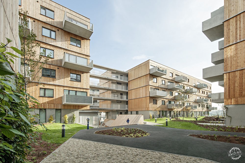

来自建筑事务所的描述。一系列在规模上有所差异的平行建筑体量利用了Seestadt Aspern东南部分的D12地块。住区一共有213栋公寓和8间商店,由一组清晰可识别的形式细长、紧凑的单体体块组成。
Text description provided by the architects. A sequence of parallel building volumes differentiated in terms of scale utilises the large building plot D12 in the south-eastern part of the Seestadt Aspern. The complex with a total of 213 apartments and eight shops apparently consists of a group of clearly recognisable individual timber houses in the form of slender, compact individual volumes.

交错的布局创造了不同的庭院状的空间和多种视觉联系。
The staggered layout creates different kinds of courtyard-like spaces and a variety of visual relationships.
