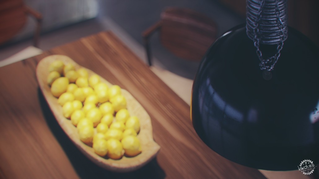

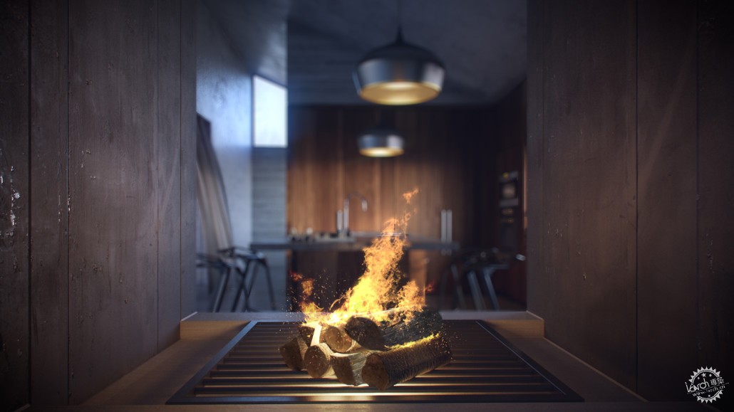

这一组有9张图:
Hello!
I grew up in a place where comfort zone seems to be everywhere I go. I’ve previously struggled with the balance between profit and non-profit driven projects, especially considering the initial mindset when starting a project. At this moment I do like to think that I’m in the right place in terms of convincing myself not to look at the money first because that way I would be able to put in 100% of passion into projects.
This is a project I’ve done with the company I’m currently attached with, Vizorium. The initial idea was to create a short animation, but due to the commitments and deadlines I’ve only managed to complete the still images stage.
Thank you Ronen for featuring this project!
Here are the 9 Images in this set :

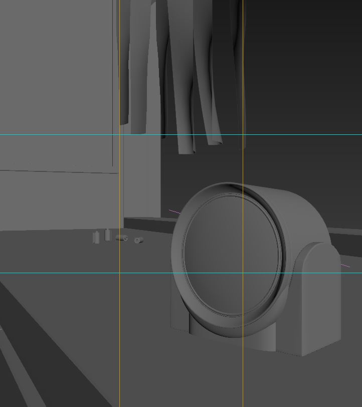

我也学习使用视窗安全框架设置,下图是“三分法”的代表,它在元素构成中起到了作用。

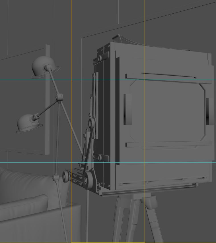

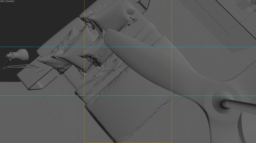

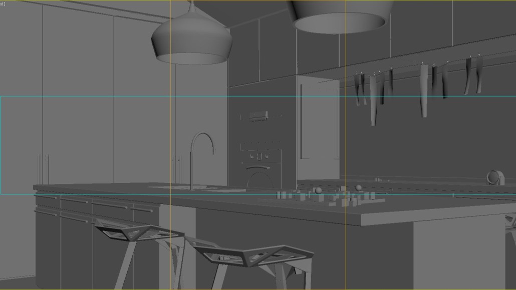

I was given the basic 3D SketchUp model by our client. It wasn’t that detailed and most of them have double stacked objects. Some details are added while working with the compositions and below are the viewport screenshots for all the cameras and some non-included views.
I’ve also learnt to use the viewport safe frame setting as below to represent “Rule of Third”‘s so it helps during composition.
制作简单室内第13张图片
它们建立的框架
And the frames as they were setup

所有的模型都是用曲线和传统盒子建立的。因为这里我还没有添加很多分支,所以不会谈论很多建模。一些模型如老式照相机是我的同事制作的。

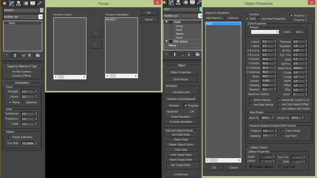

窗帘使用了一个简单的风模拟,主要用于胶卷条。
All models are built mainly with splines and typical boxes. I try not to talk a lot about the modeling since there isn’t much I can add in that department. Some of the models like the vintage camera are courtesy of a colleague of mine.
A simple wind simulation was used for the curtains and mainly for the Film strips.
制作简单室内第26张图片
关于随机胶片方向,我只是使每一个的风力不同。
For random film orientation I would just differ the amount of wind strength for each of them.

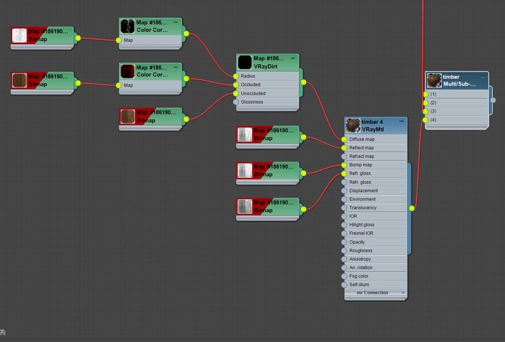

Timber Walnut/核桃木材质

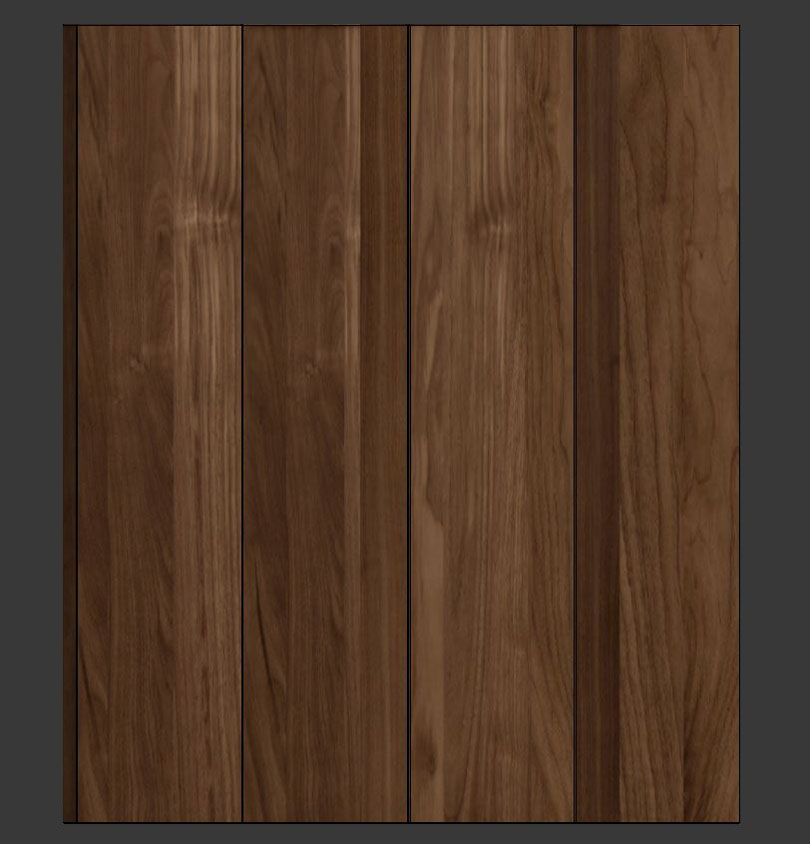

为了避免重复,我使用多重/次物体材质作为组件创建了四个不同的核桃木材质。
In order to avoid repetition I’ve created four different walnut materials using the Multi/Sub-object as the Parent.

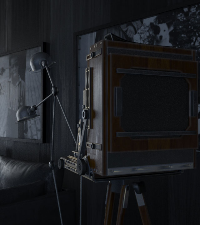

我的想法是努力获得简单抽象但是有力的效果和感觉。场景使用带有HDRI的传统V-Ray半球灯点亮。关于HDRI,我更喜欢Peter Guthrie – PGSKIES。
The lighting process is the part I enjoy doing the most!
The idea was to try to achieve a minimalist yet powerful overall look & feel. The scene was illuminated using the typical V-Ray Dome Light with an HDRI. When it comes to HDRI’s I prefer the trusty ones by Peter Guthrie – PGSKIES.
制作简单室内第36张图片
制作简单室内第37张图片
我处理照明的方法是首先关注阴影,而不是“点亮场景”。
下图是其中一个例子:
The way I do lighting is usually to focus on the shadow first instead of “Lighting up the Scene”.
Below is one of the examples :

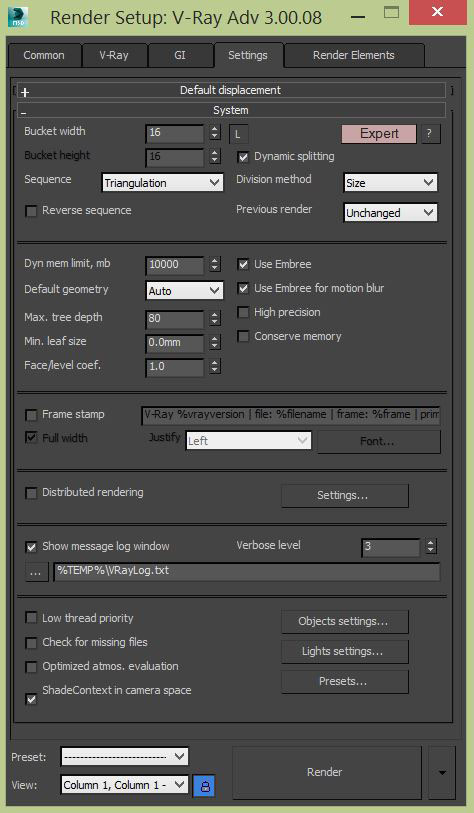

我使用了Brute force + Light cache,每一次渲染在一台电脑上花费5-7小时。我使用的PC是i7,内存为2GB,显卡为GTX 760。
最初,我想在相机中渲染DOF,但是由于噪音量,我会通过高分辨率来补偿。我决定用使DOF,从而避免更长的渲染时间。
其中一个场景的渲染设置样例:

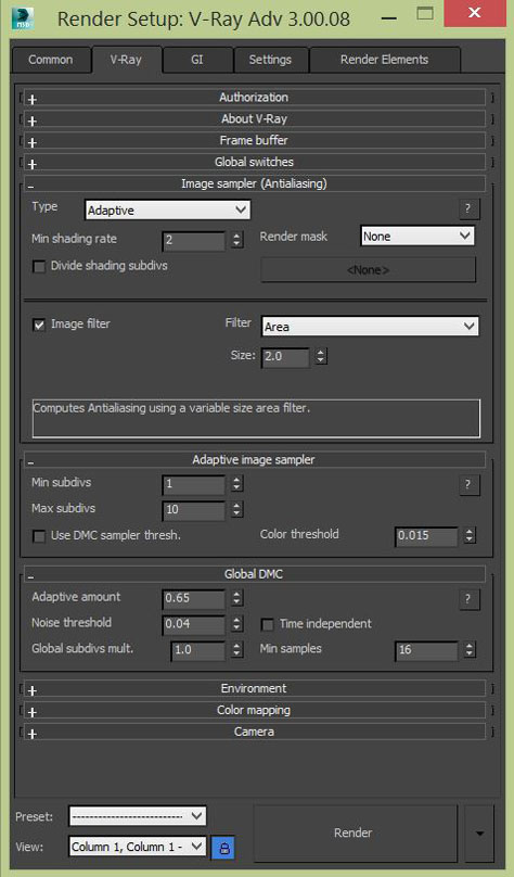

I’ve used Brute force + Light cache and each render took around 5-7 hours on one computer. The pc I’m using is as an i7 with 32GB RAM packing a GTX 760.
Initially, I wanted to render the DOF in Camera, but due to the amount of noise forcing to compensate in terms of higher subdivs, I decided to go with postwork DOF to avoid longer render times.
One of the scene’s sample render settings :

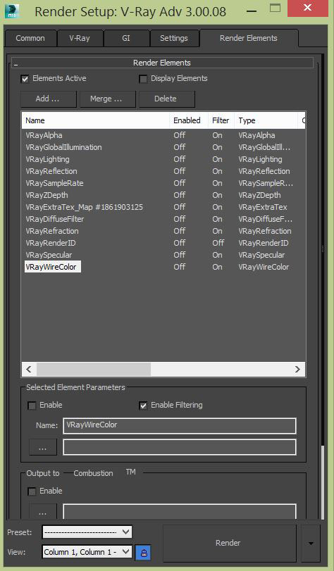

我使用到的渲染元素非常常见,但是我喜欢其中的V-Ray Sample Rate,它让我对渲染场景背后的V-Ray有了一个全新的了解。
The render elements I’ve used are pretty much the common ones but I’m in love with one particular pass which is the V-Ray Sample Rate which gives you a whole new understanding towards V-Ray goings behind the scenes of the render.
