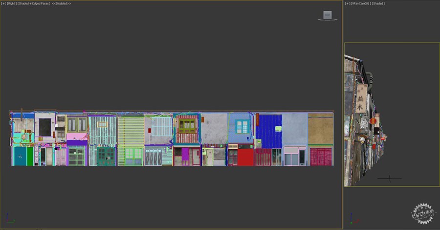

在这个场景中有17个建筑。我在3dsmax中进行建模。有一些侵蚀的细节需要利用ZBrush笔刷,具体你们可以参考下面这张图片。
Prior to the model in detail, I would like to share with you an experience which seems everyone knows. All the sharp edges in this 3d model have a “chamfer” on them. It helps with picking up the important highlights on edges we do see in real life. Making everything to be more believable.
I always keep in mind that, to be truthful, even the furthest part of the 3d model, needs this level of detail. You can decide to cover it with fog later if need be. Just have the detail built in for when you need it. That’s just how I trained myself (and today with 360’s becoming more popular as well as VR it will make your scenes more ready for it).
There are 17 buildings in the scene. I modeled them in 3dsmax. There are erosion details demanding the use of ZBrush. You can see this in the image below.

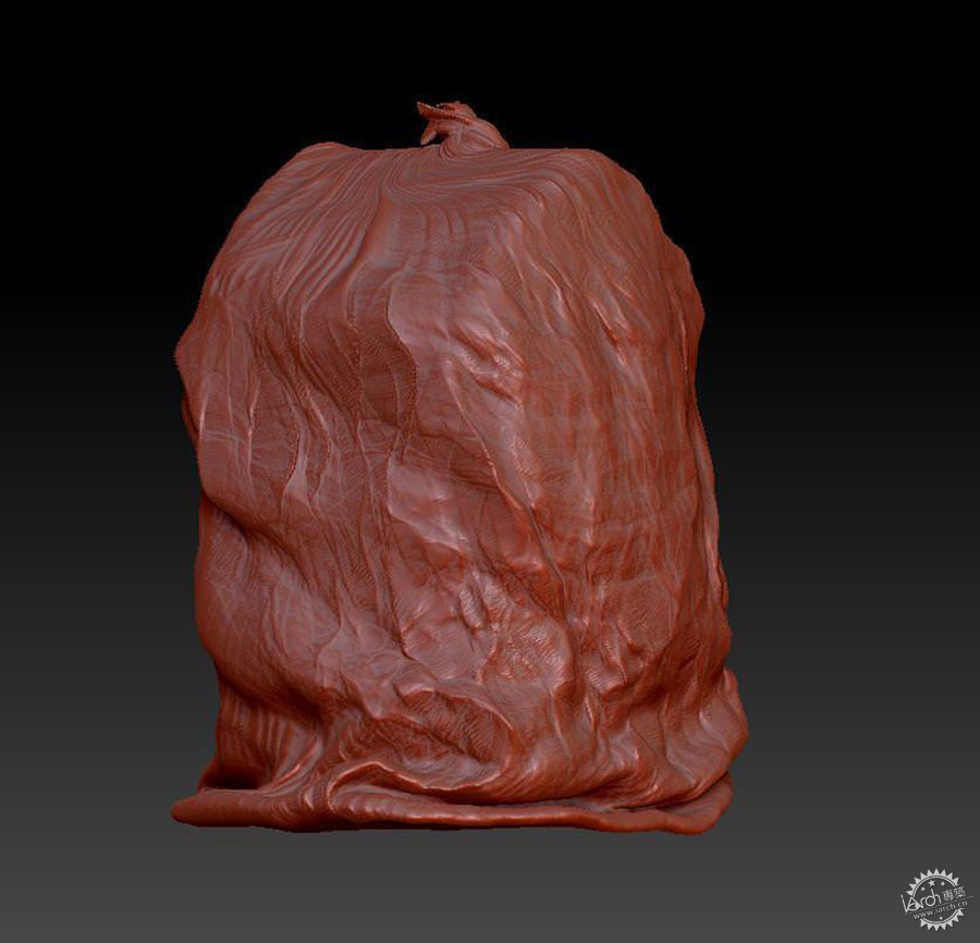

然后利用ZBrush增加褶皱细节。
And added sculptural details in ZBrush.
制作“晚归(东京2007)”效果图第17张图片
