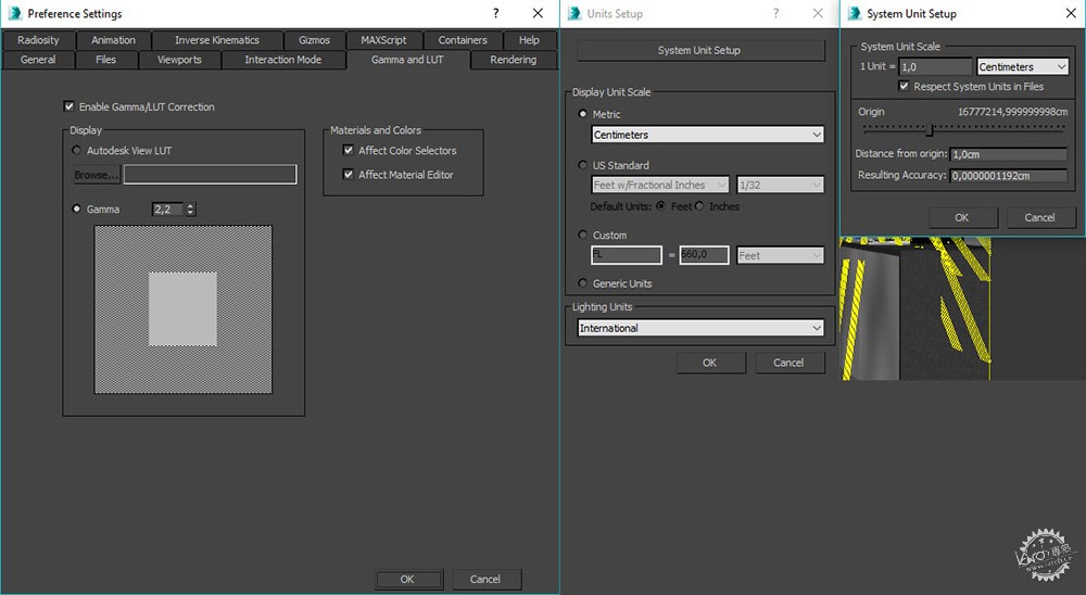

在Corona渲染中的Gamma 设置与在V-Ray中是相同的。
我使用的设置单位是厘米。它们对我来说是运用最普遍的两个外部和内部渲染器。
The Scene Setup
Gamma settings in Corona Renderer are the same as in V-Ray.
Units setup that I’m using is centimeters. They are for me the most universal to both exteriors render and interiors render.

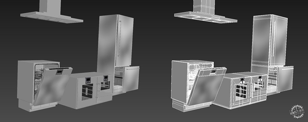

还有一些模型的集合:
And some of the collection models too :

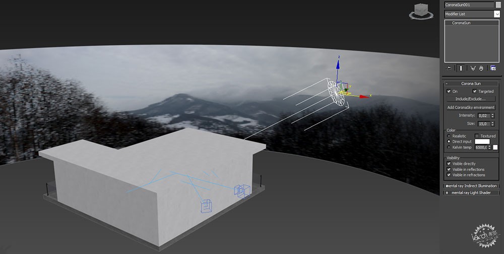

Lighting
Here also, I took a very simple approach which Corona really allows you to do and get great results with.
I only used Corona light : Corona Sun and Corona Sky as well as Corona Light for the ventilation hood lighting.
•        The Corona Sun is slightly blurred and fragile so that it fits with the hazy, cloudy background behind the window.
•        The Corona Sky is tweaked so that little blue light enters through the windows.
•        The light coming out of the hood is warm.
Corona 阳光设置/Corona Sun Setting

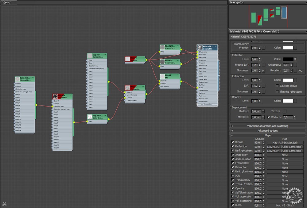

材质
材质的运用都是很简单的,就不多作展示了。
我喜欢凹凸贴图的形式。一个正常的贴图会提供更好的结果,我用bitmap2material创造我正常的贴图。
我选择了一些重要的元素进行展示:地毯,灰色橱柜,地板和墙壁。
Materials
Shaders are very simple and there aren’t many to be shown.
I prefer normal map for bump maps. A Normal Map gives better results, and I use Bitmap2Material to create my Norml Maps.
I chose a few important ones which you can see below : the carpet, gray cabinets, floor and walls.

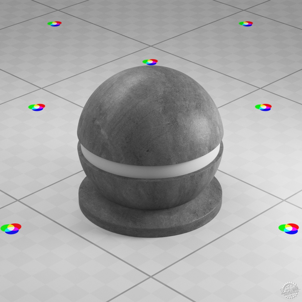

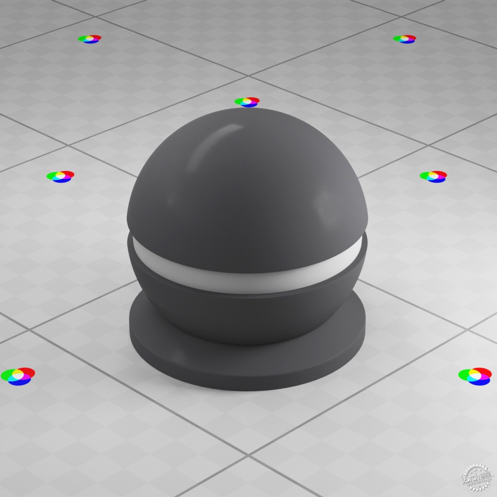

地毯材质/Carpet Shader
用Corona渲染器制作厨房效果图第16张图片
用Corona渲染器制作厨房效果图第17张图片
灰色橱柜材质/Gray Cabinets Shader
用Corona渲染器制作厨房效果图第18张图片
用Corona渲染器制作厨房效果图第19张图片

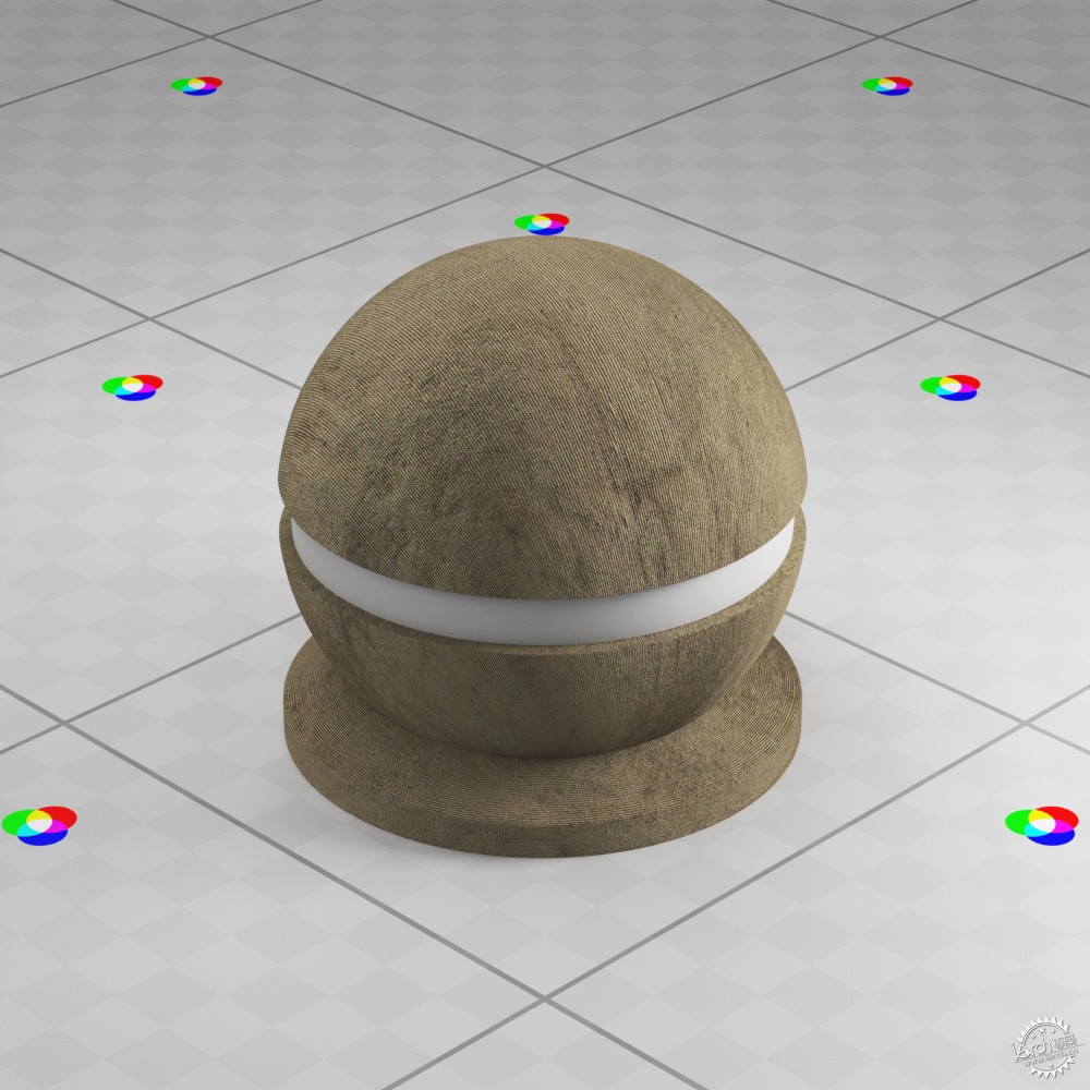

地板材质/Floor Shader
用Corona渲染器制作厨房效果图第20张图片
用Corona渲染器制作厨房效果图第21张图片
墙材质/Wall Shader
用Corona渲染器制作厨房效果图第22张图片
用Corona渲染器制作厨房效果图第23张图片

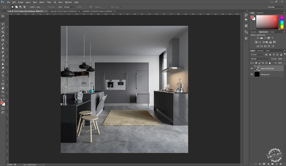

下一步是在PS的相机设置中建立32位源文件。
这一步在PS CC中并不能实现。
这是经过相机设置后的图像:
Next step is post-production 32-bit file in Camera Raw in Photoshop.
You can do it in Adobe Photoshop CC.
Image after Camera Raw :
