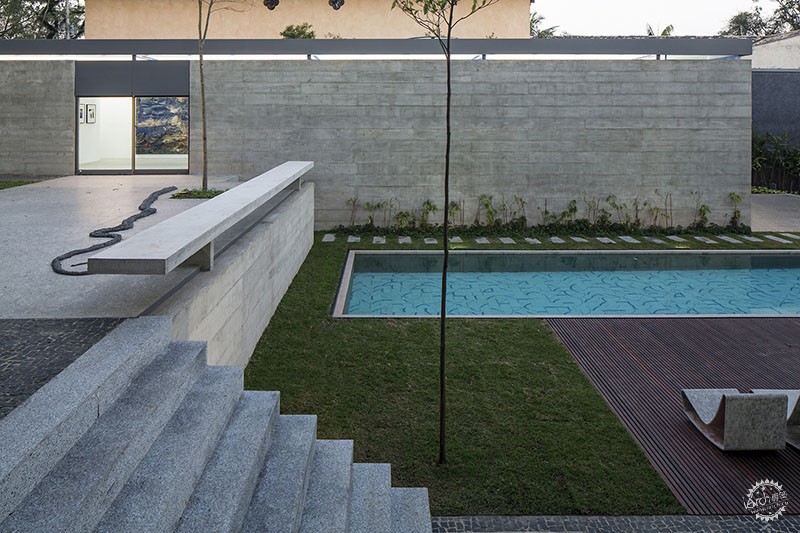

Casa Concreto / Grupo MM. Image © Iván Casillas
将其作为清水元素
混凝土其实就是“物美价廉”的代名词,因为这种材料并不需要额外的衬托,但是,它仍然需要一定程度的维护,尤其是当混凝土直接暴露于空气之中的时候。因此在设计时,应当一开始就考虑天气及当地气候因素,另外也可以考虑一些混合物的制作,因为这样会形成最优化的工作成果,以及形成一些小孔隙材料。
Consider its Level of Exposure to the Elements
It's true that concrete is synonymous with "economic" since the structure doesn't require any additional lining. However, a certain degree of care is essential in undergoing the process, especially since your concrete will be directly exposed to all kinds of weather. It's fundamental that you consider these weather factors from the very beginning and the impact that they will have on your finished product. Furthermore, it's necessary to specify the composition of the mix that you will use, allowing for optimal workability and minimal pores and crevices in the structure.

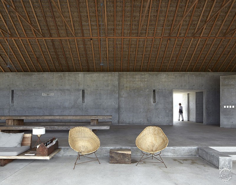

Centro Roberto Garza Sada / Tadao Ando. Image Cortesia de Agencia EFE
为了防止污染物的感染,在使用混凝土之前应该先经过灭菌杀毒的过程。而细部的设计在整体结构中也同样重要,例如在檐口中,工人可以通过防潮来防止日后出现的各种问题。
特殊处理的树脂和清漆
因为混凝土是多孔材料,因此需要结合特殊处理的树脂、清漆,以及防水材料,这样才能够防止材料被腐蚀。而市面上有许多的材料可以进行选择,同时,设计时也可以咨询专业人员。因为有的材料可能对某种混凝土并没有多大作用,而有的材料却有可能增加其亮度或增加其强度,有些清漆和树脂具有防水性能,另外的密封胶则能有效防止酸雨等其他有害物质的腐蚀。
In the case of possible leakage and/or mold infestations and other pathogens, the preemptive use of fungicides, anti-bacterials, and sealants are indispensable. The design details will also play a part in the structure's defense against the elements. For example, the use of eaves prevents humidity and the various problems that it causes.
Specify the Resin and Varnish
Because concrete is a porous material, it's important to be specific about the resin, varnish, and water-proofing that you will use to protect your work against the wear of time and harsh bactericides. There are many different products available for your specific needs, and enlisting the help of a technical consultant can be invaluable for an optimal result. Some products have little to no effect on concrete once they are applied while others can add brightness or intensify its tonality. Certain varnishes and resins only protect against water damage, while other sealants protect against acid rain, other corrosive agents in the air, and mold.

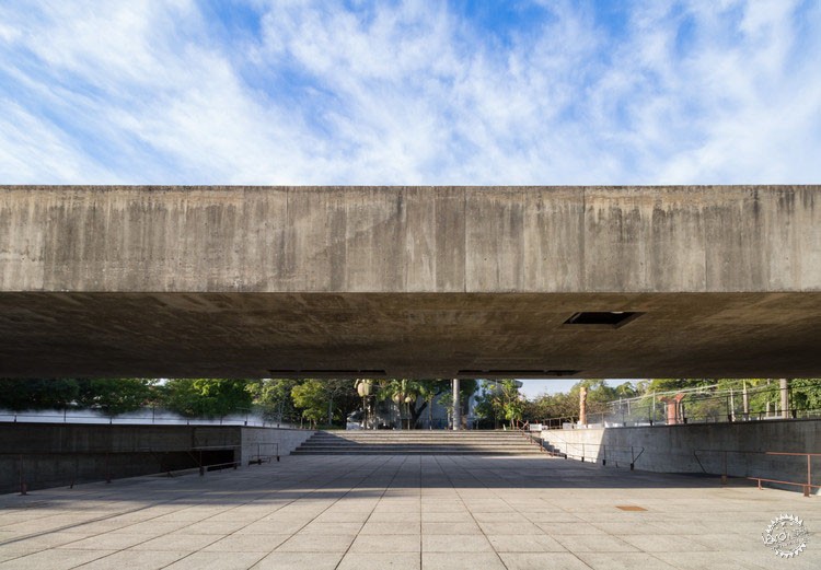

MUBE / Paulo Mendes da Rocha. Image © FLAGRANTE
保护金属构件
一般来说,如果直接让金属构件直接暴露在空气当中或者与水直接接触,会导致这些构件的生锈或严重损坏,因此在设计时除了结构计算预先确定的尺寸外,可以考虑添加混凝土层,或者通过混凝土制作模具,来达到保护金属构件的作用。
Protect the Metalwork
Never allow the structure's metal and ironwork to be exposed as contact with water and other outside elements can cause seriously compromise the structure. It is recommended that, along with the dimensions predetermined by the structural calculations, you consider an additional layer of concrete over the structure to prevent water and mold from reaching the metalwork.
