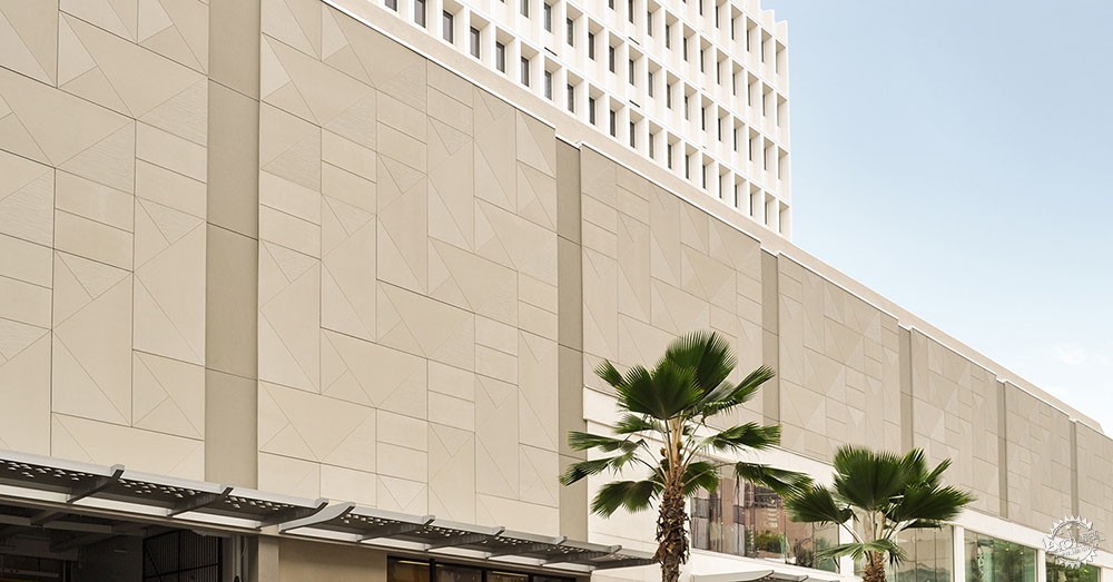

TAKTL's ultra-high-performance concrete panels on the Waikiki Business Plaza by MGA Architecture. Image © TAKTL
数千年来,混凝土一直是建筑师和施工者的首选材料,其最早的使用甚至可以追溯到公元前6000年的叙利亚与约旦,混凝土有着成本低、功能多、应用快等特点,人们也对其较为熟悉,大约每年的混凝土浇筑量为220亿吨。BBC的一项研究表明,自从1950年之后,混凝土的产量增长了30倍,而自从1990年之后,这个数值又增长了4倍,部分原因则来源于欧洲战后的建筑发展热潮,以及上世纪90年代之后亚洲的建筑发展。根据专业人士预测,到了2030年,混凝土的产量也许会增加25%。
Concrete has been a material of choice for architects and builders for thousands of years, with the earliest known use dating from Syria and Jordan in 6000BC. Its low cost, versatility, fast application, and sheer familiarity to those involved in using it means that roughly 22 billion tons of concrete are poured every year. According to a recent BBC study, production of cement has increased thirtyfold since 1950, and a further fourfold since 1990, driven in part by postwar building in Europe, and building booms across Asia from the 1990s onwards. It is predicted that to keep pace with demands in South East Asia and sub-Saharan Africa, cement production may have to increase by 25% by 2030.

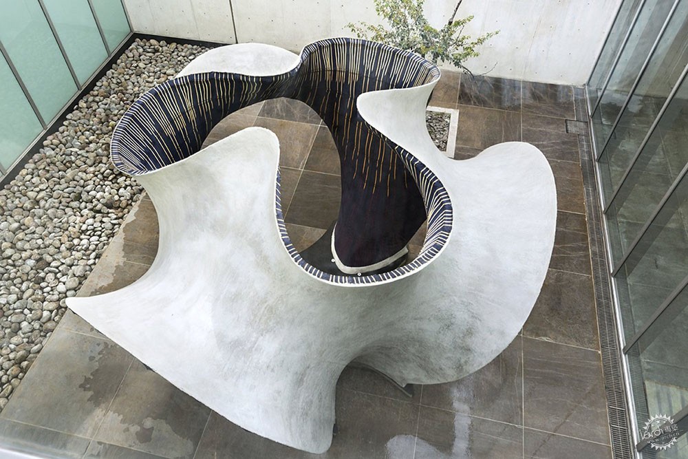

扎哈建筑事务所除了在施工过程中应用了玻璃纤维混凝土之外,建筑师们还展示了一种更加新颖的混凝土应用策略,即墨西哥城艺术博物馆的3D编织贝壳,KnitCandela通过创新的混凝土贝壳结构技术,表达了对西班牙籍墨西哥建筑师兼工程师Felix Candela的敬意,该技术结合了创新的KnitCrete框架技术,而这也构成了扎哈在拉丁美洲的首个展览。电缆网和织物模板系统的编织时间大约为36小时,这也使得自由混凝土表面能够在不需要模具的前提下构成具有表现力的形式。苏黎世联邦理工大学的研究者开发了针织物件,装运在两个箱子中从墨西哥运往瑞士,其长度一共为350 公里,重25公斤。展馆的面积大约为50平方米,其轻薄的双曲混凝土外壳总重量只有5吨。
在扎哈的展览中,苏黎世理工大学的KnitCrete技术起到了重要的作用,该技术在混凝土创新发展历程中也名列前茅。苏黎世理工大学建筑学的研究者们希望能够最大化地利用空间,避免建筑成本的增加,因此设计了厚度为2厘米的混凝土面板,不仅满足承重的需求,同时满足可持续的发展目的。相较于传统的混凝土楼板,这些面板构成拱形,用于承担主要的荷载,这也让人们联想起哥特教堂中的拱形天花板,因此在不需要钢筋的前提下,二氧化碳的产生会更小一些,而厚度为2厘米的面板也比普通混凝土面板的重量要减轻70%。
As well as embracing GFRC in the construction process, Zaha Hadid Architects has also exhibited a more novel approach to concrete, having unveiled a 3D-knitted shell at the Museo Universitario Arte Contemporaneo in Mexico City. Forming part of ZHA’s first exhibition in Latin America, KnitCandela “pays homage to the Spanish-Mexican architect and engineer Felix Candela” by reimagining his inventive concrete shell structures through an innovative KnitCrete formwork technology. With a knitting time of 36 hours, the cable-net and fabric formwork system allows for expressive, freeform concrete surfaces to be constructed without the need for molds. The knitted fabric for KnitCandela, developed at ETH Zurich, was transported from Mexico to Switzerland in two checked suitcases, totaling 350 kilometers of yarn weighing 25 kilograms. The pavilion’s thin, double-curved concrete shells hence weigh only 5 tonnes in total, despite a surface area of 50 square meters.

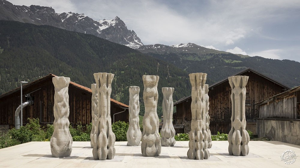

近期,该机构还展示了3D打印混凝土的发展潜力,瑞士Riom的“Concrete Choreography”装置展示了第一个3D打印混凝土舞台,其中包含有无模板支柱。该装置由瑞士Riom的Origen Festival合作完成,有着9根高度为2.7米的支柱,这些支柱通过定制的软件来进行设计,并应用苏黎世理工学院开发的机器3D打印过程进行制作。打印出的空心混凝土结构使得材料的策略性更强,同时也满足了混凝土建筑的可持续发展。另外,经过计算设计的材料装饰和表面肌理都展示了3D混凝土打印技术在大型建筑中的多功能特征和美学潜力。

More recently, the institution has also showcased the potential of 3D printed concrete. The “Concrete Choreography” installation at Riom, Switzerland, presented the first robotically 3D printed concrete stage, consisting of columns fabricated without formwork. In collaboration with the Origen Festival in Riom, Switzerland, the installation features nine 2.7-meter-tall columns, individually designed with custom software and fabricated with a new robotic 3D printing process developed by ETH Zurich with the support of NCCR DFAB. The hollow concrete structures are printed to allow materials to be strategically used, allowing for a more sustainable approach to concrete architecture. In addition, the computationally-designed material ornament and surface texture exemplify the versatility and significant aesthetic potential 3D concrete printing holds when used in large scale structures.
