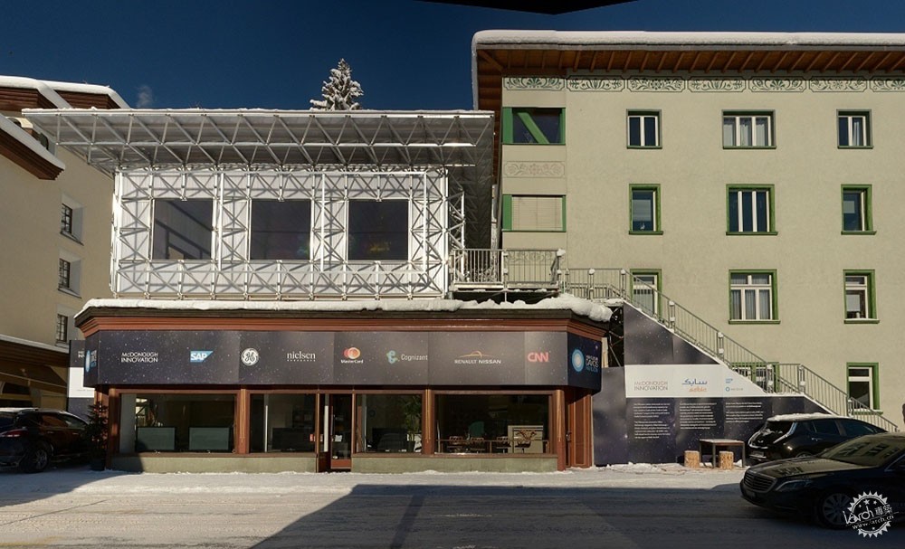

关于未来建筑材料再利用的思考讨论第2张图片
Image © Clément Guillaume
从定义上看,拆解设计是指对建筑进行设计,以适应未来部分或整体的变化和拆除,从而回收系统、部件和材料,并且确保建筑在全寿命周期内能够尽可能有效地循环利用。该方法的基础是人们越来越认识到,大多数建筑的寿命是有限的,每座建筑都是资源的储存地,这些资源与其最终被送往垃圾填埋场,不如重新回到"减少、再利用、再循环"的流程中去。因此,"设计促进发展"涉及了解结构的完整生命周期,并为其各部分的再利用作出规定,以减少资源消耗和污染。
What is Design to Disassembly?
By definition, Design for Disassembly is the design of buildings to facilitate future changes and dismantlement (in part or whole) for recovery of systems, components and materials, thus ensuring the building can be recycled as efficiently as possible at the end of its lifespan. The strategy builds on an increasing acknowledgment of the fact that the majority of the built environment has a limited lifespan and that every building represents a depository of resources, which, rather than ending up in a landfill, should find their way back into the "reduce, reuse, recycle" loop. As such, DfD involves understanding the structure's complete life-cycle and making provisions for the reuse of its parts, in order to reduce both the consumption of resources and pollution.

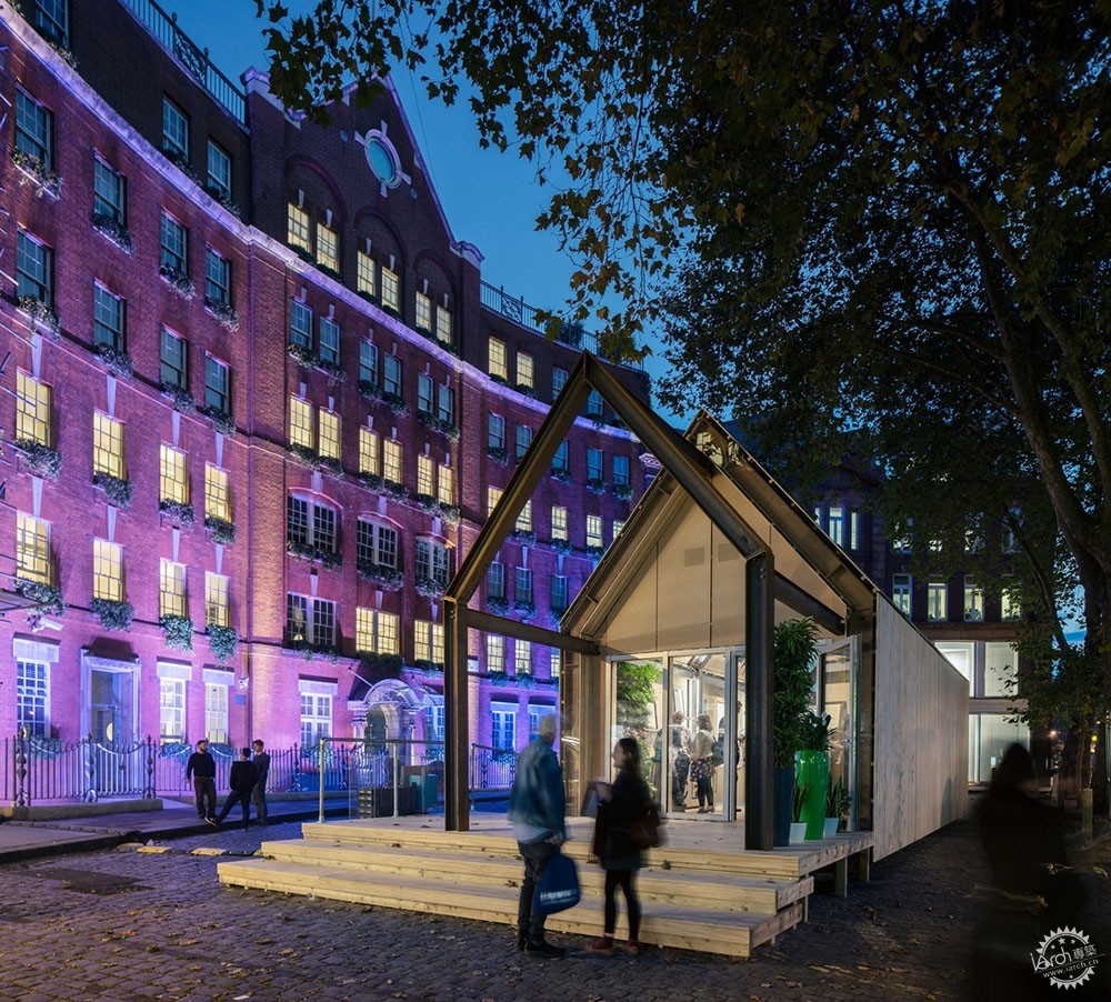

关于未来建筑材料再利用的思考讨论第3张图片
Image Courtesy of William McDonough + Partners
这个概念最初定义于20世纪90年代,是一个相对较新的概念,因此很少有项目在设计时考虑到拆解的问题,更少有项目对该方法的结果进行测试。尽管如此,这种趋势变得愈发主流,其中一个例子是新的伦敦规划,相关条例要求规划申请证明建筑部件如何拆卸和再利用。此外,欧盟项目"建筑材料库"(BAMB)和美国环保署(EPA)都为这一设计过程制定了指导方针,而一些可持续发展认证也为拆解设计加分。
First defined in the 1990s, the concept is relatively new, therefore few projects have been designed with disassembly in mind, and even fewer have tested out the outcome of the strategy. Nonetheless, this pursuit is now making its way into mainstream practice, one such example being the new London Plan, which will require planning applications to demonstrate how the building components can be disassembled and reused. Furthermore, both the EU project Buildings as Material Banks (BAMB) and EPA (the United States Environmental Protection Agency) have drawn out guidelines for this design process, while several sustainability certifications award points for the design for deconstruction.

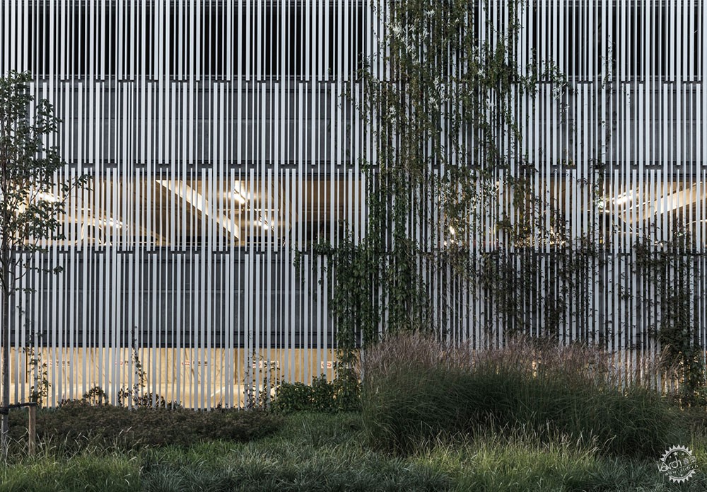

关于未来建筑材料再利用的思考讨论第4张图片
Image © Simon Kennedy
建筑业是世界上最大的原材料消耗者,而其中大多数材料并不会进行循环利用,将DfD战略纳入建筑过程将减少建筑业的能源消耗和碳排放,因为它将大大减少第一次使用材料的消耗。然而,设计发展的过程也充满挑战。缺乏对回收材料的监管,以及废旧材料质量和数量的不确定性,仍然是阻碍"设计拆解"方法的因素。目前,另一个重大的挑战是这一过程的成本和速度,因为拆除被认为比逐个拆开建筑更经济高效。然而,环保局的研究表明,如果有足够的可回收材料和良好的市场价值,抵消较高的劳动力成本,那么拆解再利用在成本上可以与拆迁相媲美。
Opportunities and Challenges
The construction industry is the world's largest consumer of raw materials, and most of them never return to the material loop. Incorporating the DfD strategy into the architectural process would reduce the embodied energy and carbon emissions of the construction sector, as it would significantly curtail the consumption of first-use materials. Nonetheless, the DfD process is not without its challenges. The lack of regulation regarding recycled materials and the uncertainty around the quality and quantity of used materials are still disincentives to the DfD method. Another significant challenge, for the time being, is the cost and speed of the process, as demolition is considered cheaper and faster than taking a construction apart piece by piece. However, research by EPA demonstrated that deconstruction could be cost-competitive with demolition if there are sufficient recoverable materials with a good market value to offset the higher labour costs.

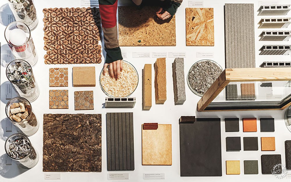

评估材料
关于未来建筑材料再利用的思考讨论第7张图片
Image © Rasmus Hjortshøj
拆解设计需要对建筑材料进行广泛的研究,以选择无毒、高质量(经得起组装和拆卸)和具有良好回收潜力的材料。在选择材料的过程中,围绕着这样的问题:一个部件在其寿命周期结束后会发生什么?如何重复使用,或者是否可以退回给供应商?有一些软件可以通过生成特定输入材料的生命周期评估(LCA)来帮助判断。
Assessing Materials
Design for Disassembly requires extensive research into construction materials for selecting the ones that are non-toxic, of high quality (to withstand assembly and disassembly) and have good recycling potential. The process of choosing materials within this design method revolves around questions such as: what happens to a component at the end of its life? How can it be reused, or could it be returned to the supplier? There is software that could help make this evaluation, by generating Life Cycle Assessment (LCA) of specific input materials.

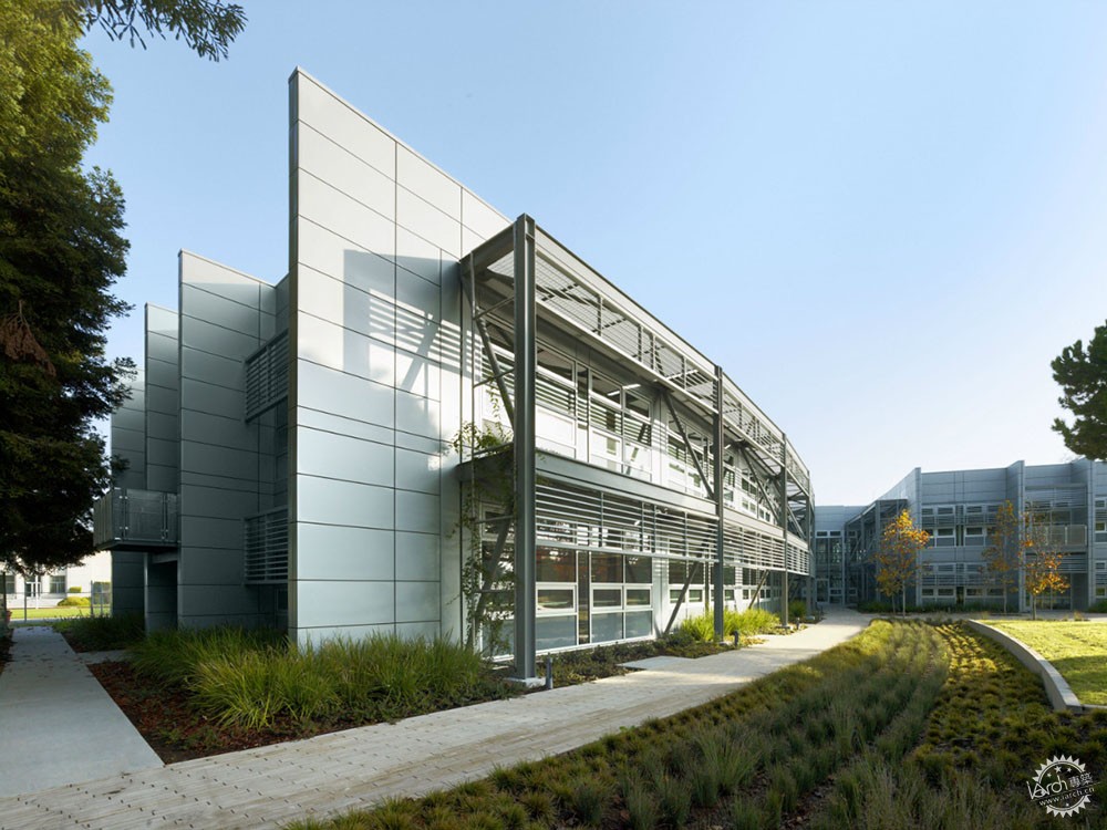

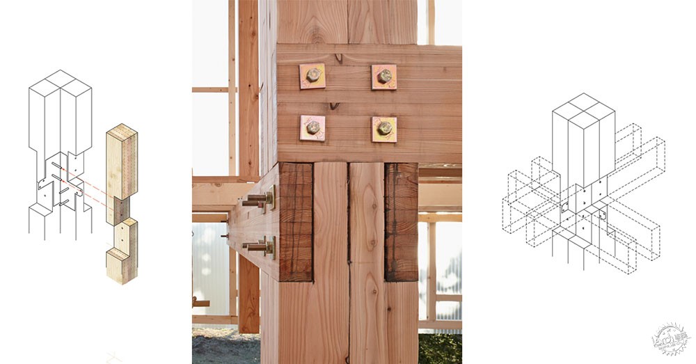

选择连接细节
关于未来建筑材料再利用的思考讨论第8张图片
Image © Shinkenchiku Sha
“设计发展”的一项基本原则是建立无障碍连接,并选择适当的连接方式,以方便拆卸,避免使用重型设备或过多的工具。重点应放在机械连接上,使用螺栓、螺丝或钉子连接,而不是使用不可拆卸的化学连接,如粘结剂、密封剂、胶水或焊接,这样会使材料难以分离和回收。
Choosing Connection Details
One fundamental principle of DfD is creating accessible connections and choosing the appropriate joinery in order to ease dismantlement and avoid the use of heavy equipment, or too many tools. The focus should be on mechanical joinery, using bolted, screwed or nailed connections, as opposed to non-removable, chemical ones such as binders, sealers, glues or welding, which would make the material difficult to separate and recycle.

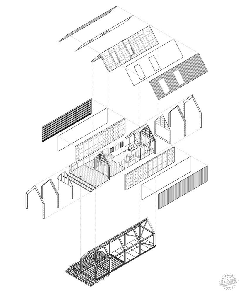

适应性设计
关于未来建筑材料再利用的思考讨论第9张图片
虽然"拆解设计"是建筑的寿命终结,但这种方法似乎是延长建筑使用期限的绝佳策略。因此,将不同的建筑系统分离开来,降低对整体建筑的破坏性,为未来的改造创造了更大的机会。MEP系统就是这样,其寿命比建筑内其他系统的寿命要短得多,DfD可以使有选择地拆除特定元素变得更加容易,从而减少浪费。在装配和部件的设计过程中,倾向于模块化和标准化,也有利于重复使用。
Designing for Adaptability
Although Design for Disassembly focuses on the life end of a building, the method seems to be an excellent strategy for extending a construction's use. Thus, separating different building systems and making their replacement less disruptive to the overall building creates a greater opportunity for future renovations. This could be the case of MEP systems, whose lifespan is much shorter than that of other systems within the building and where DfD could make the selective removal of specific elements much easier, resulting in less waste. Favouring modularity and standardization in the design process of assemblies and components also facilitates reuse.
