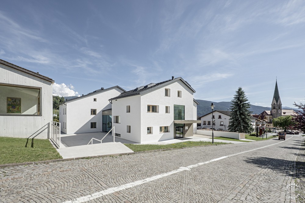

小学外立面的粗糙石膏与幼儿园的混凝土立面相互交错。原始建筑的倾斜地形创造了独特的建筑环境。
在欧美地区,学校与邻近的体育馆、音乐馆、展览场地相互连接,从而增强了各个基础设施与村中心的联系。
The rough plaster of the outer facade interplays with the exposed concrete facade of the kindergarten. The sloping terrain in which the original building stands creates interesting special situations at varying levels.
To the West, the school is connected to the adjoining gym, the music pavilion, and the fairground and thereby enhance the link to the village center.

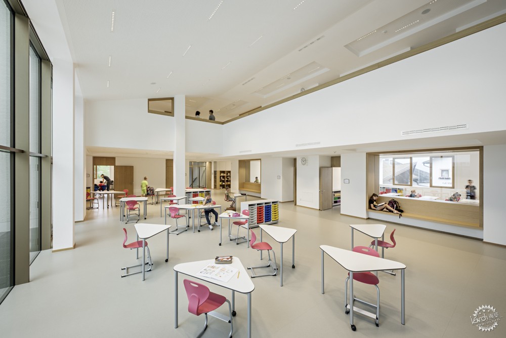

在较高楼层,建筑师通过学校大厅的通高设计实现了空间氛围的连接。观景廊将二楼的房间与建筑物的中央空间相连。原来的空间变成了一个具有开阔景观视野的教学区,这个教学区与教室、其他辅助房间、中央衣帽间、员工休息室和厕所组合在一起。
In the upper floors, a connected atmosphere is achieved via the high-ceilinged design of the school hall. A viewing gallery joins the rooms on the second floor with the central space of the building. The original circulation is transformed into a learning landscape, around which classrooms, additional rooms, the central cloakroom, the staff room and the toilets are grouped.

学生通过宽敞的玻璃窗能够看到窗外赏心悦目的群山美景。每个教室都有一个用于储物的小空间,并且也为学校大厅提供额外的座位区域。这些新的开口将以前的小空间转变成一个大的整体。这样,学生们甚至可以到户外完成学习任务。
Spacious glazing to the outside as well as between the school hall and classrooms ensure exciting visual connections as well as views of the surrounding mountains. Each classroom is assigned a window niche, which offers sufficient storage space and provides additional seating for the school hall. These new openings transform the previously small spaces into a large whole. In this way, different places of learning also develop outside the classroom.
