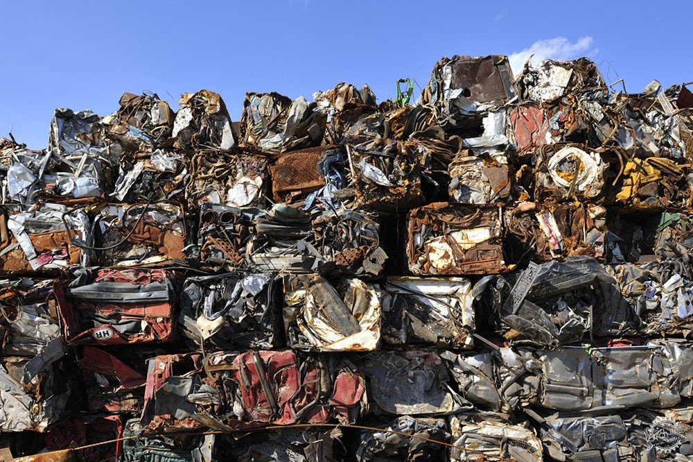

金属回收厂|Metal Recycling Plant / dekleva gregoric architects. Image © Miran Kambič
钢材由铁矿石和煤高温炼制而成,也可以通过回收废弃钢材在电炉中制作而成。钢材的回收历史可以追溯到古罗马时期,当时士兵们会收集战场上所留下来的武器,然后炼成新兵器。其实,钢材可以不断地进行转化,在回收之后,电力的消耗能够降低80%,对环境的影响也更小一些,因此可以不需要完全依赖于原材料的提炼。
Steel
Steel can be made from the combination of iron ore and coal, which is heated in a blast furnace, or by recycling scrap, which is made in an electric furnace. The recycling of steel goes back to the Roman Empire, when soldiers collected instruments of war left in trenches to produce new weapons. In fact, steel can be endlessly transformed into new objects without loss of quality. When recycled, the consumption of electricity lowers by 80%, causing a lower environmental impact and eliminating completely the extraction of raw materials.
