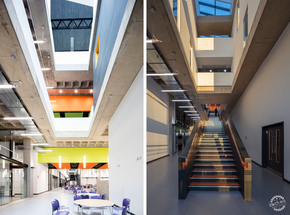

这样的布局让建筑师们能够通过现有的楼板结构来插入使用垂直空腔,并且增加了屋顶灯具,让室内中央也能具有亮光,同时在各楼层不同年级教学空间之间构成视觉上的开放式循环连接。在顶层有一间运动大厅,其中包含有4个运动场,沿着穿孔胶合面板线性排布,成为与原有外部庭院相结合的全新钢结构体量。建筑有着半透明的聚碳酸酯面板,能够让自然光能够进入室内,这是一种全新的高校运动场设计。原有建筑的现有完成面也得以保留与修复,在新旧空间之中仍然保持着一定的区别。
The deep plan also prompted Architecture Initiative to insert vertical voids through the existing waffle-slab structure, adding roof lights in order to bring daylight into the heart of the interior and create open circulation with visual links between floors to visually connect the different year groups and teaching spaces. On the top floor, a four-court sports hall, lined in perforated plywood paneling has been inserted as a new steel structure into the former external courtyard. The facility benefits from infused natural light through translucent polycarbonate panels; an unusual but beautiful feature for a school sports hall. As much as possible, the existing finish of the original building has been respected and reused, with a clear distinction created between old and new.

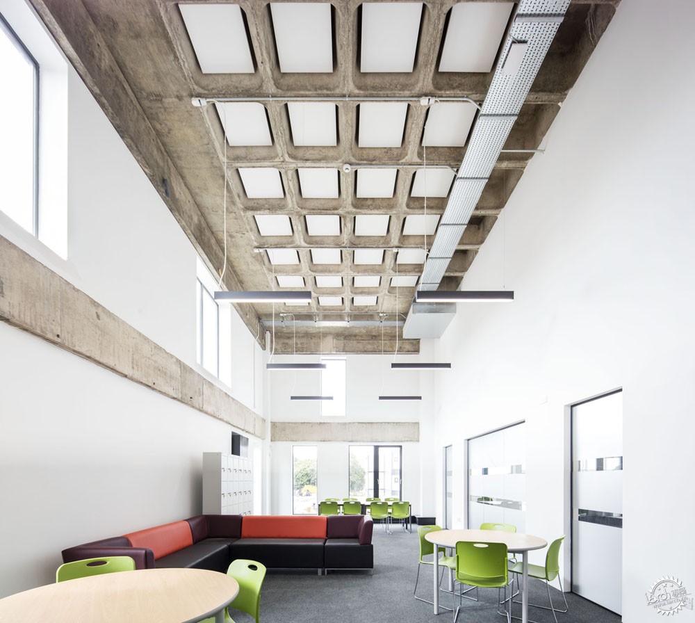

现有的楼板结构仍然保持裸露,新建筑的机械通风、电力设施也是同样的做法,标准化0.9米模块网格是整个教学楼的空间基本布局模数。白色石膏隔墙与新旧空间都不相同,它们插入混凝土外壳之中,将教学空间与院落分隔开。玻璃面板也能够构成视觉上的连通以及采光的作用。学校的每个区域都设置有色彩丰富的指示标识系统,它们都设置于各个面板之中,让学生们对于各个方向的指示一目了然。
The existing waffle-slab structure remains exposed, as do the new building mechanical and electrical services, and its standardized 0.9m-centered modular grid is used as a basis to inform and set out the spatial arrangement of the entire school. Differentiating the old and new, white plastered partitions have been inserted into the concrete shell to divide teaching rooms from the atria. Where possible, glass screens are also used to keep visual links and lightwells open. Each area of the school benefits from colorful wayfinding devices, seen mainly in the glass manifestations and the vibrant flooring choices for the main circulation stairs, acting as a wayfinding strategy to navigate the different areas of the school.
