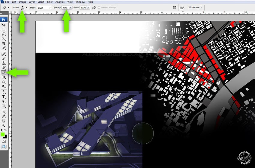

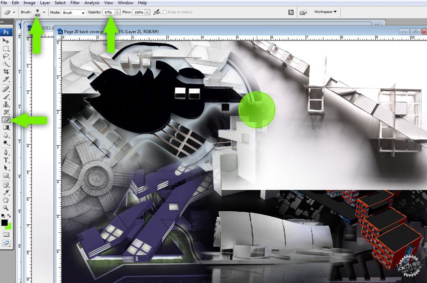

2)接下来我选择了几张图片,作为拼贴图的组织元素。为了避免粗糙的边缘,我选择了“橡皮擦工具”,选择了一个柔软的刷子,并且将不透明度降低到略低于 50%。然后我简单地擦除了图片的边缘,使得图片相互融合。对于有经验的 Ps用户,我建议使用一个图层蒙版,而不是橡皮擦工具,这样可编辑性会更强。
2) I next chose a few images that would act as organizing elements of the collage. To avoid harsh edges, I chose the “Eraser Tool”, selected a soft brush, and lowered the opacity of the brush just under 50%. I then simply erased around the edges to allow the images to bleed into one another. For experienced Photoshop users, I would suggest using a layer mask instead of the eraser tool to maintain more editability.
