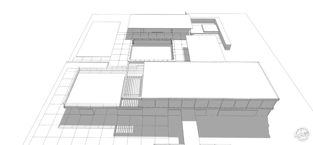

Modeling/建模
建3D模型的时候,我们在粗糙的立体结构上进行细致的操作。创建渲染图的时候,建筑功能不会有最优先考虑,所以对建筑布局可以自由选择。另一方面,整理一个建筑模型是很有必要的。
因此,我们对建筑引进一个网格结构。对我们来说,创建一个现代、轻巧且简单的建筑很重要,即使我们使用了一个坚固的网格。这里我们是从Donald Wexler, Richard Neutra和Pierre Koenig等现代派的建筑师身上得到了启发。
When doing our 3D modelling we started from rough cubic structures on to tiny details. The functionality of the architecture did not have the highest priority while creating an image, thus enabling a free choice of layout. On the other hand it is necessary to systematise an architectural model.
We therefore introduced a grid for the construction. For us it was important to create an architecture that is modern, light and simple even though we use a rigid grid. In this we were inspired by modernist architects like Donald Wexler, Richard Neutra and Pierre Koenig.

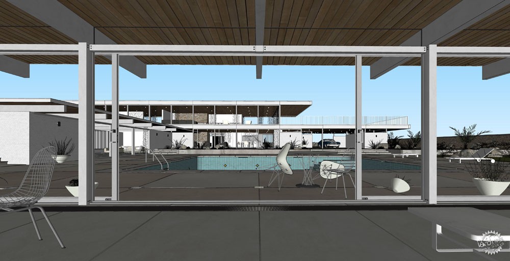

下面操作关系到最终透视。
也许你注意到了,椅子的位置和嵌板后来才进行渲染。我们没有截屏,因为我们没有将最终校正体现在模型中。
物品的位置很重要,因为最终图的深度是通过这些表现出来。
The following concerns the Final Perspective…
As you perhaps noticed, the position of chairs and diving board was rendered afterwards. Of this we unfortunately have no screen shot as we failed to file the final adjustments to the model.
Here, the positioning of objects is important as with these we try to give the final image depth.

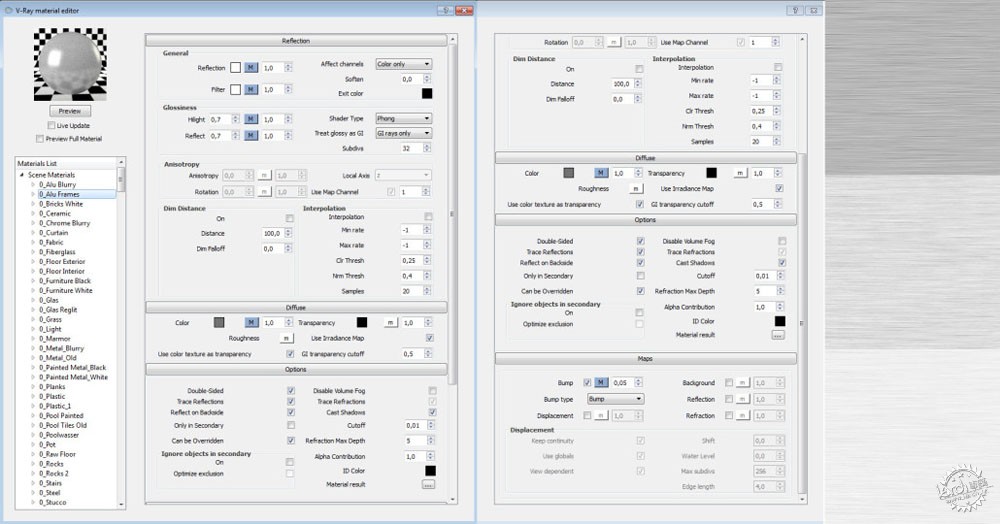

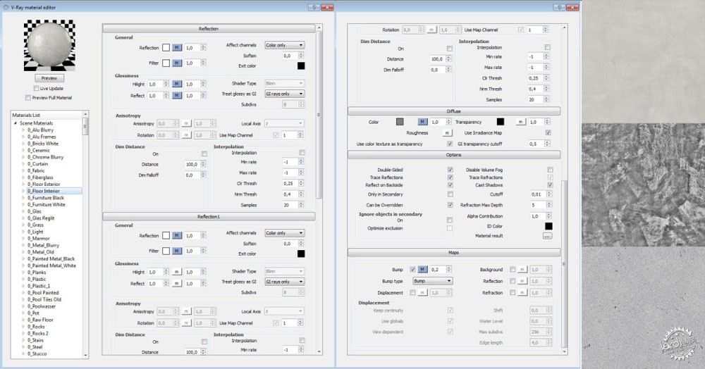

在创建材料上我们花了时间和经验。事实上,一些材料通过交换贴图一下子就创建出来了。后来我们决定叠加一些泥土、灰尘和锈斑,为后期制作做准备。
For creating material components we took our time and experimented a lot. In fact, some of these were created quite accidentally by exchanging mappings. We decided to add dirt, dust and rusty spots subsequently in order to have more free choices for post production.

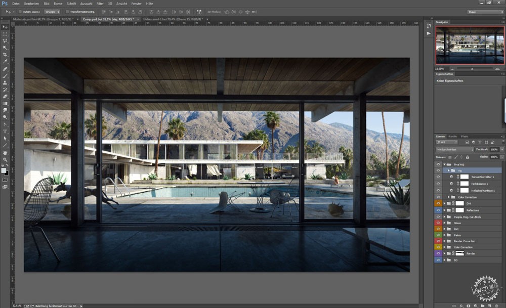

在开始最背景进行处理之前,我们用Camera Raw Filter插件对原始渲染图进行了编辑,来修正基本的特征,比如曲线、颜色、对比和亮度。
因为在最后的校正中,对比和亮度会 再次被编辑,所以不要把区域设置成100%的黑或白。其中一个最重要的元素就是BG,它让观察者决定这个尺度,使图象体现出深度。
到这一阶段,我们开始花时间来编辑好的参考图。背景是由几座山拼接而成。我们确实很喜欢在表面叠加纹理的过程。
后期制作中,对表面进行修饰编辑操作很有必要。在一些表面我们用传统刷子刷出纹理,而其他表面我们用不同的混合模式进行操作。
我们让表面呈现出不规则状态,提升了它的栩栩如生的感觉和真实感。最后的润饰只包含颜色调整、对比调整,还有稍微的软化集滤器。

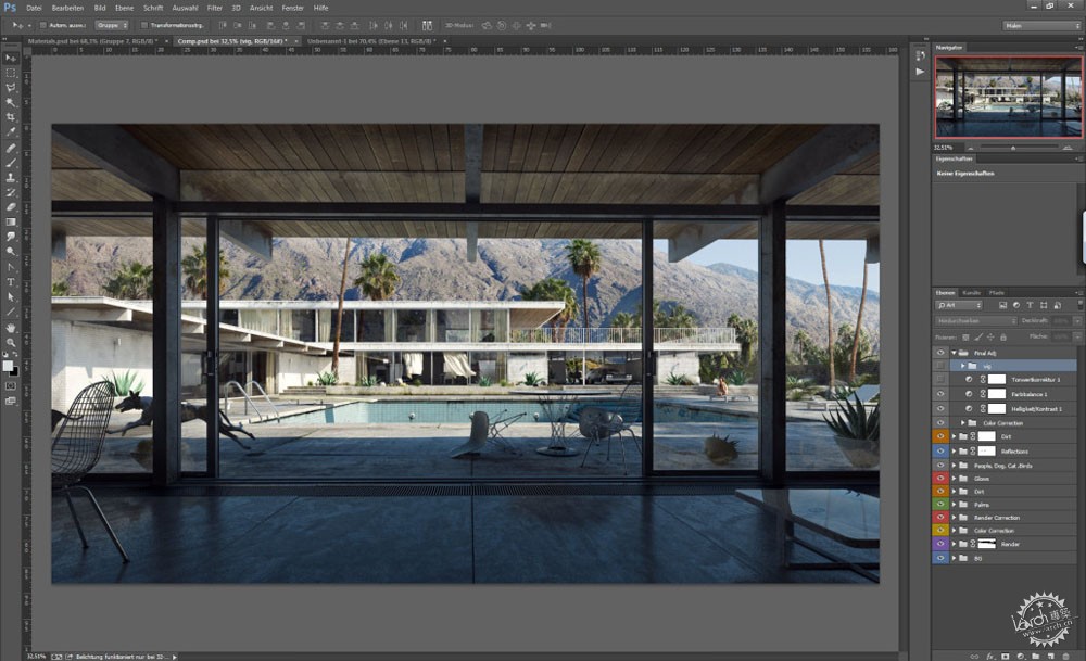

Before starting on the background, we edited the raw rendering with Camera Raw Filter to correct general features such as curves, colours, contrast and intensity.
Because contrast and intensity are again edited during final adjustments, it is important to not have areas 100% black or white. One of the most important elements is BG which lets the observer determine the scale and gives depth to the image.
At this stage, we took our time to compile good reference images. The background is composed of several mountain segments which have to have equal grain and exposure. We really enjoyed the adding of texture to the surfaces.
In starting post production, it is helpful to have available all the masks for surface editing and to use them subsequently. On some surfaces we painted texture with custom brushes, others were done with various blending modes.
We made sure to achieve an irregularity on surfaces thus improving their vividness and real look & feel. Final retouching only consists of colour adaptions, contrast adaptions plus a very slight soft focus filter.
