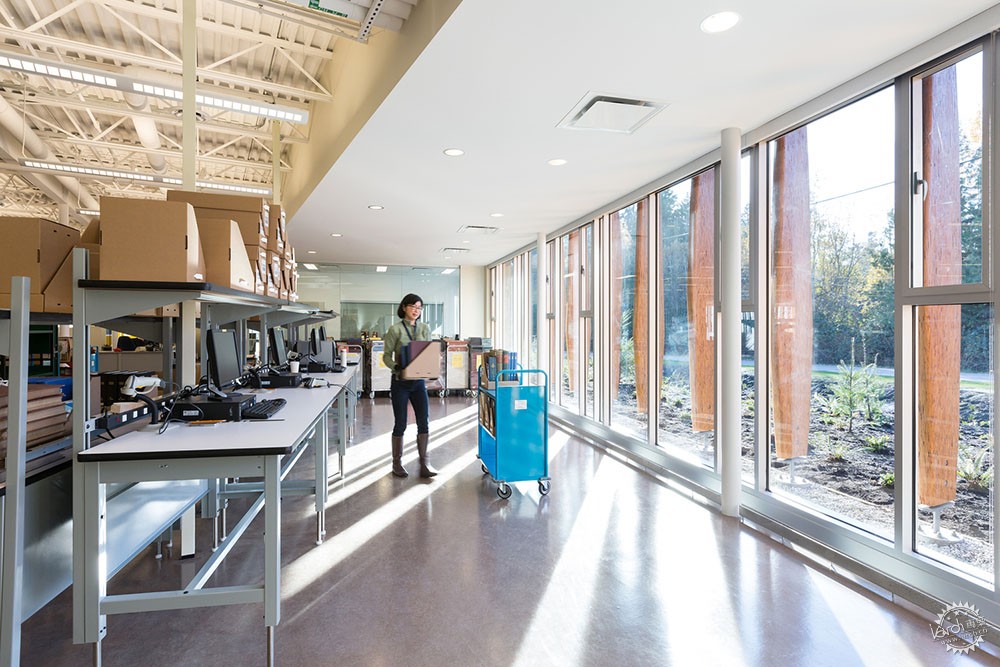

设施包括两个主要部分 – 处理/行政区,还有使用长方形存储模块的2045平方米的合并区。对于后者,在混凝土上使用着色雪松,包层在颜色和深度方面从视觉上参照了森林和条形码的形象。处理区和装载区的砌块和玻璃采用有趣的虚实组合,玻璃竖框重复间距的变化创造一种垂直节奏,再次参照了条形码。空白区用于渗透自然光,允许从不同方向观看树林。入口木元素和西部玻璃遮阳篷活跃了处理区的氛围。为了使大型体量变小,设施的体块分为三个部分,通过使用相似的包覆材料和统一的颜色达到这种效果。折叠屋顶和木质拱腹包围在整个处理区上方,为各部分提供连接作用。

The facility consists of two main parts – a processing/administrative area and a long rectangular storage module for a combined area of 2,045 square metres. For the latter, the cladding visually references the forest and the barcode through its use of colour and depth using stained cedar on concrete. The blockwork and glazing of the processing and loading areas employs a playful solid void composition with the glazing mullions replicating a varied vertical rhythm of spacing again referencing the barcode. The void areas are used for infiltration of natural light, permitting views to the forest from various orientations. Wood elements at the entry and the sunshades on the west glazing enliven the expression of the processing area. To diminish the large volume, the facility’s massing is divided into three parts and united through the use of similar cladding materials and colours. The folded roof and wood soffit wraps over the processing area, providing a connection of the parts.
