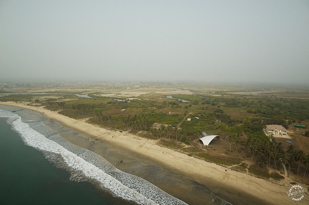

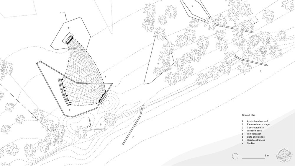

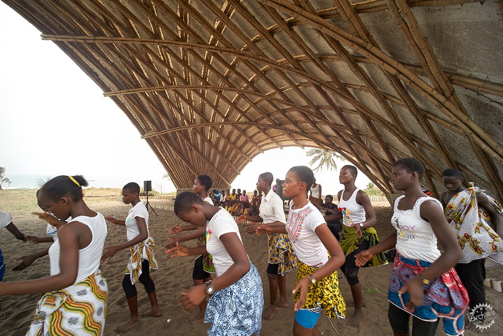

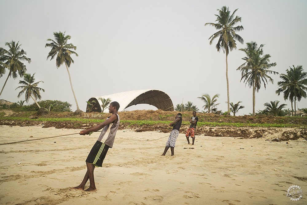

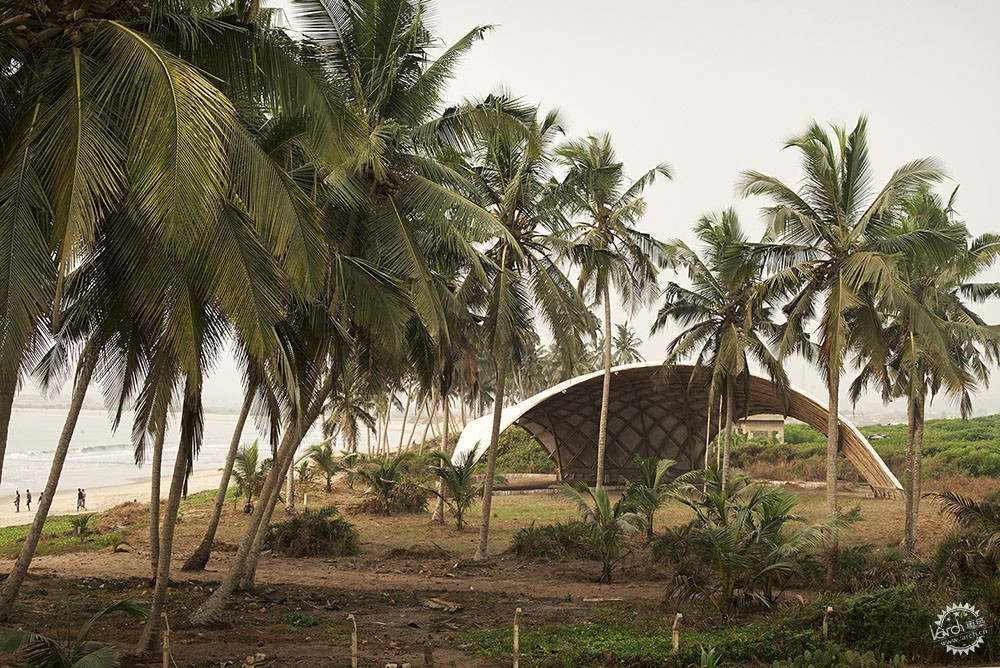

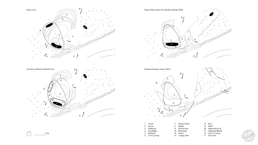

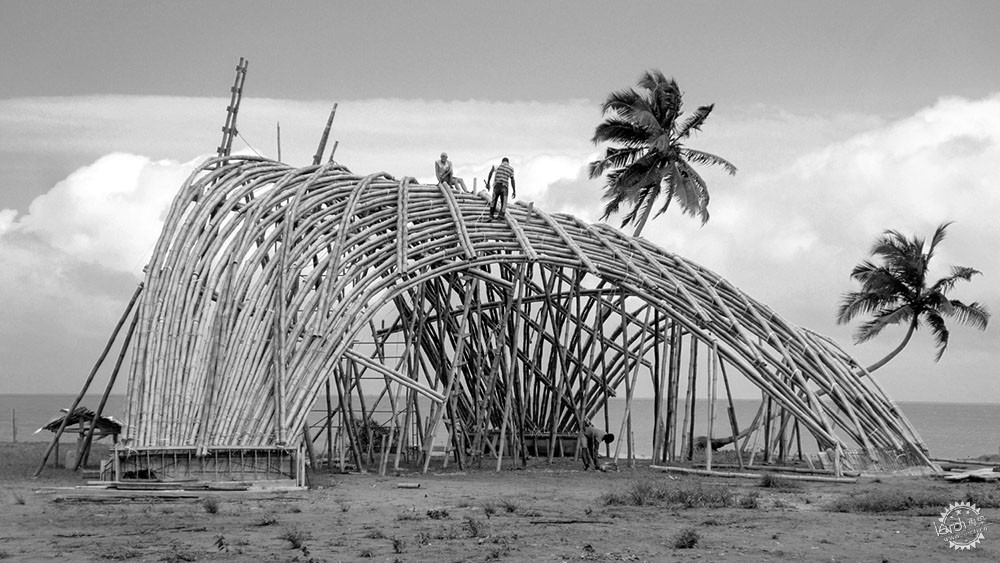

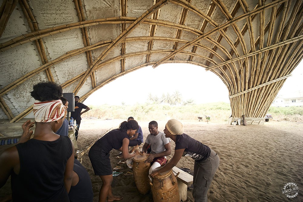

建筑师设计了位于场地海滨的景观屋面,大尺度的竹子结构是场地中的重要标志,巨大的圆顶有着三个面向不同方向的拱门,展现出全新的开放空间形式,建筑能够遮风挡雨,这是其主要空间特点。
The resulting design is a roofscape and floors-cape located on the ocean borderline of the terrain. The large-scale bamboo structure is a significant landmark in its context. A giant dome with three arches facing in different directions, it presents a typologically new form of open space. One of its spatial qualities is that it combines protection from and inclusion of external elements such as sun, wind, and rainfall.

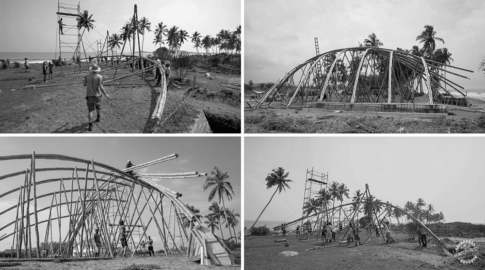

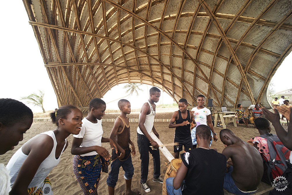

建筑的主要结构来自于由竹子建造而成的壳体,竹子是世界上应用较为广泛,且强度也很大的材料,建筑的几何形态取决于竹子的材质、结构、技术,以及空间潜力的影响,这座建筑很好地成为了加纳当地的可持续作品,而这个项目也有望让加纳加入“竹子建筑的世界版图”之中。在该项目中,建筑师和当地的工人、专家进行了密切合作。
The primary structure is a grid shell consisting solely of bamboo - one of the most versatile and strongest materials on planet Earth. Its geometry has been informed by the material quality of bamboo and its structural, technical, and spatial potentials. Constructing with bamboo is also meant to foster the reputation of sustainable architecture in Ghana. In this regard, the aim of the project is “to put Ghana on the world map of bamboo” (Jörg Stamm). The project was built by the authors themselves, together with local experts and workers.

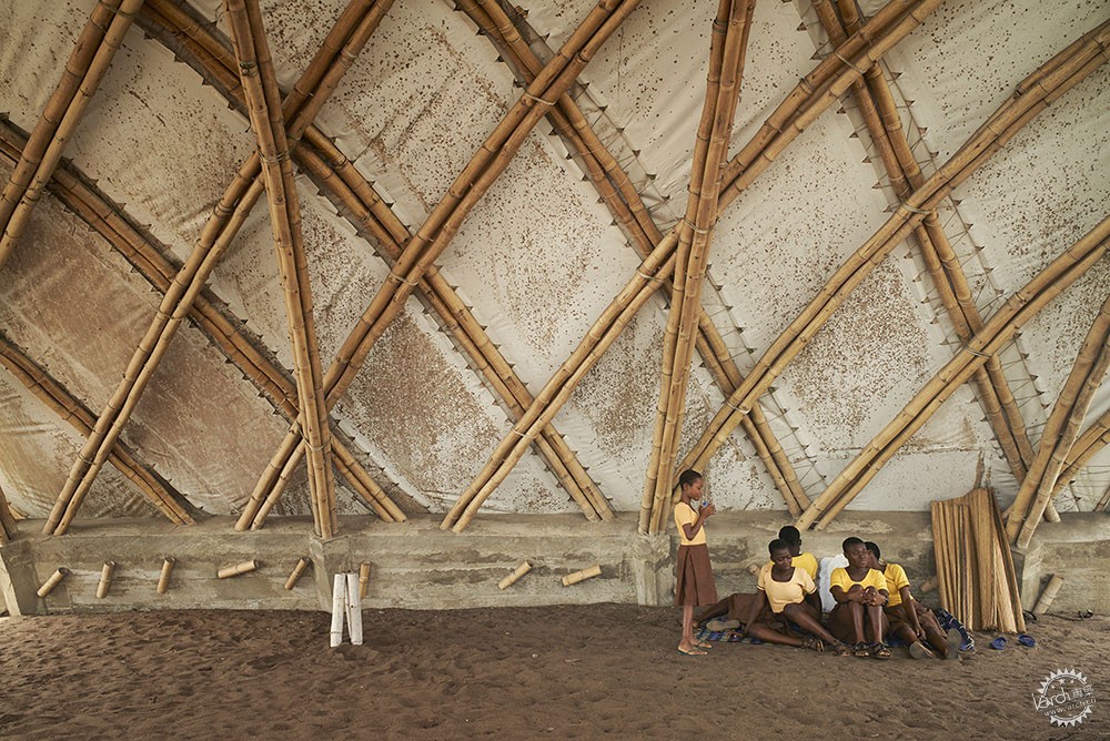

将竹子用作有机建筑材料给当地的建筑带来了更多可能性,同时也给全新的设计与规划策略带来了新契机,竹子通过高度弯曲的形态构成了壳体的形式,整座建筑由41个拱形而构成。
Using bamboo as an organic building material gives rise to new possibilities for local architecture, at the same time, it grants opportunities for new means of design and planning. Bamboo and its high flexure actively defines the form of the grid shell, which consists of 41 arches.

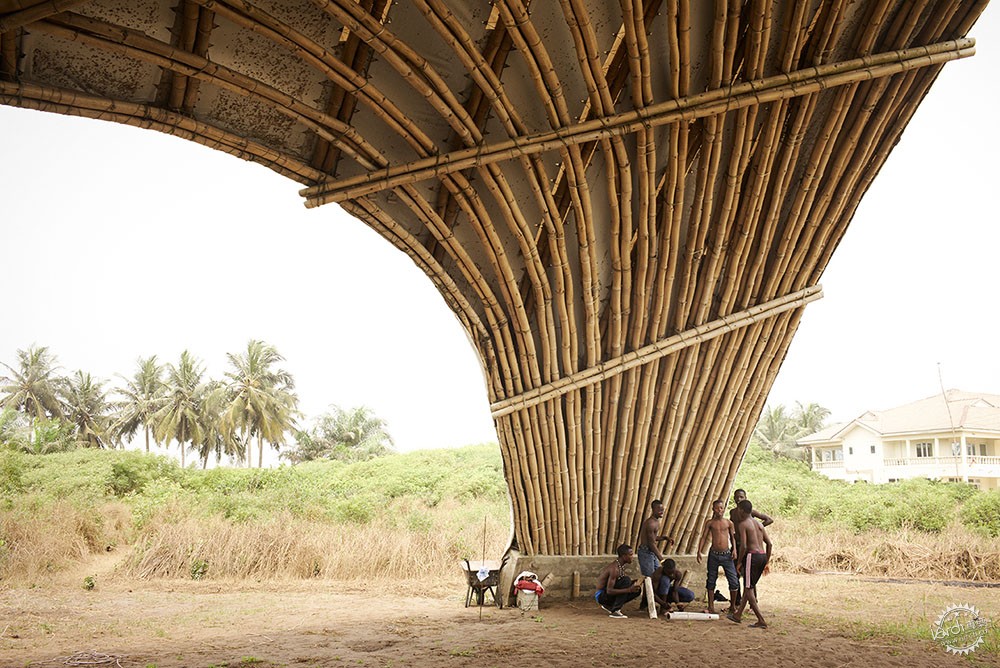

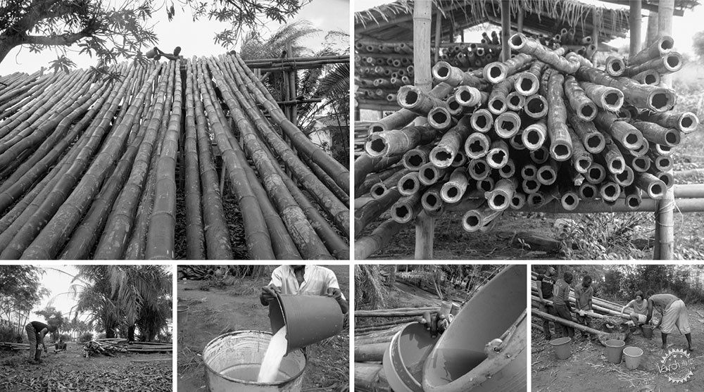

为了避免腐蚀,建筑师将竹钉用于固定这些拱形元素,所有的竹子都经过了化学处理,然后在其外部覆盖了一层坚硬的表皮,这能够帮助抵御强风,减少雨水和阳光对于材料的影响。
The use of metal elements for joinery was avoided to prevent corrosion, which occurs a great deal in the salty climate of Ghana′s Atlantic coast location. Instead, thousands of bamboo nails were produced and used on site to construct and join the bamboo arches. All the bamboo culms were treated with Borax, later, the primary structure was covered with a strong skin that could endure the strong wind forces, and that protects the bamboo from tropical rainfall and constant sun radiation.
