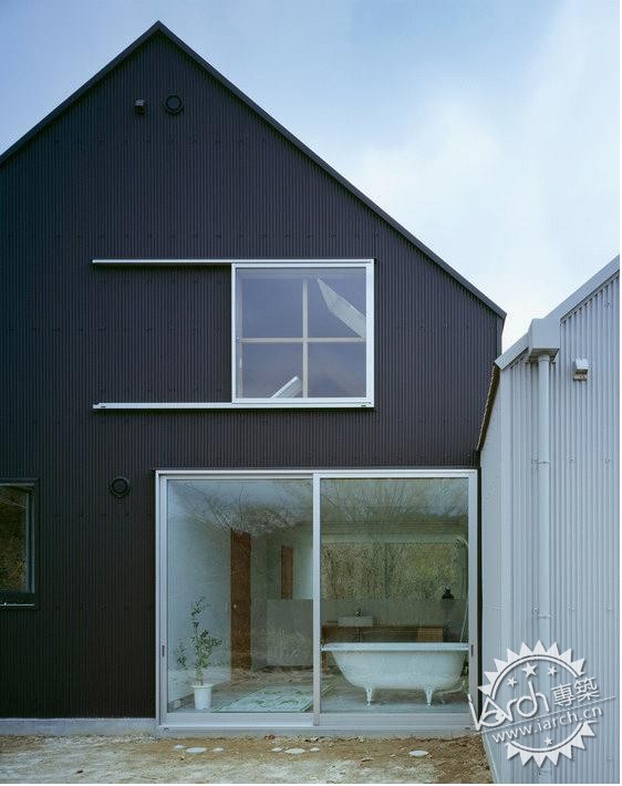

The house is located in Shiga Prefecture halfway up Mt. Hiei. The client is an artist who needed an atelier and a house for his family with a space for his parents to live together in the near future. The houses in the nearby existing residential area are gable-roofed keeping to the regulation that demands slanted roof, which appeared to be providing a sense of serenity along the street. We pursued a study for architecture to match the site in between such residential area and woods.
该住宅位于日本滋贺县比睿山的半山腰。业主是一位艺术家,他需要一个工作室和一幢家庭住宅,住宅里要有老人房,因为不久的将来他父母将过来一起住。为了能在街道边给人营造一种宁静的感觉,规范要求要有坡屋顶,所以房子周边现存的居住区都是双坡斜屋顶。我们继续建筑的研究,能让它与居住区域和木构之间的场所相适应。

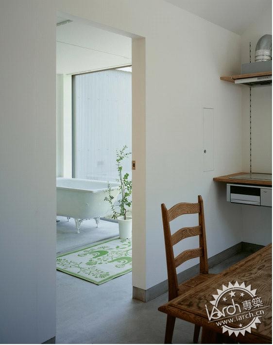

The foundation of the two living houses was finished simply with mortar to most efficiently use the floor heating by foundation heat condensing system as well as the atelier. The inside walls were all finished with lauan plywood and painted white partly.
两座住宅和工作室的基础都只用砂浆简单的处理了一下,这能使由基础热量冷凝系统加热的地板得到最大的利用。内墙都采用柳桉木胶合板,部分墙体被刷成了白色。

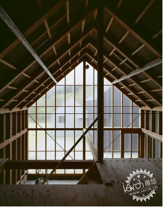

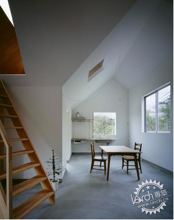

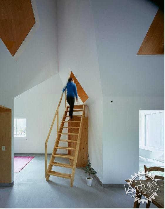

The floor space of upstairs was not required to be so large but was required to be independent to some extent. As ordinarily upright walls would make the space of upstairs cramped and the ceiling of downstairs too high, the partition walls were leaned to have the solid space divided diagonally, and thereby a ”hill-like-floor” and a ”roof-like-ceiling” emerged. Here appeared such a new model as assembling a small cottage type into a large cottage type.
楼上的地板空间并不用太大,但是在某种程度上要求独立一些。一般的垂直墙会使得楼上空间变狭窄,楼下的天花板又太高,这次我们把隔墙倾斜,使得原有空间按对角线被分割出来,于是如山似的地板和如屋顶似的天花就出现了。在这个新的住宅中出现的情形,就好像小房子就被套在大房子里面一样。
