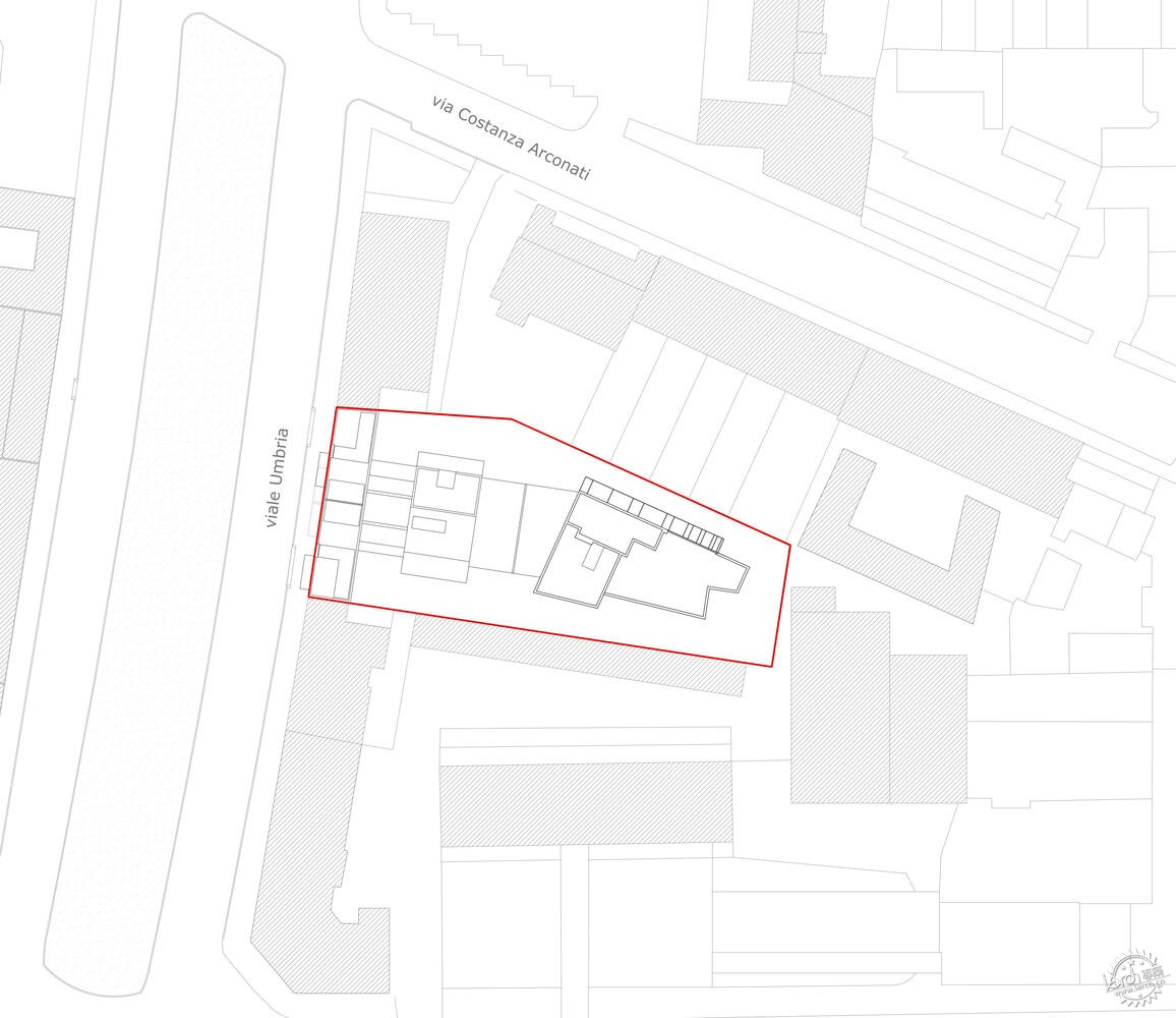

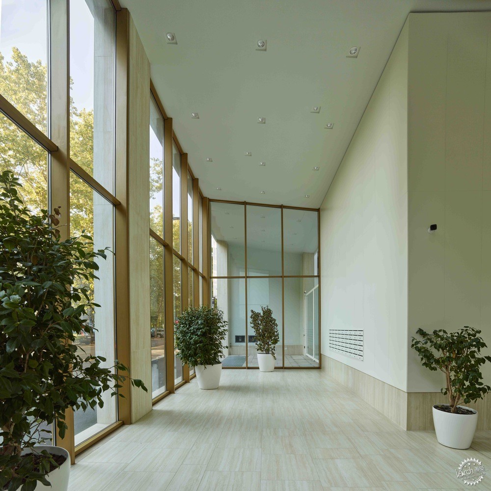

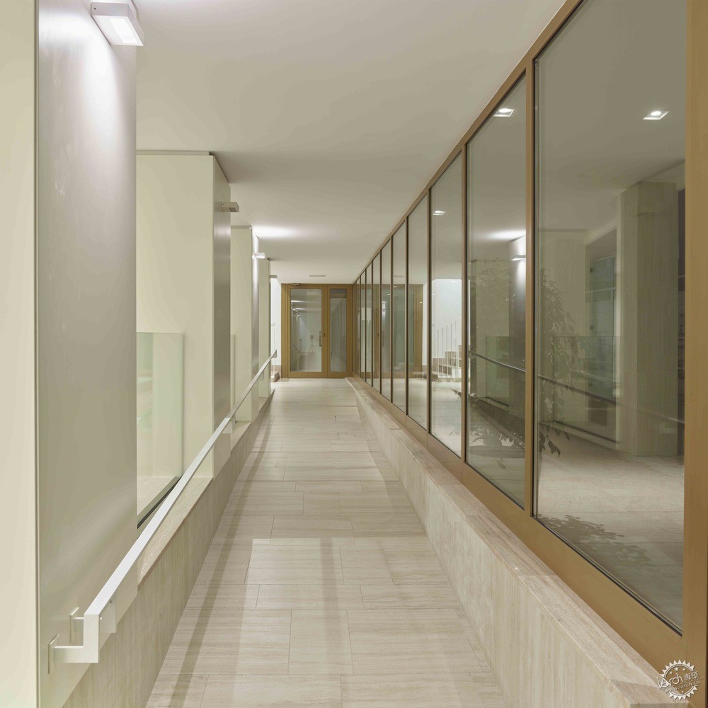

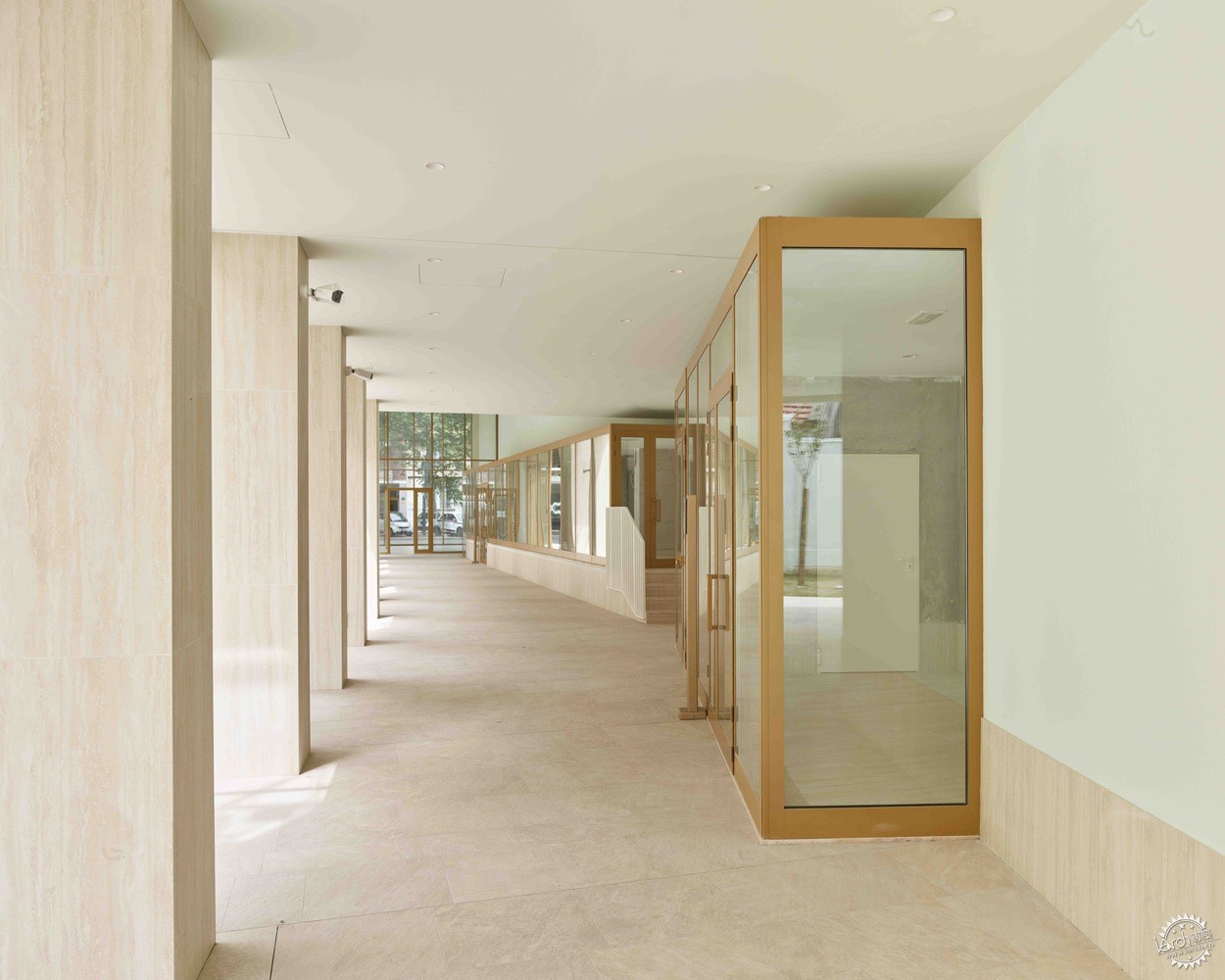

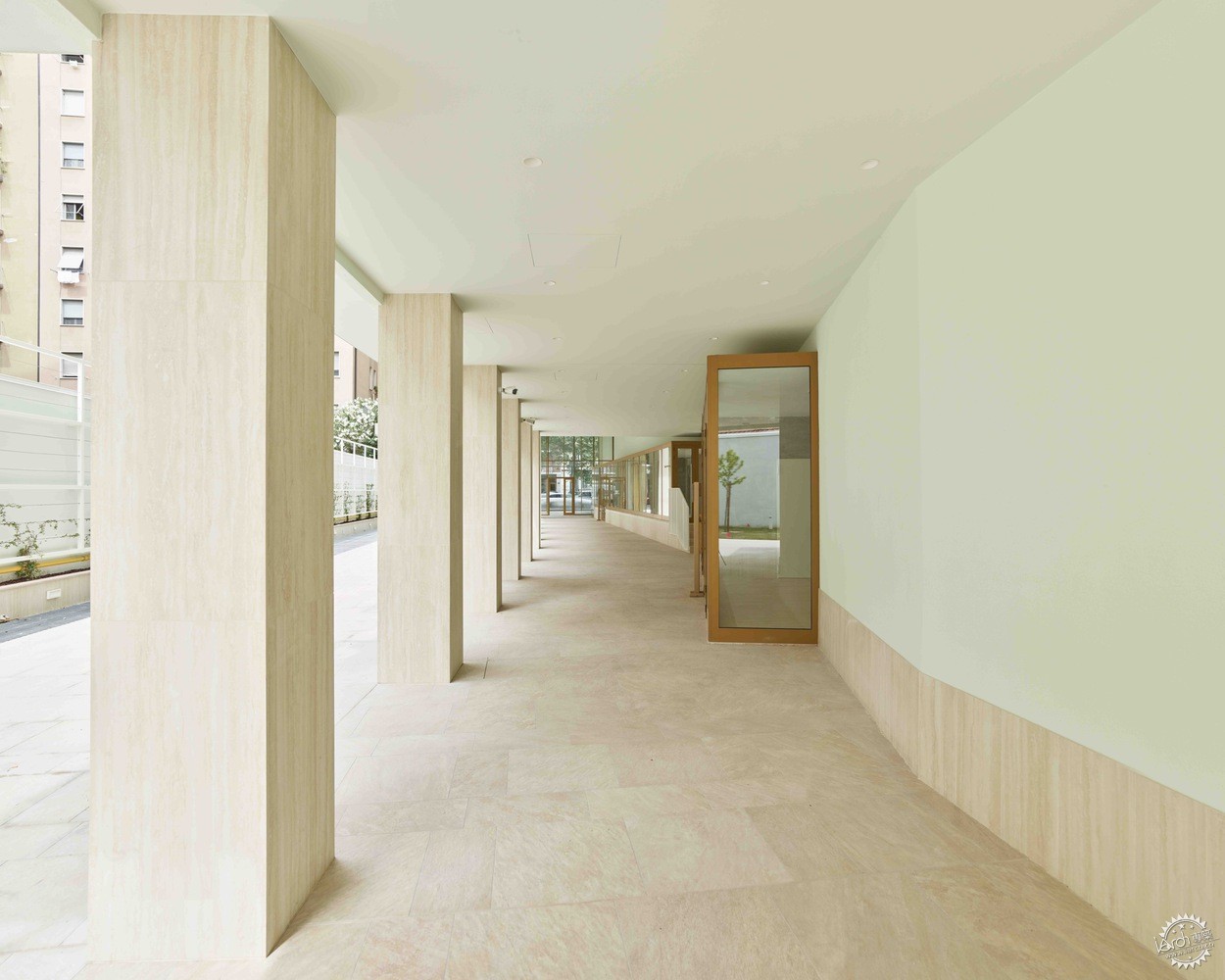

这座建筑由主要体块和一个附属体块构成,前者构成了Viale Umbria街区的沿街面,后者则向街区的中心纵向延伸,建筑的楼梯串联了11个楼层,就建筑形态而言,其中结合了塔式和板式两种类型,人们从街道上可以通过通高的大堂进入门廊,通过门廊可以去往楼梯间和地下停车区域。

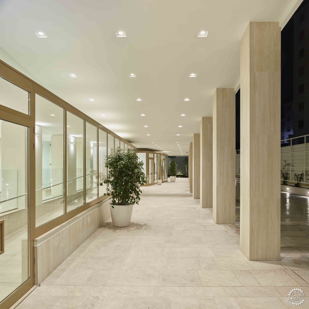

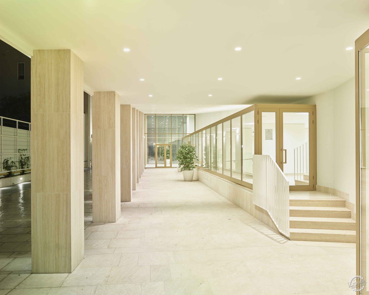

Text description provided by the architects. The building is composed of a wing that completes the block’s perimeter wall on Viale Umbria and an orthogonal wing that extends in depth towards the center of the block, with the last of the three stairwells extending the height of the building’s eleven above-ground floors: from the morpho-typological standpoint, the building is, therefore, a hybrid between a block’s perimeter wall type, a slab type, and a tower type. From the large double-height lobby on the street, there is access to a portico that provides direct access to all the stairwells and underground parking areas, accessible via independent staircases.

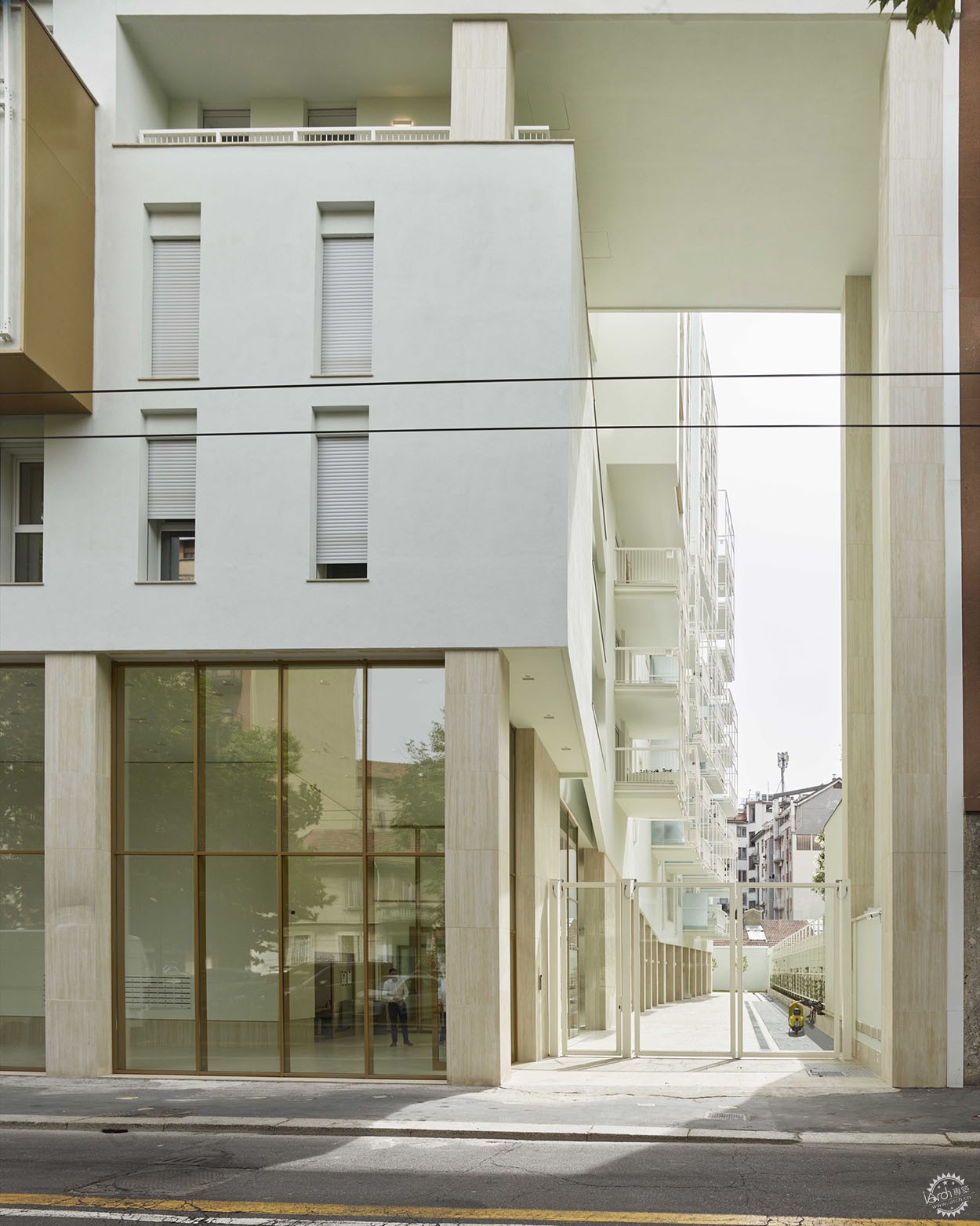

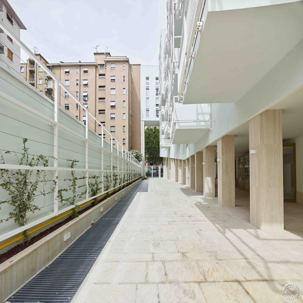

这一组合构成了三个主要立面,分别朝向西侧、南侧和北侧,人们在街道上可以看到南侧和北侧的两个主要入口。
This composition establishes three main façades: the one on the Viale facing west and two other façades facing south and north, clearly visible from the street through two large portals: the pedestrian one five floors up through which a glimpse of the south façade is visible and the vehicular one two floors up through which the north façade is visible.

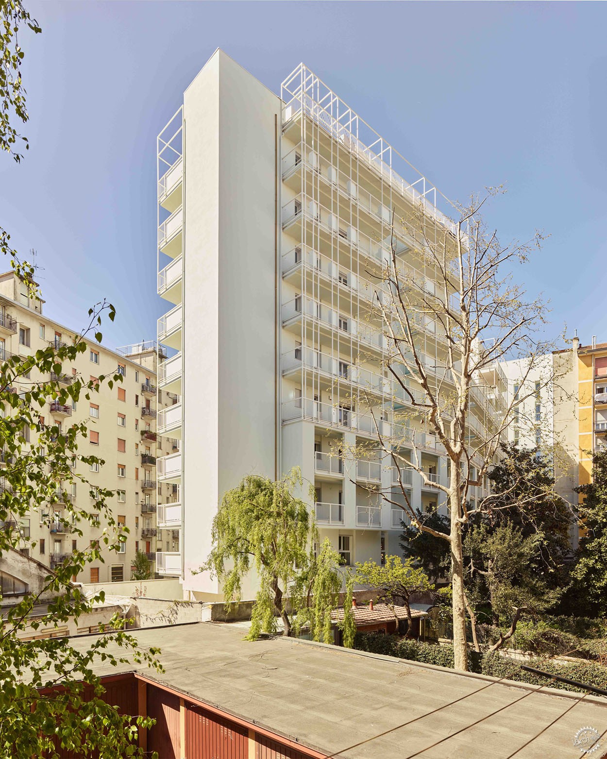

该项目的建筑语言以两个不对称的立面为基础,Viale一侧的立面有着四个一层楼高的弓形开窗,除此之外还有另外一个体量,类似于曾经的凉廊形式,而建筑的南立面则有着两个四层高的凸出凉廊,不对称的凸起立面在米兰也曾经有着多种案例,比如由Perogalli和Mariani设计的Astratta住宅,其中也应用为幕墙,就结构而言,还有由Gigi Caccia设计的住宅等。
The syntax of the project is based on a composition of the façade using asymmetrical overhangs: the façade on the Viale has four one-story-high bow windows (plus an additional body, similar to the previous ones, in the form of a loggia), while the south façade has two protruding loggias four stories high. A façade design with asymmetrical protrusions has various precedents in Milan, such as the Casa Astratta by Perogalli and Mariani (1951-52), also a curtain wall or, in terms of parallel structures, the residences by Gigi Caccia on Via Nievo 28/a (1955-57) and by the Latis brothers on Via Rossetti (1959-60), especially the rear façade.

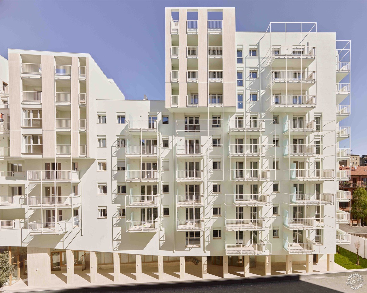

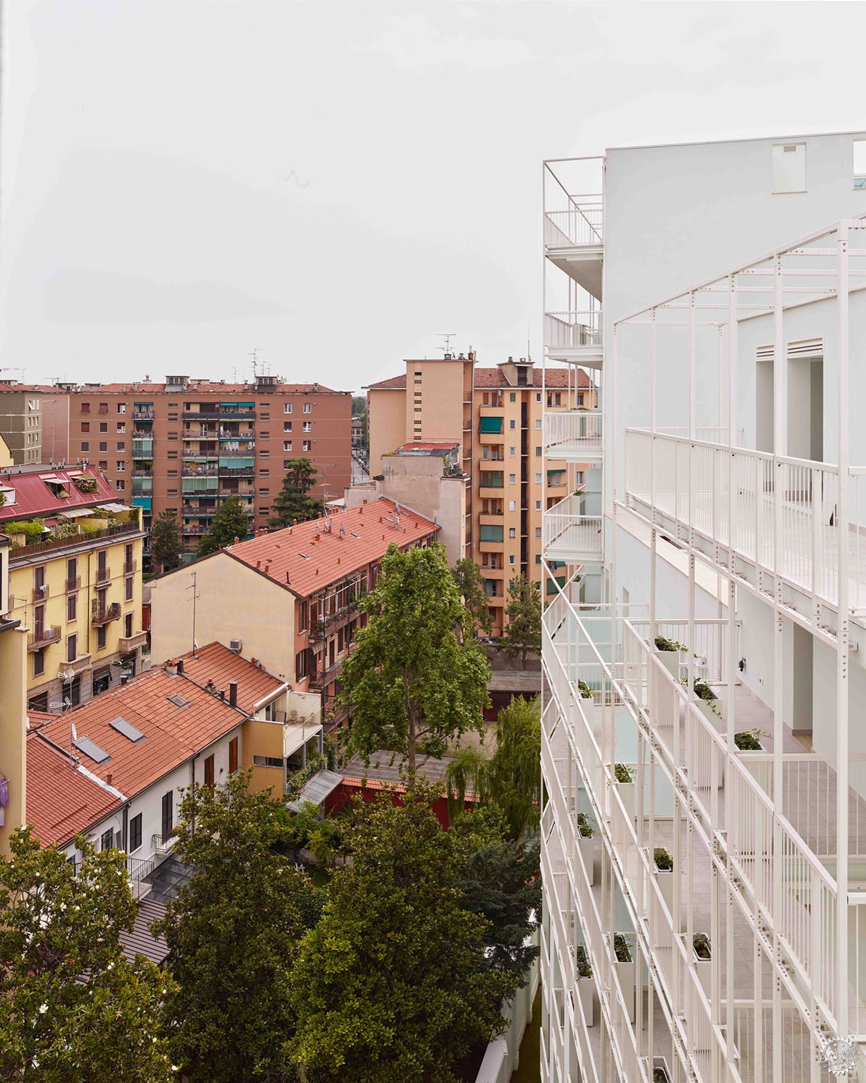

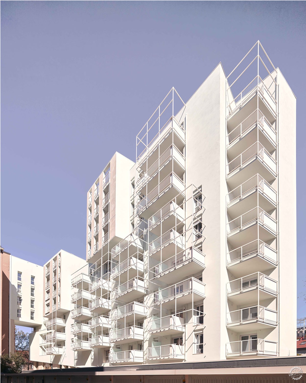

在这些情况下,一定的弓形窗户凸起结构表达了立面的动态感和不对称形式,南立面的设计并不局限凸起的位置,除此之外还有一些轻质金属结构将阳台组合在一起,增加了建筑的高度,一层有着独立的阳台,然后是二至三层的组合,以及四至六层,最后是七层至顶层。
In all these cases, the modest protrusions (bow windows) exemplify a dynamic and asymmetrical composition of the façades. In our project, the design of the south façade is not limited to the arrangement of the multi-story protrusions; there are also lightweight metal structures (60-mm square sections) that group the balconies together, increasing their height from the ground to the top level: a single balcony on the first floor, then two grouped levels (floors 2-3), three grouped levels (floors 4-6), and finally four levels (from floor 7 to the penthouse).

建筑的北立面有着不同的设计,这一侧有着长长的连续阳台,这也是米兰住宅建筑的典型元素,案例也很多,比如来自Gardella,Castelli Ferrieri以及Menghi的Casa ai Giardini d’Ercole,以及Melzi Pertusati综合体的连续体量。而在该项目中,阳台的处理略微有差异,在前两层包裹着墙体,再结合了凉廊,而在上层,阳台则通过金属框架分隔开。
The north façade has a different design: on this side, there are long continuous balconies, another typical element of Milanese residential architecture, with numerous examples such as the Casa ai Giardini d’Ercole by Gardella, Castelli Ferrieri and Menghi (1949-55) and the contiguous internal body of the Melzi Pertusati complex, designed by Minoletti (1955-59). In our project, however, the linguistic treatment of these balconies introduces certain differences: on the first two levels of the balcony, it is enclosed by walls that configure it into a loggia; on the upper floors, the balconies are partitioned by the same thin metal frames that appear on the other façades.

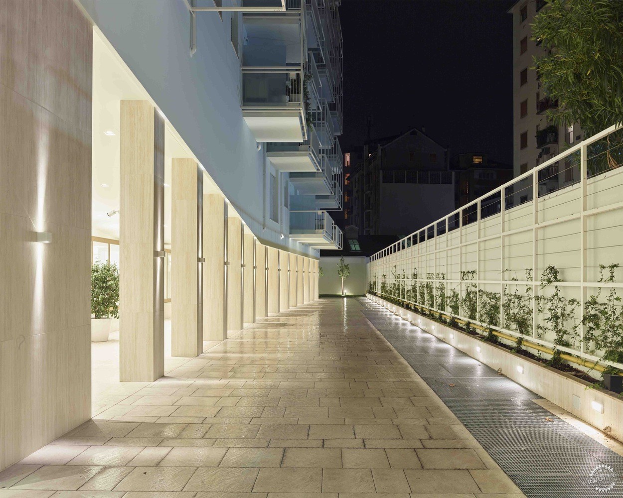

考虑到该临街建筑整体的协调性,这种结合隔板的柱子布局也应用于北侧立面之中,同时结合了递增的模块模式。
The arrangement of the pillars of this thin diaphragm, mindful of similar uses in the Latis building on Via Lanzone (façade on Via Ghisleri) (1949-51) and above all in the buildings of Guglielmo Mozzoni (Via Fatebenefratelli, Via Corridoni), is in our case designed on the north façade in a slowed perspective (prospettiva rallentata), with incremental modules.
