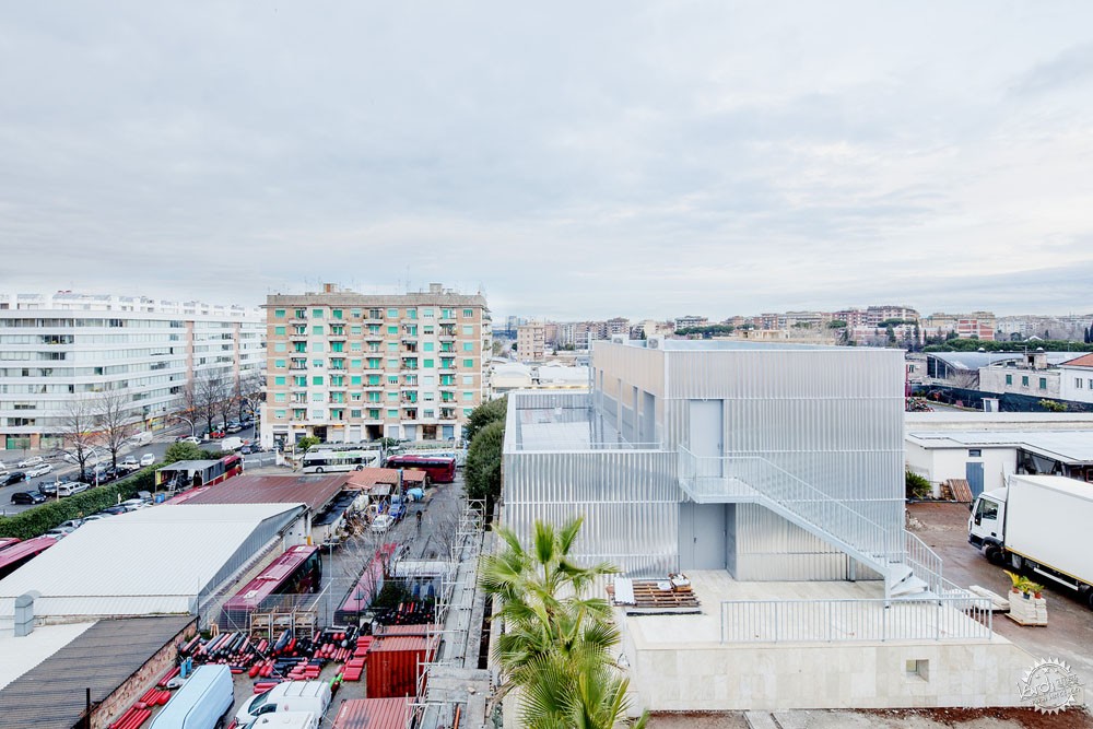

这座三层楼高的建筑位于一条上坡的次要道路上,比主街高出10米,成为城市中这一奇特地区的地标,但是建筑仍具有一定的后工业特征。
The three storey building is located on an uphill secondary road, 10 meters higher than the main street from which it emerges as a landmark of this odd portion of the city, still in search of its own post-industrial identity.

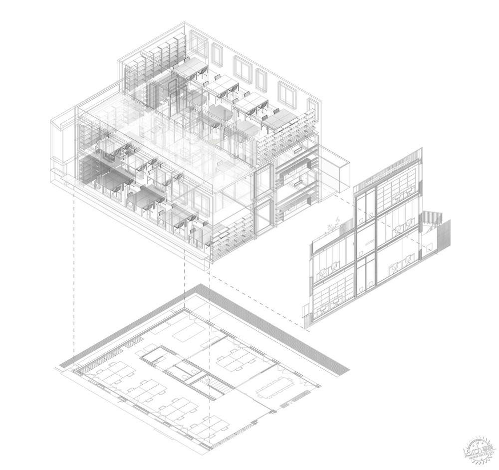

这个项目被作为一个研究案例,用于全面的BIM工艺过程管理(2017年获得BIM & DIGITAL奖)和预制工艺过程。
The project was used by it’s as a case study both for the full BIM process management  (awarded in 2017 with the BIM & DIGITAL Award) and the prefabrication process.

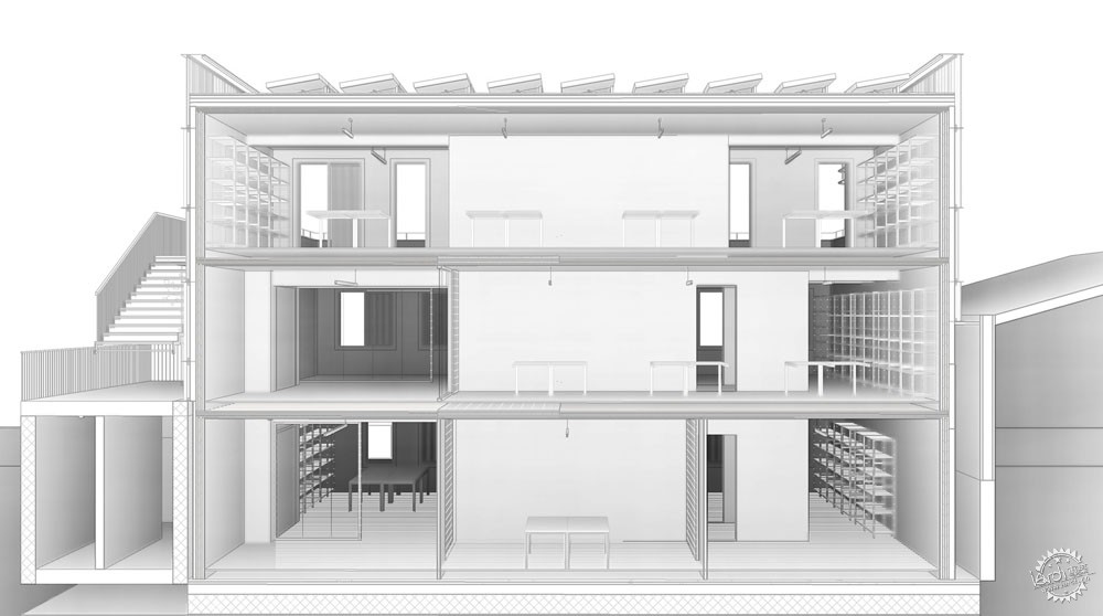

这种预制的方法使施工时间大大缩短到6个月,其中还包括了微桩基础,保证了对建筑技术质量及其成本的控制。同时,建筑达到了很高的节能标准:屋顶的光伏板可以实现零能耗。建筑结构是木制的;XLAM的承重墙在4周内安装完毕。外涂层的材质主要为铝材。通过对立面的研究,使优化面板的模块化成为可能,将纹理和大小的协调后同时也创造出工业美学。
This approach allowed to drastically reduce the construction time to 6 months, including the micropiles foundations, guaranteeing the control of the technical quality of the building and its costs. Also, the building achieves high energy saving standards: photovoltaic panels on the roof allow to reach the goal of zero consumption. The structure is in wood; the bearing walls in Xlam mounted in 4 weeks. The external coating is aluminum. The study of the facades made it possible to optimize the modularity of the panels and to insert variations in texture and size in order to obtain a precious and industrial aesthetic at the same time.
