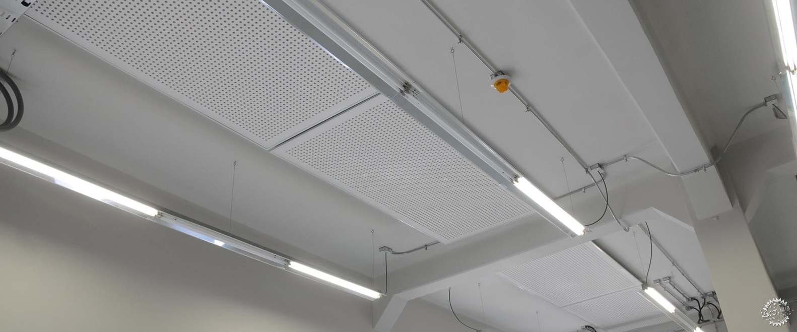

Cortesía de Romeral
如何提高穿孔石膏板的声学舒适性能
How To Improve Acoustic Comfort with Perforated Cardboard Plasterboards
由专筑网李韧,曹逸希编译
解决室内空间声学舒适性的方式有很多,比如可以运用不同价格与外观的材料。穿孔石膏板便是一种经济且高效的方式,它可以有效地吸收噪音,通过不同的模式和形态降低噪音所形成的混响。
石膏板主要应用在学校、办公室、购物中心、餐厅、大厅,以及医院,这种材料的安装非常方便,还可以提升美学效果。
There are many ways to solve the acoustic comfort of the interior spaces we design, using materials and solutions of different prices and appearances. Perforated cardboard gypsum boards are an economical and efficient option to incorporate into projects, absorbing the sound and reducing the noise level generated by the reverberation through different patterns and shapes.
Applied mainly in schools, offices, shopping centers, restaurants, lobbies, and hospitals, gypsum boards are easy to install and can deliver high-quality aesthetic results in ceilings and coatings.

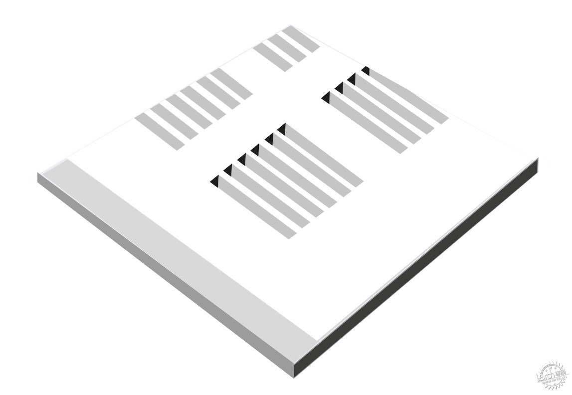

Tipos de perforaciones. Image Cortesía de Romeral
穿孔率越高,吸声效率越好
穿孔自身能够帮助声音的吸收,这就如同共振器。通过这种方式,当声音进入到石膏板的空腔之中时,就会损失一定的能量。但是这种方式的结果也取决于外部物理条件,例如天花板的厚度、空间的高度,以及穿孔板内部的材料。
The Higher The Perforation Percentage, The Greater The Sound Absorption
The perforations themselves contribute to the absorption of sound, working as a resonator. In this way, the sound loses energy when entering the formed chamber, for example, between the ceiling and the slab. It is important to consider that the result will depend on the height of the plates, in the case of ceilings; and on the thickness of the air chamber, in the case of the linings.
