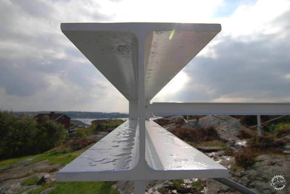

建筑由19根圆形的支柱支撑着,直径为80毫米。每根圆柱都设置于300毫米深的钻孔中,并且通过膨胀石膏固定。圆柱的定位和高度都通过现场测量而决定,这样能够在镀锌前进行预制工作。这些圆柱支撑着3根HEA200横梁,这些结构部件支撑着整座建筑的荷载。所有钢部件都覆盖着白色镀锌粉末层,这些结构施工工作于两个星期内完成。在钢部件的顶部设置有预制木框架,其建造时间甚至不到3个星期。建筑下部覆盖着白色穿孔波纹铝板,所有的金属部件都覆盖着涂层铝。住宅的窗户通过Schüchos系统建造而成,建筑立面与1 号Plastic小屋运用的是同样的设计逻辑,立面上是5毫米厚的透明PPMA面板,它通过尼龙丙烯酸泡绵胶带粘合在立式金属板立柱之上,从而避免构件的直接暴露,同时也能解决热胀冷缩问题,如果后期需要更换,这些面板也很容易拆卸。
The house is supported by 19 circular 80 mm columns. Each column is placed in a drilled hole (300 mm deep) and has been fixed with an expanding plaster. The locations and the heights of the columns have been measured in on-site to enable prefabrication before the galvanization. The columns support three HEA 200 beams that support the whole house. All steelwork is galvanized and powder-coated in white. The complete steel construction was carried out in two weeks. On top of the steel, a prefabricated wooden frame was mounted in less than three weeks. The underside of the house has been covered with white perforated corrugated aluminium. Due to the exposed position, all other metalwork consists of coated aluminium. The windows have been built with Schüchos system. The facade is a development of the system we created for Plastic house I. A façade with 5 mm opaque PMMA is taped with velcro acrylic foam tape mounted on standing sheet metal studs, to avoid exposed fixings and to handle the thermal expansion. The sheets can then easily be demounted if need of replacement.

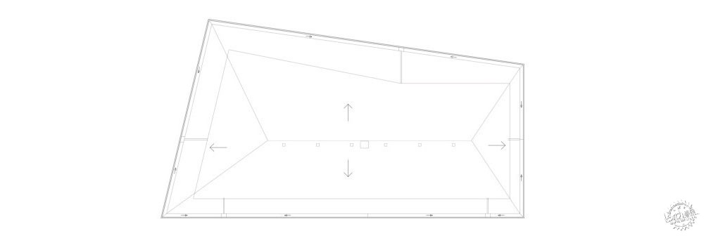

平面图/Floor Plan 2
