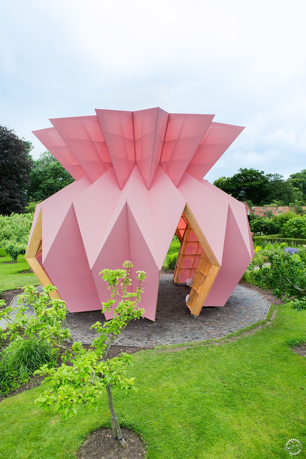

在英国赫里福郡18世纪的伯灵顿乡村庄园的中心,艺术工作室Morison建造了一个粉色的折纸“菠萝”馆。当地的艺术家Heather和Ivan Morison委托设计一个现代化的构筑物,以此吸引游客并为伯林顿馆围墙花园的重修启动筹款。格鲁吉亚的景观设计师——兰斯洛特“能力者”Brown设计了围墙花园,这个“菠萝”构建在封闭的院子里被称为“看!看!看!”。
这是布朗最后完成的景观工程,也是他唯一的围墙花园。
Artistic duo Studio Morison has erected a pink pavilion shaped like an origami pineapple in the centre of the 18th-century walled garden of the Berrington Hall country estate in Herefordshire, England.  Local artists Heather and Ivan Morison were asked to design a contemporary structure that would attract visitors and kickstart fundraising for the restoration of Berrington Hall's walled garden.  The construction called Look! Look! Look! is enclosed within a walled garden originally designed by Georgian landscape designer Lancelot 'Capability' Brown. This was Brown's last completed landscape project, and his only walled garden.

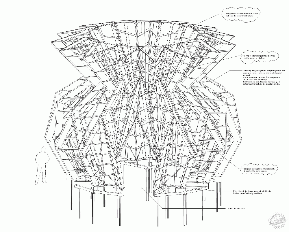

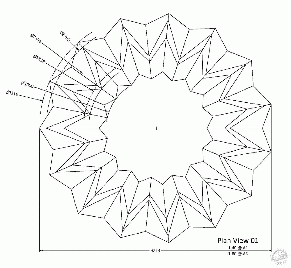

Morison先用折纸做了这个构造物,然后与结构工程师Arturo合作使它成为现实。这对艺术家创造了8米宽X8米高的亭子。金属底座和木材结构被包裹在一个粉红色的外壳中,其主体用折叠的形式呈现出来。
构筑物的浅粉色表皮用白色和红色的编织物实现,它与周围的绿色环境产生鲜明对比,英国公司Mermet完成了涂层的玻璃纤维织物的设计。构筑物由90个部分组成,像拼图一样把它们组装起来,织物被拉扯和固定在每一个菱形上,在围院花园现场组装,最终需要大约六个月的时间来构建。
Studio Morison first designed the structure using origami, and then worked with structural engineers Arturo to bring the design to life.  The pair created an eight-metre-tall by eight-metre-wide pavilion. The metal foundation and timber structure is encased in a pink shell, the body of which appears to have been folded into shape.
The dusty pink finish of the structure is achieved from a white waft and a red weave, which stands out against its green surroundings, and is made from a coated fibreglass fabric engineered by UK company Mermet.  The structure is made of 90 sections and assembled like a jigsaw, with the fabric then pulled over and fixed to each rhomboid, and assembled on site in the walled garden, ultimately taking around six months to construct.

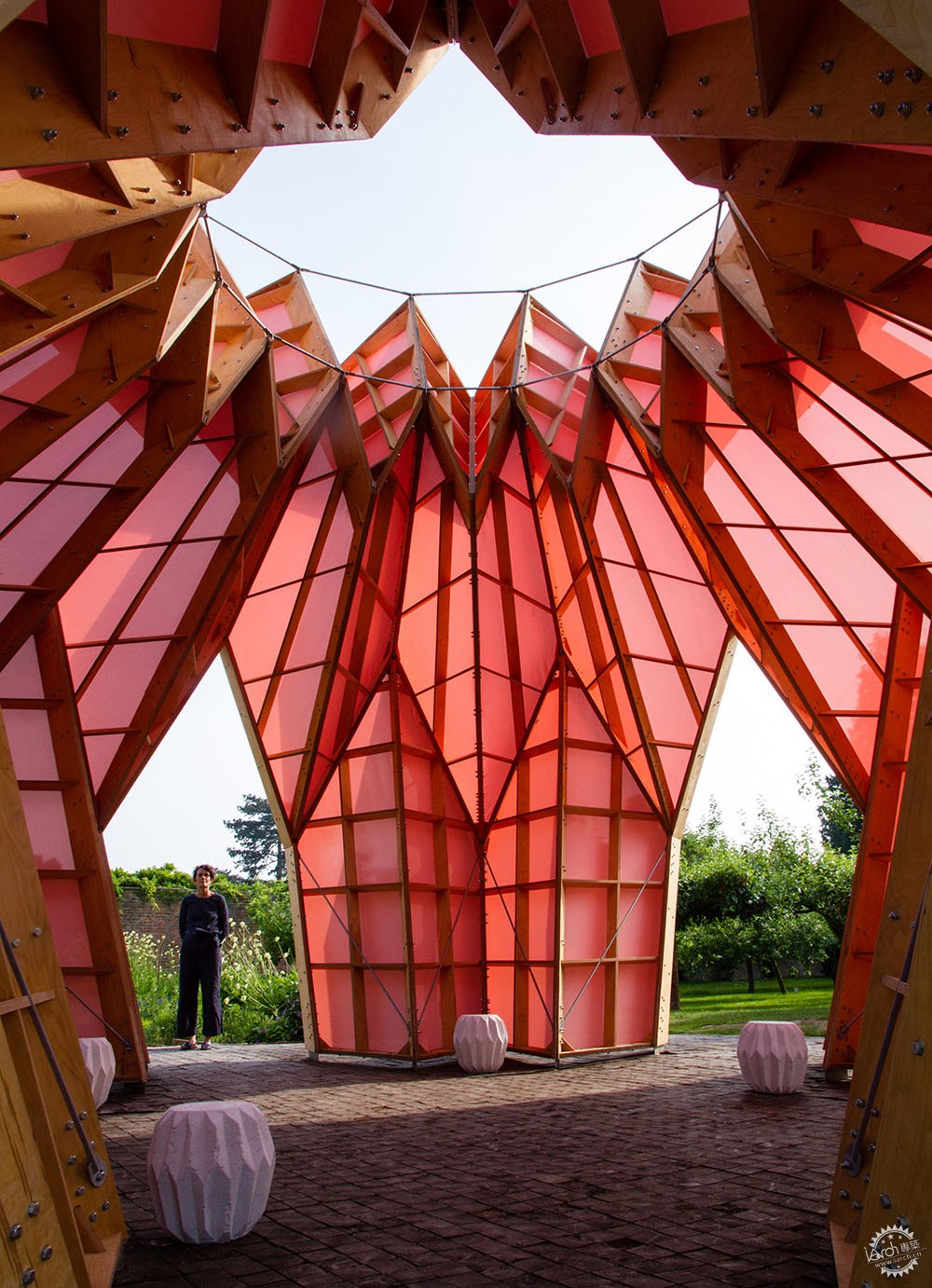

“我们的挑战是实现外部的装饰,让它拥有完美平整度,并且在折叠的边缘有卷曲度,这些在原始的纸模型中展现出来,”艺术家说。特殊的半透明织物能够承受所有的天气情况,让光线到达空间内部。Heather和Morison从格鲁吉亚的传统色调中选择了引人注目的粉色,这种颜色也用于大厅的室内装饰。“艳黄色的人造大理石”和“浅粉色”用于室内的陶瓷制品和门周围中,它们提供了色彩的灵感。
"Our challenge was to achieve an exterior finish that had the perfect flatness of facets, and the crispiness of fold edges, that are present in the original paper model," said the artists.  Able to withstand all weathers, the special woven fabric is also semi-translucent, allowing light to shine through to the space inside.  Heather and Ivan Morison chose the striking pink colour from a traditionally Georgian palette, also found in the interior decor of the Hall itself. The 'gaudy yellow scagliola' and the 'dusty pinks' present in the ceramics of the interior and its door surrounds provided the colour inspiration.
