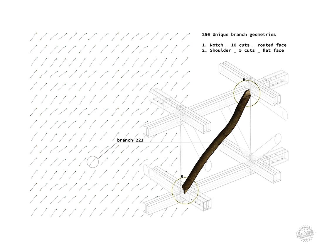

学生们与Arup工程公司合作,应用计算机技术辅助将这些不规则的木制部件设计到结构中。每个组件都经过扫描,在计算机中建模,然后再使用机器手臂切割出每个连接区域。
田野站亭顶的张力杆将桁架结构保持在压缩状态,使屋顶在四周向外悬挑三米。
设计团队表示:“这种技术创新能够容纳材料的离心性,展示先进制造技术如何与自然、不规则的材料协调一致,从而创造可扩展的建筑解决方案。田野站作为一个理想化的模型,展示了现代建筑对林地管理和碳封存的积极贡献潜力。”
Working with engineering firm Arup, the students used computer-aided design to incorporate these irregular wooden components into the structure.
Each component was scanned and placed into a computer model before areas for each connection were cut using a robotic arm.
The canopy's tension rods hold the truss structure in compression, allowing the roof to cantilever outwards by three metres on all sides.
"This technological innovation accommodates material eccentricities, and showcases how advanced manufacturing techniques can be harmonised with natural, irregular materials to create scalable architectural solutions," said the team.
"Field Station stands as an aspirational model, demonstrating the potential of modern architecture to contribute positively to woodland management and carbon sequestration."
