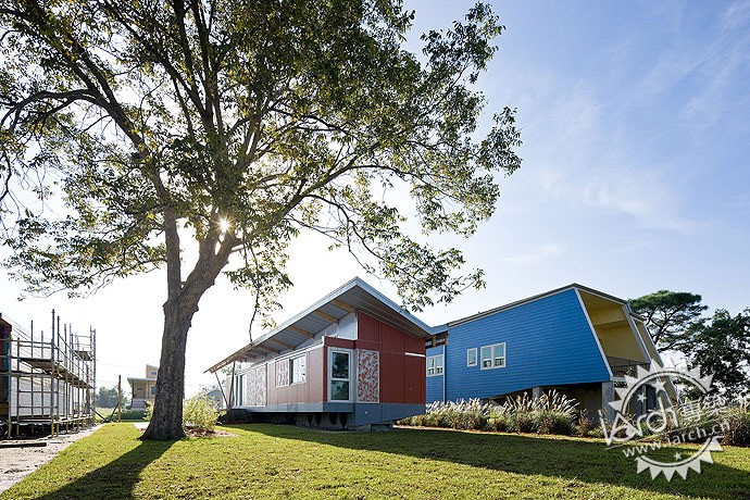

The FLOAT House is a new kind of house: a house that can sustain its own water and power needs; a house that can survive the floodwaters generated by a storm the size of Hurricane Katrina; and perhaps most importantly, a house that can be manufactured cheaply enough to function as low-income housing.

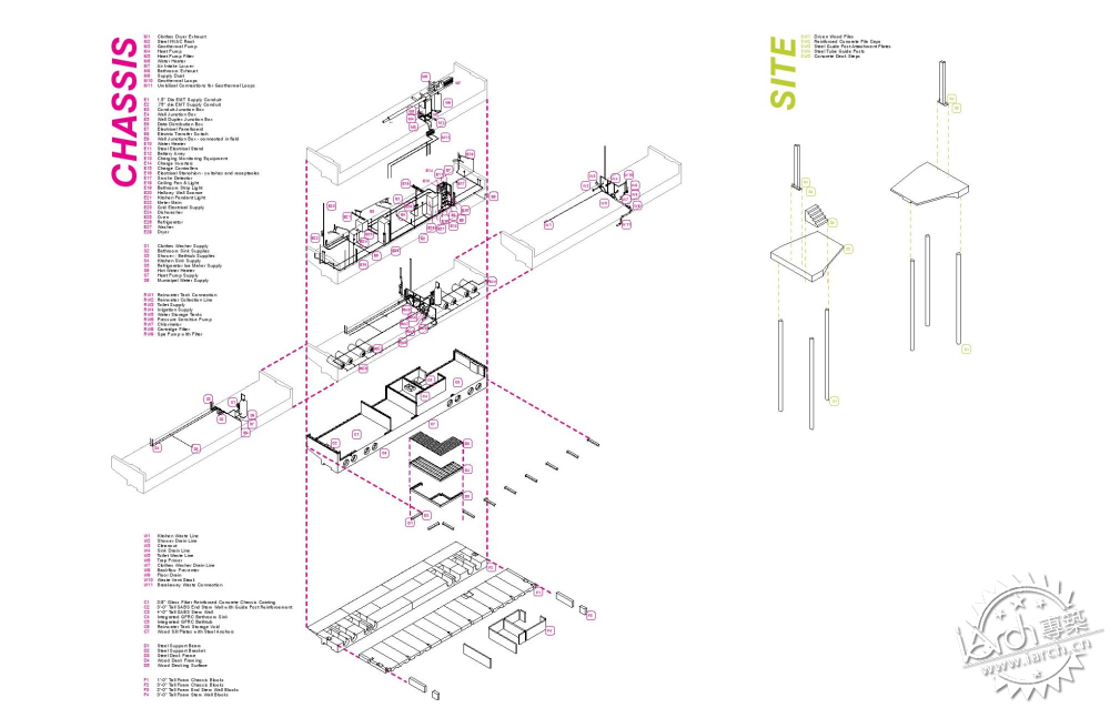

The FLOAT House optimizes the efficiency of mass-production, while respecting New Orleans’s unique culture and context. The Ninth Ward’s colorful vernacular houses, which local residents have traditionally modified and personalized over time, reflect the community’s vibrant culture. The FLOAT House grows out of the indigenous typology of the shotgun house, predominant throughout New Orleans and the Lower Ninth Ward. Like a typical shotgun house, the FLOAT House sits atop a raised base. This innovative base, or “chassis,” integrates all mechanical, electrical, plumbing and sustainable systems, and securely floats in case of flooding. Inspired by GM’s skateboard chassis, which is engineered to support several car body types, the FLOAT House’s chassis is designed to support a variety of customizable house configurations.
“漂浮住宅”在反映新奥尔良地区独特文化环境的同时,也满足了大量性建筑的高效性需求。第九区的色彩鲜艳的本地住宅,在当地人日复一日的生活改造过程中,反映出生机勃勃的当地文化。“漂浮住宅”就是在这些占据整个新奥尔良和第九区的当地住宅的独有形式中发展出来的。如同典型的当地住宅一样,“漂浮住宅”也建造在一个抬起的基座上。这种创新性的基座——也可称之为“底盘”——将所有的机械设备,电器设备和管道,可循环系统,以及抵抗洪水的安全浮力设施都囊括在内。
“漂浮住宅”的“底盘”被设计用来承担多种住宅需求,这个概念是由通用公司的“skateboard chassis”概念所启发出来的——即一种可承担多种车身的样式的汽车底盘。

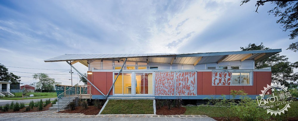

Developed to meet the needs of families in New Orleans’s Lower Ninth Ward, the FLOAT House is a prototype for prefabricated, affordable housing that can be adapted to the needs of flood zones worldwide. The FLOAT House is assembled on-site from pre-fabricated components:
正式为了新奥尔良地区的下九区的住户考虑,“漂浮住宅”是一种可以预制组装的建筑形式,并且其可以满足全世界洪水威胁地区的需求。

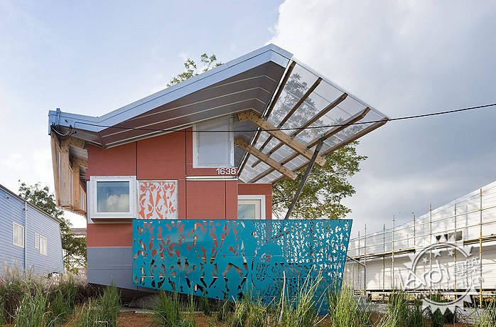

The FLOAT House – Make it Right / Morphosis Architects第4张图片
The modular chassis is pre-fabricated as a single unit of expanded polystyrene foam coated in glass fiber reinforced concrete, with all required wall anchors, electrical, mechanical and plumbing systems pre-installed. The chassis module is shipped whole from factory to site, via standard flat bed trailer.
模块化的底盘是预制的高聚物泡沫塑料单元,外层赋以玻璃纤维加固的混凝土材料,提前安装了所有必需的墙体锚固件,电气设备以及管道系统。我们可以方便地用普通平板车把这种底盘模块从工厂整体地抵建筑基地。
The piers that anchor the house to the ground and the concrete pads on which the chassis sits are constructed on-site, using local labor and conventional construction techniques.
而用来将建筑锚固至地面的基础以及用来放置建筑“底盘”的混凝土平板则可以利用当地传统的技术和劳动力建造。
The panelized walls, windows, interior finishes and kit-of parts roof are prefabricated, to be assembled on-site along with the installation of fixtures and appliances. This efficient approach integrates modern mass-production with traditional site construction to lower costs, guarantee quality, and reduce waste.
建筑墙板,窗户,室内覆层以及屋顶单元也是预制模块,它们同建筑内的家具一起被同时组装起来。这种高效的手段结合了现代技术的批量化生产和传统的建造工艺,最终降低了建筑成本,确保了建筑质量同时也减少了建筑垃圾。
