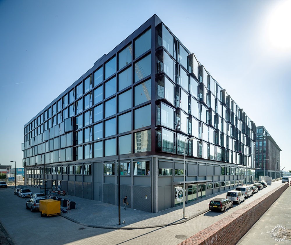

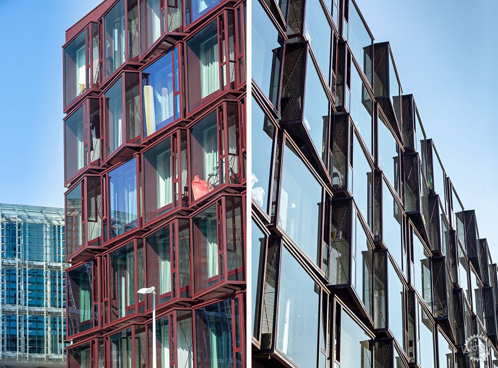

与特色建筑师Ludo Grooteman一起设计了一个双层玻璃和铝幕墙。每个工作室都有一个热立面和一个声学立面,后者提供外部气候,同时显著降低噪音水平。因此,所有学生都有一个额外的凸窗,用来放松或其他活动。由于所有的凸窗都朝向海滨旋转,因此形成了一个粗糙的、鳞状的立面。
Together with specialists architect Ludo Grooteman developed a double glass and aluminium façade. Each studio has both a thermal façade and an acoustic façade, the latter providing an exterior climate while reducing the noise level significantly. Thus all students have an extra bay window for relaxing or other activities. As all bay windows are rotated towards the waterfront it results in a rough, scaled façade.

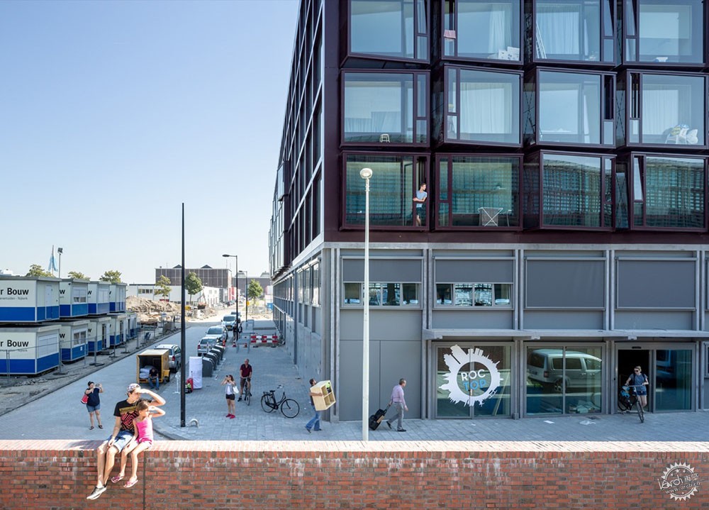

学校用双层柱基划分。内部空间高达5.6米,基座足够宽敞,同时双层混凝土夹着凸窗给它带来了强烈的表达。与棕红色刻面顶部一起,建筑获得一种适合该地区的自主性。它连接到强大的工业遗产古迹,同时也产生了自身的自主表达。
The school is allocated in the double storey plinth. With interior spaces of up to 5,6 meters height, we made the plinth spacious, while double concrete columns sandwich bay windows and give it a robust expression. Together with the brown-red facetted top the building obtains a sort of autonomy that suits the area well. It connects to the strong industrial monuments while having its own autonomous expression.
