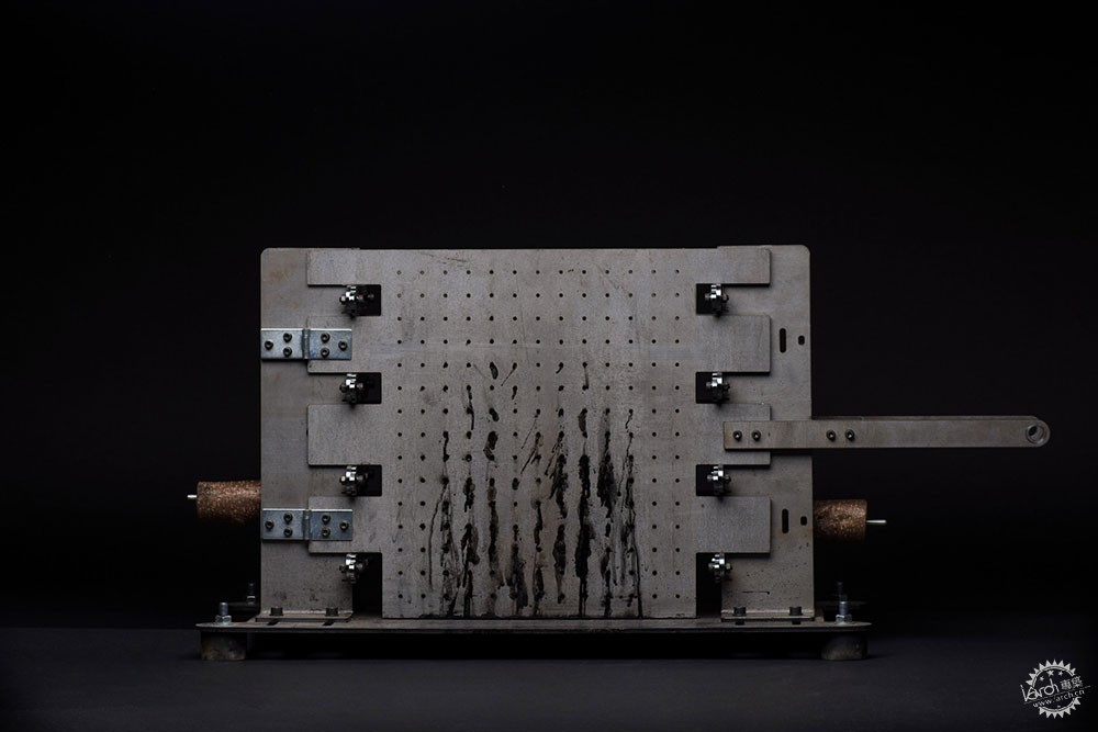

瑞典设计师Jonatan Nilsson用金属板和木块自制了一台机器,创造了Shifting Shape系列玻璃花瓶,这些花瓶的边缘呈锯齿状,表面有波纹。
Nilsson找不到足够灵活的玻璃烧制模具,于是便自己动手制作了机器,并创造了Shifting Shape系列花瓶。
这位来自斯德哥尔摩的设计师将木块切割成锯齿状,然后将它们以不同的形式堆成两堆,并固定在两边的金属板结构上。
不同的木块固定在金属板上会形成不同的结果,因为木头的形状决定了花瓶的成品形态。
Swedish designer Jonatan Nilsson built his own machine from sheet metal and wooden blocks to create this Shifting Shape collection of glass vases, which feature jagged edges and rippled surfaces.
After failing to find a flexible-enough mould for glassblowing, Nilsson put together his own machine to create each vase in the Shifting Shape collection.
The Stockholm-based designer used a band saw to cut shapes into wooden blocks, before stacking them up in different formations in two piles and securing them to the sheet metal structure on either side.
Different pieces of wood can be fastened to the metal sheets to offer varied results, as the wooden shapes give the vases their finished form.
不规则的工艺品制作困难?可变化模具了解一下第2张图片
机器的门可以在铰链上移动,使用者可以来回滑动木块,一旦门关闭,木块就被被推到一起,两堆木块之间形成一个中空空间。
滚烫的液态玻璃正是从这个空隙中插入并吹制,设计师与一位经验丰富的玻璃吹制者合作,创造出最终的产品。
The machine's doors move on hinges, allowing the user to slide the wooden shapes back and forth. Once the doors are closed, the wooden blocks are pushed together, but a hollow space is left in-between each stack.
It is this gap that the hot mass of glass is inserted into and blown. The designer worked with an experienced glass-blower to create the final products.

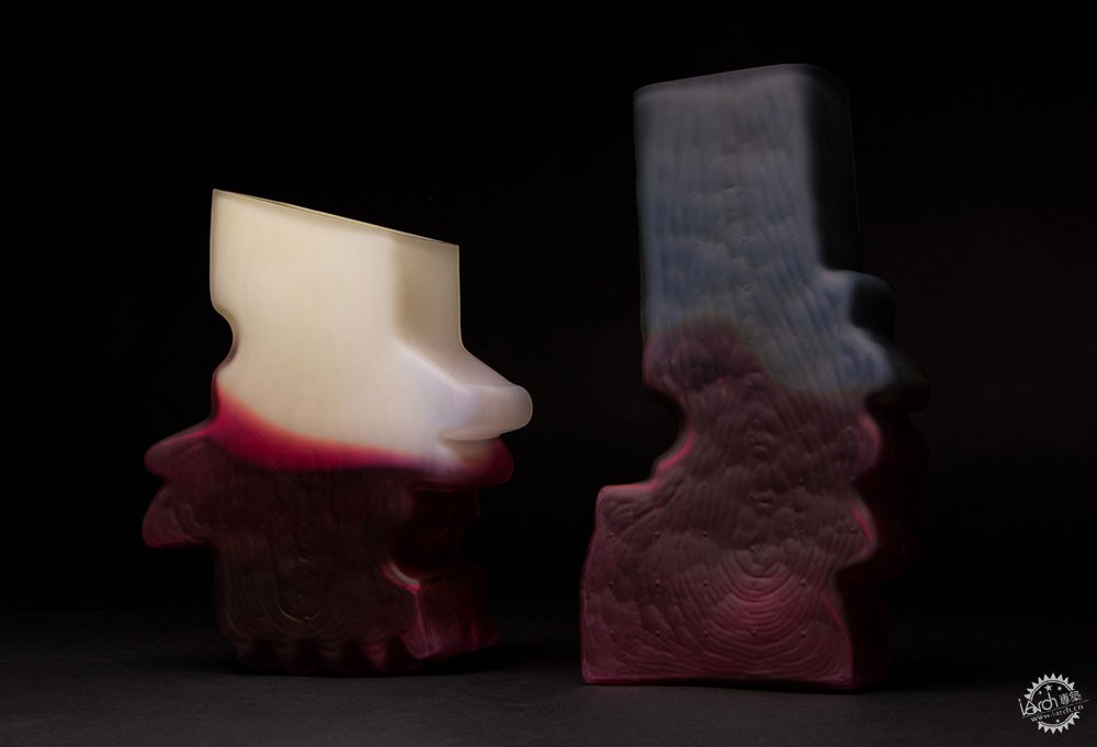

这些花瓶有的边缘呈锯齿状,有的呈阶梯状或波浪状。每件花瓶的正面和背面都是平整的,巧合的是,表面柔和的波纹看起来像是天然的木质纹理。
设计师解释说,这种效果是玻璃被吹向冰冷的金属表面的结果。
Some boast jagged, serrated edges while others have stepped or wave-shaped sides. The front and back of each vessel is flat, and features a soft rippled texture that, coincidentally, looks like the imprint of natural wood grain.
This effect, however, is the result of the glass being blown against a cold, metal surface, the designer explains.
