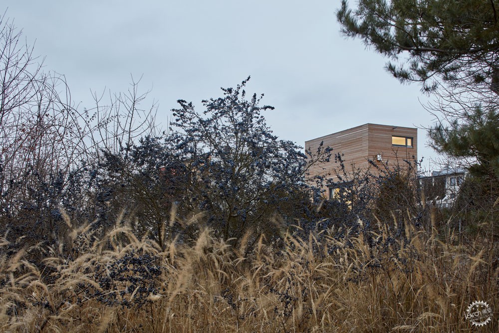

符合柯布西耶五项原则的生态装配式个体小木屋第1张图片
61号生态住宅
Freedomek No.061 / Atelier Stepán, Freedomky
由专筑网王沛儒,李韧编译
来自建筑事务所的描述。“61号”是代表Freedomek住宅项目的门牌号,这座建筑的建造时间是从上午7点到下午3点,这令邻居们感到惊讶,后来还建造了车库和露台。工人们将模块堆叠在一起,较小的体量S(4 x 7m)置于较大的体量M(4 x 115m)的上面。

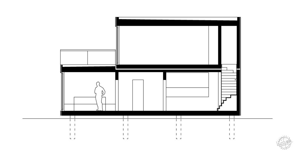

61号住宅木材占用了95%。它的轴承结构用胶合木制成,还有根据瑞士专利制作了精确的连接点,把连接关节做成梯形的形状非常简单,但它们的强度很大。保温材料由木质纤维保温板组成,白天和晚上都具有良好的功能效果。开放的建筑立面由北部落叶松木制成。
The “Sixty-one” is 95% wooden. Its bearing structure is from glued wood and has exact joints made according to a Swiss patent. Exact milling of the joint into the shape of a trapezoid are made very simply and their strength is immense. The insulation consists of wood fibre insulation panels that have a beneficial faze shift of day – night. The facade is diffusionally open, made of northern larch.

建筑通过辐射板供暖,局部调理通风,窗户带有三层玻璃面板。建筑安置在五条地基上,室内主要为白色和木色,真实地反映了建筑的主要材料。家具由桦木胶合板制作而成,其中有着隐藏的硬件,地板和楼梯则由坚实的橡木制成。
The house is heated by radiant panels, ventilated through local recuperation, and windows are wooden with a triple glass panel. The house sits on five ground foundation strips. The interior is white and wooden and reflects the main construction materials of the house. Furniture is made of birch plywood with hidden hardware, the flooring and staircase from solid oak.
