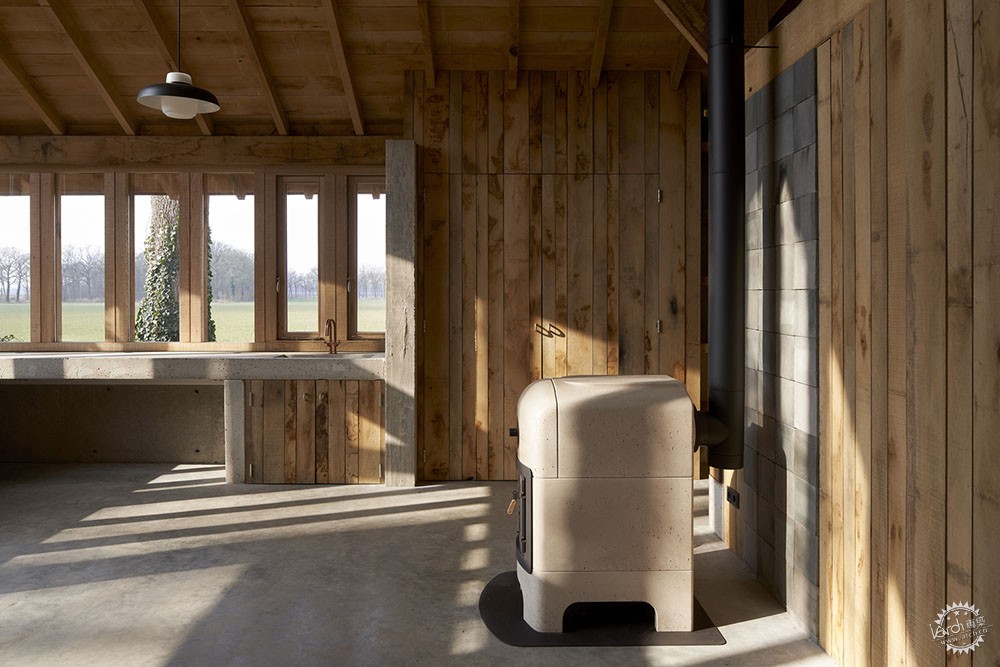

我们新建的横向谷仓由四根拉杆所组合的桁架构成,由纵向拉杆进行连接并在顶部由椽子支撑连接。在屋顶陡峭而低矮的一侧,是不对称的几何形状。谷仓内共有三个空间:车库,储藏室和供办公室使用的工作间或会议室,储藏室上方的阁楼空间向工作间开敞。
Our new transverse barn is constructed with four tie-bar couple trusses that are connected by longitudinal stringers topped by a roof supported by rafters. The roof has an asymmetrical geometry with a steep and a low pitched side. There are three spaces inside the barn: a carport, a storage room and a workshop/meeting room for office use. The loft above the storage room is open to the workshop.

一台移动式的锯木设备放置到院子中,用来将新鲜的树干切割成用于框架和屋顶结构的木材以及用于立面的木板。为此,我们使用了树木核心部分最优质的木材,并为其余不耐用的部分寻找合适的用途。比如,带树皮的支柱被用作挡板条来保护车库的玻璃,树皮与混凝土混合在一起构建端壁,以便与树木繁茂的环境融为一体。软边木材板被用于制作混凝土模板以塑造新鲜木材的印记;短木头被劈开并用作屋顶瓦片,劈开木材的粗糙度确保了未经处理的屋面可以保持数十年。最后,剩余的木材被切碎并堆放在谷仓凹进的北立面中以便生火。
A mobile sawmill was brought to the yard and used to cut the fresh tree trunks into structural timber for the frames and roof as well as planks for the façades. For this we used the best quality wood from the trees’ core sections and went in search of suitable uses for the remaining, less durable parts. Stanchions with bark were employed as slats to shield the glazing in the workshop and carport. Bark was mixed with concrete to construct the end walls so they would blend in with the wooded environment. Soft sapwood planks were used for concrete formwork to mould the imprint of fresh wood. Short lengths were cleaved and used as roofing shingles. The roughness of this cleaved timber ensures that this untreated roofing will last for decades. And finally, the rest was chopped and stacked for firewood in the barn’s recessed north façade.

未经处理的木材,混凝土和玻璃以各种方式混杂在一起,用于建造模板的木材,其不规则的尺寸产生了自然质感的混凝土表面效果。边材模板的残留物嵌入混凝土和单宁酸中。树木中的钢铁夹杂物,如铁丝网和弹片,可以追溯到1944年,但这些恰恰给木材带来了不完美的美感。这些额外的情况在木材和混凝土中产生了意想不到的效果。
Untreated timber, concrete and glass have been intermingled in various ways. The irregular dimensions of the wood used to build the formwork resulted in far from perfect concrete surfaces. Remnants of the sapwood formwork became embedded in the concrete and tannic acid from the fresh timber left discolorations. Iron and steel inclusions in the trees, such as barbed wire and shrapnel, presumably dating from 1944, brought imperfections to the timber. These additional circumstances created an unexpected layer of traces in wood and concrete.
