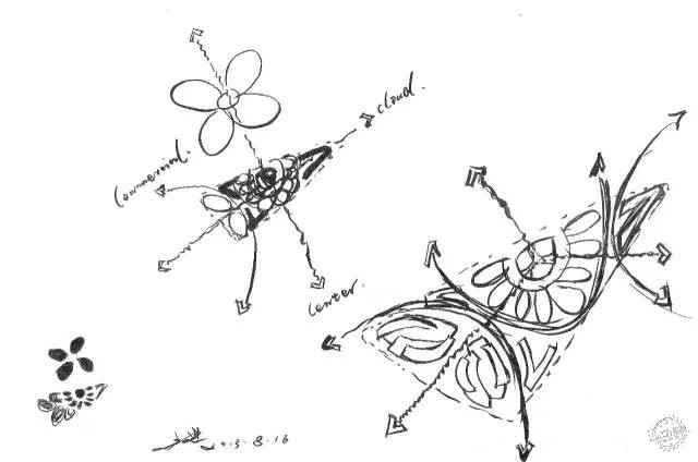

概念生成手绘稿Conceptual sketches
同时,花瓣、花叶的多层独栋办公建筑设计形态,既使地块密度适中,易于营造舒适环境,又使单层建筑面积符合中高端企业的使用需求,符合了业主对后期运营的要求。
These independent multi-floor office buildings are constructed in the shape of petals and leaves to ensure enough spaces among architecture, creating comfortable environment. Meanwhile,the floor area is guaranteed to fit the needs of future high-end enterprises as well as the operation demands for client.

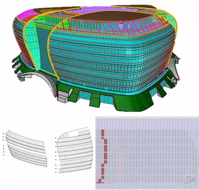

而在考虑建造的需求时,曲面玻璃并非最佳的选项,更多的模板,更高的成本,都是施工精度、现场进度与工程造价无法承担的。如何把8949片玻璃尽量控制在少数几种尺寸规格,并且保证这8949片玻璃能一块块准确安装到龙骨上?设计团队接下来做的工作看起来不像是建筑师习惯做的画图匠,而是化身数学家。因为不可能一片一片的来绘制设计,必须要通过参数化的方案得到批量处理,通过Rhino、grasshopper等,进行了大量的数据运算与核对,动态的观察调整规格后的效果,设计师们才终于将建造和设计紧密的联系在一起。
In this project, curved glass is not the best option to the whole construction process. Because it represents more modules, higher cost, and unmanageable construction precision, schedule control, and budget. How to reduce the sizes of 8949 pieces of glasses to the least available numbers and make sure them set accurately on the fixed keel? The architecture design team seems to take the role of mathematicians to batch the data through parametric modeling of Rhino, grasshopper. After enormous data operation, crosscheck, flexible adjustment, the architecture and design were closely intertwined in the end.
绽放的向阳花 • 虹桥世界中心第23张图片
幕墙玻璃分割定位The partition diagram of glass curtain wall
为了建筑的建成效果,为了帮业主控制预算,设计师针对8949片玻璃提供了详尽的设计数据。建成效果玻璃幕墙圆润平滑如设计师所愿,造价也控制在了业主的预期当中。
Designers elaborated specific data for 8,949 pieces of glass, with the aim of achieving better performance whilst controlling budget. And it eventually comes out that both the smooth surface of glass curtain walls and the construction cost meet designers and owners’ expectations.

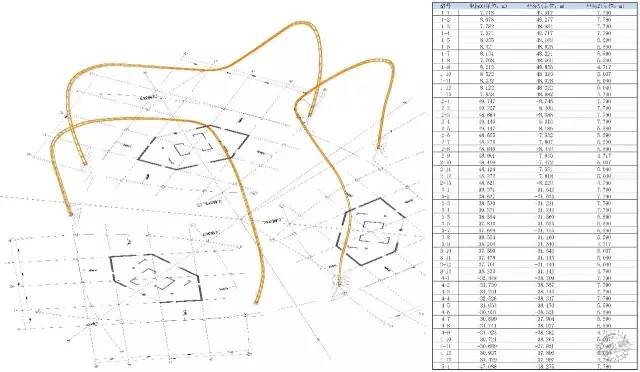

设计师顺着曲面玻璃扭转的方向做了一根不锈钢的象牙,像立体的雕塑一样从草坡直升到45.00米的标高,转了90°的转角向花心的中间汇聚过去。
An ivory-shaped stainless steel is customized along the twisted way of curved glass. The 45-meter high sculpture ascends from the lawn and turns at an angle of 90 degree at the apex, facing towards the center part.
象牙的空间形态首先被建立在Rhino模型中,然后被转化成594片不锈钢板材,定位每一片的四个角点,2376个角点数据。而单单从平面上是无法充分定义象牙的,因为同层的不锈钢板角点并不在同一标高上。所以还要增加了高程的信息输入进去,才能最终准确定位象牙形态。
Initially set up by Rhino, the pattern of ivory was divided into 594 pieces of stainless steel panels with four angular points noted, marking a total data number of 2,376. However, the ivory-shaped stainless steel could not be defined only in plane dimension. Stainless steel plate in the same floor are actually not in the same height, so elevation information should be imported to define the ivories.

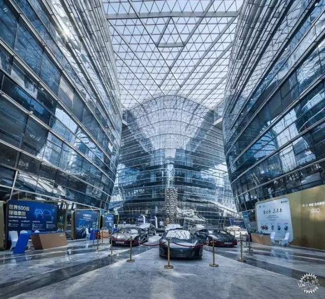

与往常设计的办公建筑相比,花心“人”字形的中庭系统是个很重要的特点。一般来说,办公建筑的中庭都是独立于建筑内部,而花心的中庭通过三片悬索玻璃幕墙形成,一片正对国家会展中心,另两片则与场地内的轴线相呼应。当人站在大厅中央穿过通透的玻璃幕墙向外望去,两边则都是被精心设计的对景。
The most distinctive feature of the courtyard that differs considerably from typical office buildings is the inverted V-shape. Most courtyards of office buildings are separated from the surrounding construction.Yet the one in this heart part is encircled by three cable-suspended glass curtain walls. One of them faces towards the direction of NECC, and the other two walls echo with the axis of the field. The lobby also offers well-designed opposite scenery views across the transparent glass curtain.
绽放的向阳花 • 虹桥世界中心第29张图片
花心大堂实景The lobby

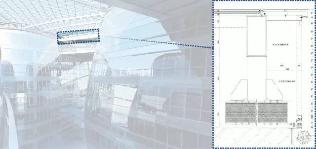

但是,这却给机电设计带来了很大的难题。在展览建筑、交通建筑中用于大空间的空调系统放在这座办公楼里是不适合的。而且为了提高大厅的亮度,顶部也被设计了整体的玻璃天窗,那么在顶部增加设备系统的可能也被否定了。
Thus, electromechanical design faced a serious challenge. It is totally unsuitable for this building to copy the air conditioning system worked in large space, such as exhibition building, transportation building. The glass skylight in the roof is designed to enhance the light condition of the lobby, yet it imposes limitations on adding more equipment systems at the top of buildings.
于是机电顾问提出了若干解决的建议,天窗增加电动开启窗?或者悬索玻璃增加电动开启窗?但是前者造价高昂,维护困难,考虑到踩着玻璃过去检修的话,对玻璃的荷载要求又要上升一个档次。后者的话悬索幕墙上面加开启扇窗框效果就像锦衣上打了补丁,也是不可取的。这个时候的建筑师让人觉得吹毛求疵,各种可能性在他们眼里都有着这样那样的缺点需要规避,必须要有百无一失的方案才能被认可。
The counselor for electro-mechanism put forward several proposals, including the attachment of electronic opening windows to the skylight or the cable-suspended glass. However, the former solution would cost a fortune to construct and maintain, let alone improve the load bearing capacity of the glass because repairmen need to step on it. It was also inadvisable to choose the latter one, because the outcome would appear like a poor patch on the finery. Architects at this stage fastidiously pick every potential hole, and only a perfect scheme would be approved.
最后空调机电被设在一个人的视线里不会被看到的位置,只有从剖面和节点图中才能一探究竟。设计师将天窗整体抬升了1100mm的距离,然后向外侧偏移1500mm,让人在中庭看不到天窗的边缘,将空调体统置于此处,隐藏了起来。
So, where did the system eventually settle on? At a blind corner where we can discover only in the section and node program. Designers have elevated the height of skylight by 1,100 mm and moved outward by 1,500 mm to block the view of skylight’s margin, where is exactly the hideaway of air conditioning system.
绽放的向阳花 • 虹桥世界中心第30张图片
百叶位置示意The location of shutter

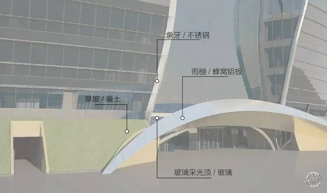

在花心主入口的月牙雨棚这里,象牙,草坡,玻璃采光顶,四样材质,四种构造拥在了一处,如果不谨慎处理,建造腐蚀、漏水等许多问题。
Four materials converge at the main entrance, including crescent canopy, ivory-shaped steel, lawn, and glass skylight. A barrage of underlying problems would arise due to incautious treatment, such as erosion and leakage.
对待草坡和月牙雨棚得交接,设计师采用了“划清”界限的做法。本来覆土、植被和金属就是不宜相互接触的材料,混在一起时间久了腐蚀漏水都是问题。于是设计师划了一条沟,做好了排水的措施,让覆土能被边缘截住,让蜂窝铝板也在这里收头,两者隔开150mm,看似很近,实则不会接触。
There is a clear boundary between the lawn and the crescent canopy. Soil, vegetation and metal are essentially different from each other, which we cannot blend them together for a long time, because of inevitable problems of erosion and leakage. Thus designers dug a 150-mm-width gutter to drain water off, and intercept both the soil and aluminum honeycomb plate.

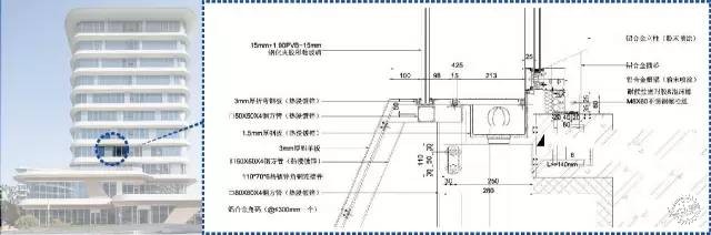

而象牙与采光顶的交接处,玻璃和金属近似垂直的相交到一起,玻璃本身也是有转折的角度,象牙恰好装在这个钝角上。形成了六个交点。怎么处理这个地方呢?
At the junction of the ivory-shaped steel and skylight roof, the materials of glass and metal meet at almost right angle. The curve of glass is at an obtuse angle with the steel installed, forming six points of intersection. Then, how to deal with this part?
玻璃和不锈钢都是可以精确施工的材料,设计师们在模型中提取了所有交接点的空间坐标,根据坐标制作玻璃与不锈钢的物料,幕墙设计好细部的构造,再根据构造反推模型虚拟建造查验错误,确认无误后工厂根据尺寸定值构件,然后现场安装,材料就精密的对接到了一起,严丝合缝。
Both glass and stainless steel are able to be constructed accurately. Designers collected all the data of spatial coordinates at the junctions of  the model, and accordingly elaborated every structure detail of curtain walls, including the materials of glass and stainless steel. Only when the materials pass simulation testing, relevant components with customized-size could be fabricated and assembled on the site perfectly.
绽放的向阳花 • 虹桥世界中心第33张图片
象牙交接示意The ivory diagram

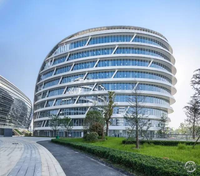

在方案的最初阶段,花瓣以及其他叶子的立面是由横向的白色铝板与玻璃组成的,单独一个建筑来看并无不妥。但是如果作为整体来看,就会发现这横向的线条一直绵延伸展,令人的视线容易疲惫,无法停留,于是设计师开始思考,如何给这冗长展开的立面上增添一些不一样的元素,使得人们的视觉焦点可以在这过程中跳跃起来,看到些有趣的元素呢?
The building façades in the shape of petals and leaves were originally planned to utilize lateral, white aluminum plates and glasses as components. However, taken as a whole, the transversal panels would guide people’s sight to a weary extent. Designers hoped to add some creative elements on the stretched façade and pull back people’s visual focus.
设计师首先在距离中央花心最近的花瓣上开始了实验,进行了多个方案的比选,最终,决定在玻璃幕墙外侧设计斜向立杆,由外向里密度渐变,体现出速度感。
Designers started tests at one of the petal-shaped buildings, nearest to the center part. They made a comparison of different pitches and determined to set slant poles outside the glass curtain wall with a density gradient from far to near, making people feel the sense of rhythm.

在此基础上进行设计深化,将斜撑的跨度定义成三片玻璃的宽度,从而减少了对于室内视线的影响,与层间铝板连接的部分倒了圆角,从而平滑的与铝板相接。留出少许的安装距离,容许了施工误差对平整度的影响。对斜撑的位置经过了反复的推敲之后,最终定下的136个斜撑单元一一排列在了每片花瓣之上。
Further design adjustments are made on the above basis. In order to reduce the impacts on indoor vision, the span of diagonal brace are designed to be equal to the width of three glasses, thus forming rounded corners with laminate aluminum plates. The construction errors would not affect the flatness because of short intervals. Based on a prudent analysis of position, the final 136 units of diagonal brace are arrayed regularly at each petal-shaped building.
