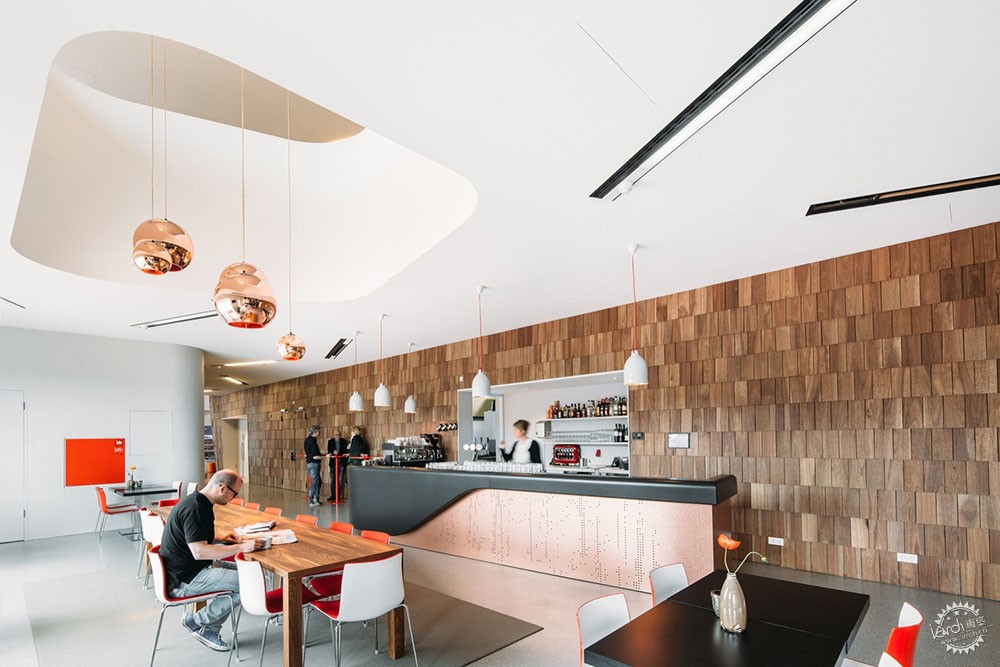

Klinker 文化中心通过生动的外部反映了项目本身富有表现力的本质。它位于Winschoten的中心位置, 使得市民很容易到达。市民能够享受电影院、艺术中心、无线电广播室、图书馆提供的“文化大餐”,亦或是在电影院咖啡馆的一杯风味咖啡。因此,当地居民积极地促进此城市的文化生活。
The Klinker Cultural Centre was given a lively exterior to reflect the expressive nature of its programs. Its central location in Winschoten makes it easily accessible to the residents who can enjoy the cultural offerings of the theatre, arts centre, radio studio and library, or savour a coffee in the theatre café. In this way, residents themselves actively contribute to their city’s cultural life.
