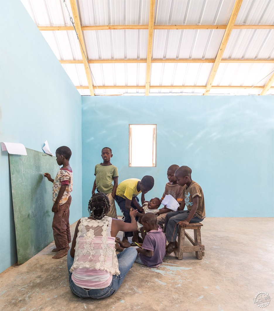

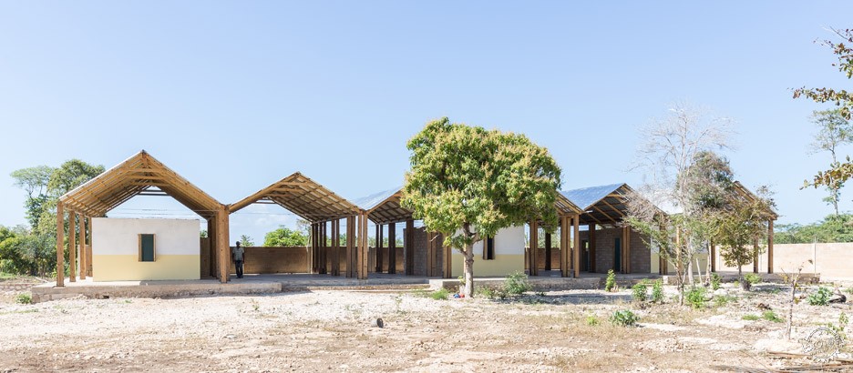

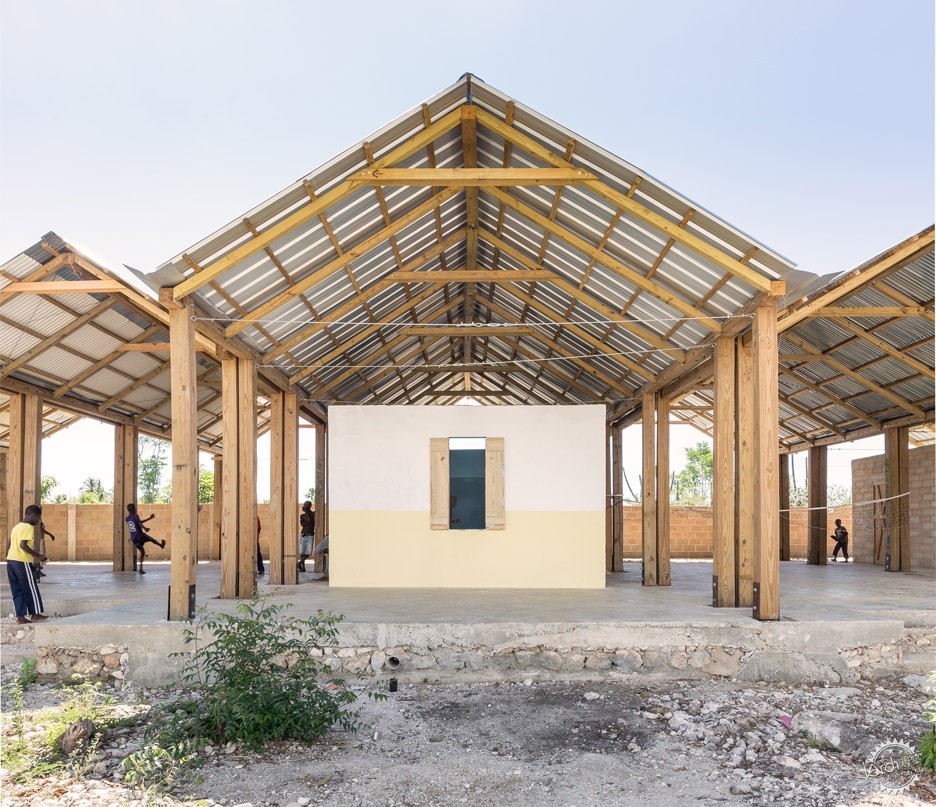

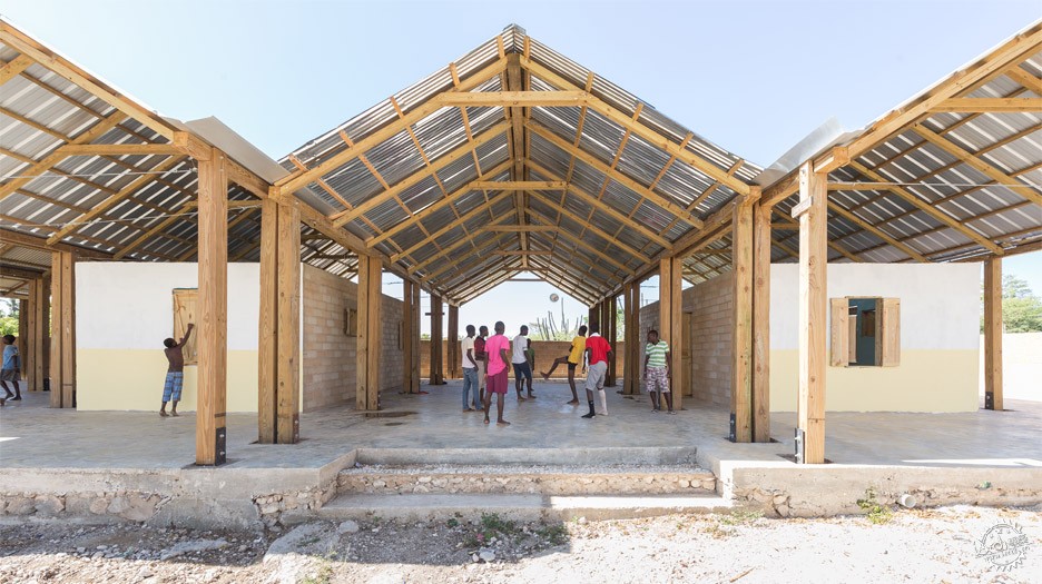

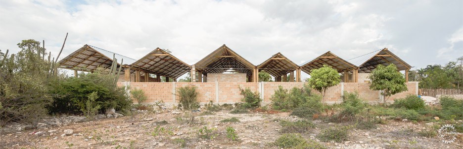

砖砌的集体宿舍没有天花板,被综合体的大屋顶覆盖在下方,大屋顶由6个独立片段组成。
The brick dormitories have no ceilings and are tucked beneath the complex's overarching roof, which is made up of six freestanding segments.
横跨海地孤儿院的独立式屋顶/ Bonaventura Visconti di Modrone第6张图片

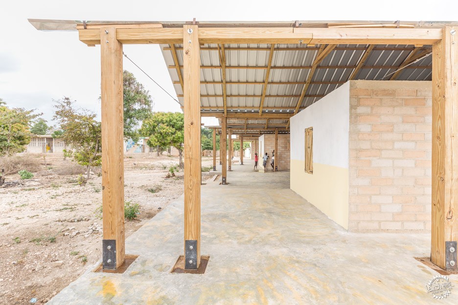

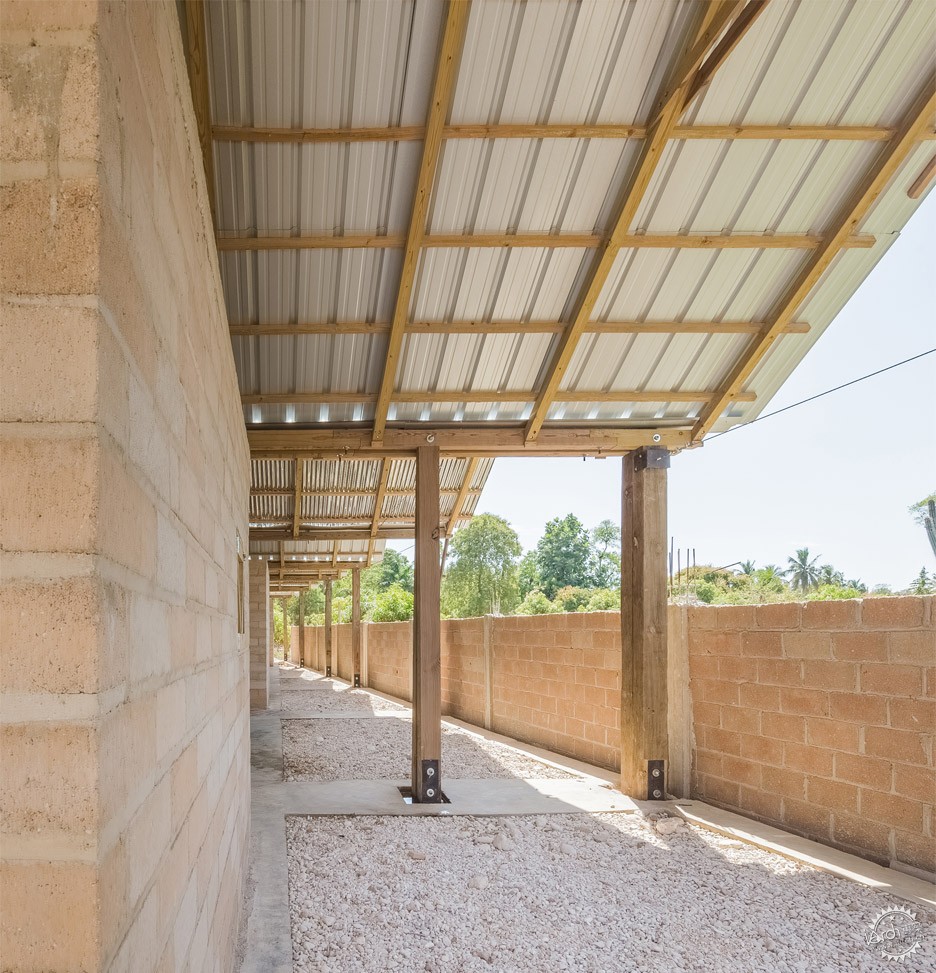

支撑屋顶的结构是用木材制作的——选择它是因为它灵活的性能——木材与砖砌墙体分离,以至于在该地区的地震频发期不会传递震感。
屋顶覆盖有涂层的铝板,这是因为它们既轻盈又具有耐久性,还因为当地的工作者早已熟悉这种材料。集体宿舍的墙壁由定制的砖建造。
The braced roof structure is made from wood – chosen for its ability to flex – and is detached from the brickwork so as not to transmit vibrations during the earthquakes the region regularly experiences.
The roofs are covered in cream-painted aluminium sheets, which were selected for their lightness and durability, but also because local workers were already familiarity with the material. The dormitory walls are built from custom-made bricks.

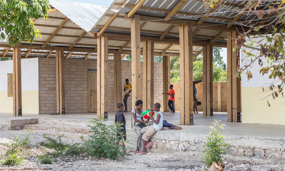

混凝土梁通过空心砖连通,进一步加强结构,蚊帐被悬挂在建筑物开敞的顶部。
设计的灵感来自于两种类型的民居——lakou四合院和农村住宅,它们的典型特征是阳台用装饰和坡屋顶覆盖。
Concrete beams are fed through hollows in bricks to reinforce the structure further, and mosquito nets are strung across their open tops.
The design takes its inspiration from two types vernacular housing – lakou courtyard houses and rural dwellings, which typically feature verandahs covered with decorative and pitched roofs.

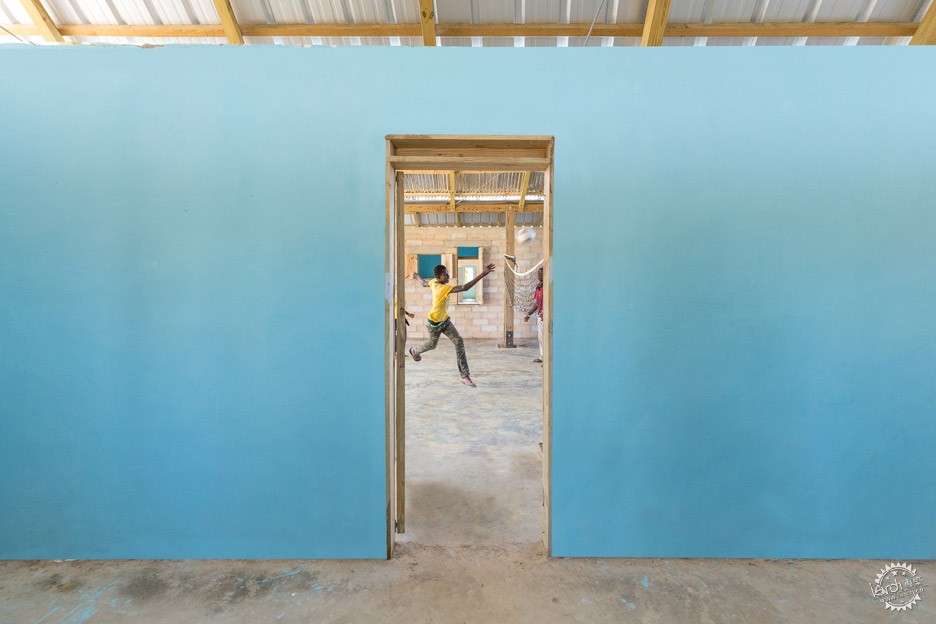

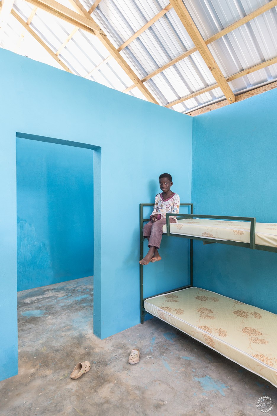

工作室收留了一些孩子住在综合体中,这也有助于确定设计元素,包括砖墙的颜色。
“这让他们未来的住所能够充分个性化,并且增强他们的归属感,”建筑师说。
Workshops held with the children who would live in the complex also helped to determine elements of the design, including the colouring of the brickwork.
"This helped them to personalise their future houses and strengthened their feeling of ownership," said the architect.

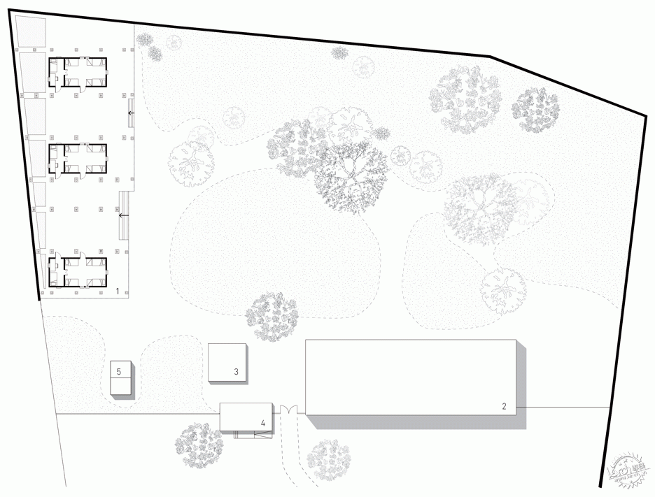

Site plan/场地平面图

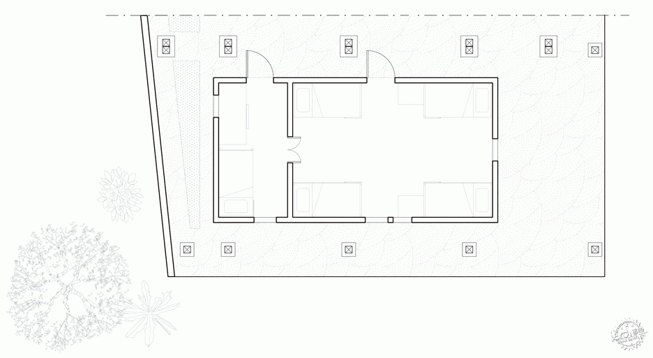

A typical room plan/房间平面图
