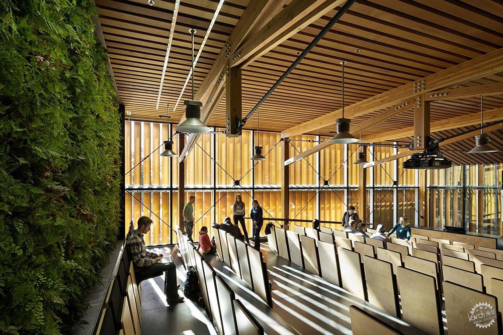

来自建筑事务所的描述:该会堂位于堪萨斯大学建筑系馆里,是为学生设计和建造。会堂满足美国绿色建筑委员会在能源和环境设计的最高标准,并获得2009年LEED铂金认证。这是美国绿色建筑委员会在新的可持续设计建设时采用的最严格的新建筑认证标准。这也标志着Studio804利用一些突出的建筑特色连续获得第七个LEED铂金级建筑认证。建筑包括一个独特的容积式通风系统。在温和的天气里,基本通风和室外通风两个系统的自然通风模式关闭,通过交叉通风来吸收新鲜空气并在整个空间进行循环。
From the architect. The Forum, located in the Architecture department of University of Kansas, was designed and built by students to meet the United States Green Building Council's Leadership in Energy and Environmental Design standard, LEED v2009 NC Platinum. This is the most stringent new-construction certification for sustainable-design that was in use by the USGBC during the building construction. It marked Studio804's seventh consecutive LEED Platinum building with several other outstanding architectural features. It includes a unique positive displacement ventilation system. On mild days during the year, the natural ventilation mode shuts down both the primary and outdoor air system, and cross ventilation is used to draw in fresh air through the space.

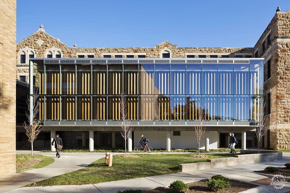

建筑的外表皮是由两片独立的绝缘玻璃构成的,外皮距地面3.5英尺。玻璃间的空间安置了雪松木质的百叶窗。建筑外层的顶部和底部设立了机动阻尼器,这样夏季可以将此打开,引入凉风,进行降温。百叶窗是由屋顶气象站控制的,并遵循着太阳的轨迹进行移动。蕨类和秋海棠构成了绿植墙,通过吸收和消散噪音为会堂进行了近一步的声音控制。另外垂直绿植墙通过水箱进行灌溉。
The perimeter skin is made up of two separate walls of insulated glass, three-and-a-half feet apart. The space between them provides room for the cedar louvers. Motorized dampers are located at the top and the bottom of the outer layer which permit cool air to enter in the summer when open. The louvers are controlled by a rooftop weather station and are programmed to track the sun. The living wall of ferns and begonias provides additional acoustic control for the lecture space by absorbing and dissipating sound and is watered from the cistern.

繁茂的植被通过过滤空气中的毒素,可以有效地改善室内空气质量。除了这些,LED灯、光伏电池板的安装、水循环和材料的回收使用也反映了建筑高效的可持续设计。建筑馆南侧室外工作室的拆除标志着建设的开始。现在的住房电力服务系统需要保持在持续运作的状态。最终,建筑师将加建的部分小心地安置在现有机械室的上部。机械室成为这个新的121座玻璃会堂和“陪审室”(入口处的公共空间)的基底。
The lush vegetation helps to improve indoor air quality by naturally filtering toxins in the air. Besides these, setting up the LED lights, PV panels, water reclamation and usage of recycling materials are the other great aspects of this building. The construction had begun with the demolition of an outdoor workshop on the south side of the Architecture building. The existing shed housing the electric services had to remain in continual operation. As a result, the addition was carefully built above the existing mechanical room, and this became the site for the new glass-enclosed 121-seat auditorium and a 'Jury room' with a big common space at the entry.
