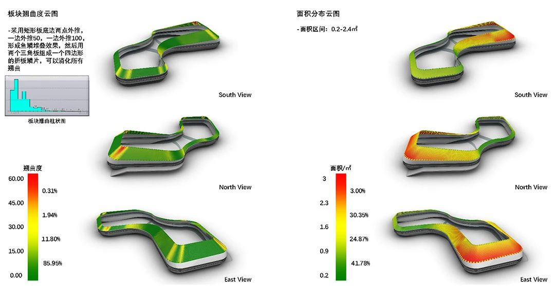

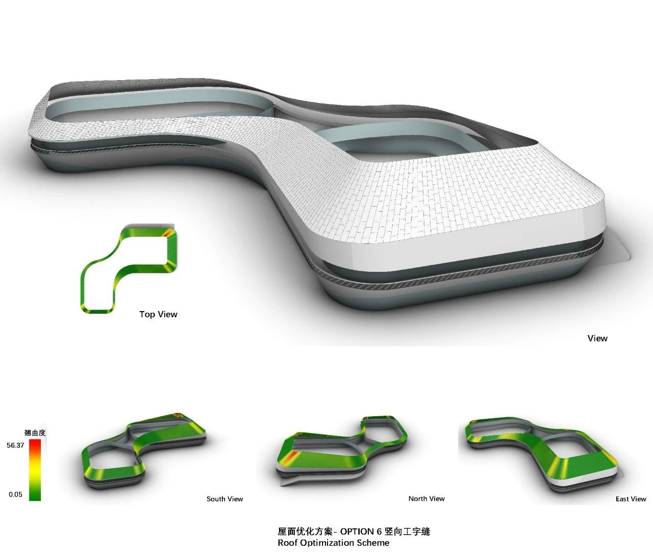

▲ 板块翘曲度云图与面积分布云图 Warping Cloud Diagram and Area Distribution Cloud Diagram ©零壹城市 LYCS
摆在设计团队面前的是经典的“三体”问题,三个互相牵引的要素,寻找动态平衡:
如何优化方案曲线?
如何设计幕墙单元?
如何控制建设成本?
于是,设计团队带着三大问题,开始了一场极限拉扯。

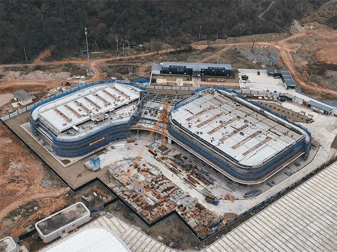

▲ 南鸟瞰建造过程-Construction-Process,-South-Aerial-View--©零壹城市-LYCS

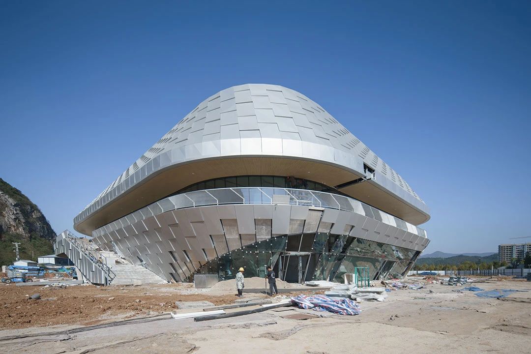

▲ 设计团队在现场 Design Team On-Site  ©零壹城市 LYCS
设计团队用顶面,斜面,垂面三个曲面重新梳理了上部立面的造型逻辑。设计方案让三面在两馆之间发生扭转,面与面之间肥瘦相间,释放了视觉张力。得益于新的造型使用更多的直线加倒角,三维非标曲面占比降低,造价得以降低。同时,与一期的体育馆造型也更加协调。
The design team restructured the upper façade’s geometry using top, inclined, and vertical surfaces. These surfaces twist dynamically between the two main venues, creating a visual tension with alternating convex and concave sections. By incorporating more straight lines with chamfers, complex three-dimensional curved surfaces were minimized, reducing costs and achieving better harmony with the adjacent arena.

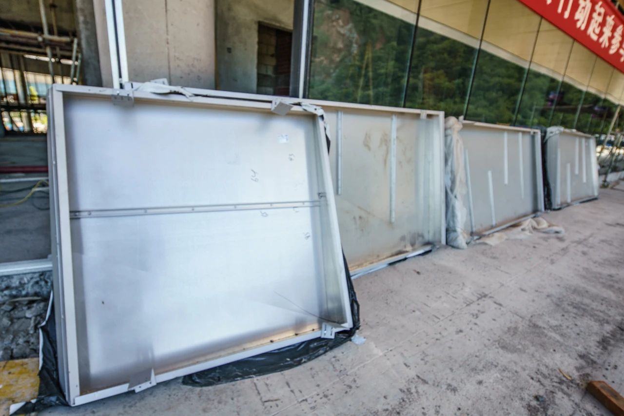

龙鳞加身的游泳馆第12张图片
▲ 单块幕墙金属板 Single Curtain Wall Metal Panel  ©零壹城市 LYCS

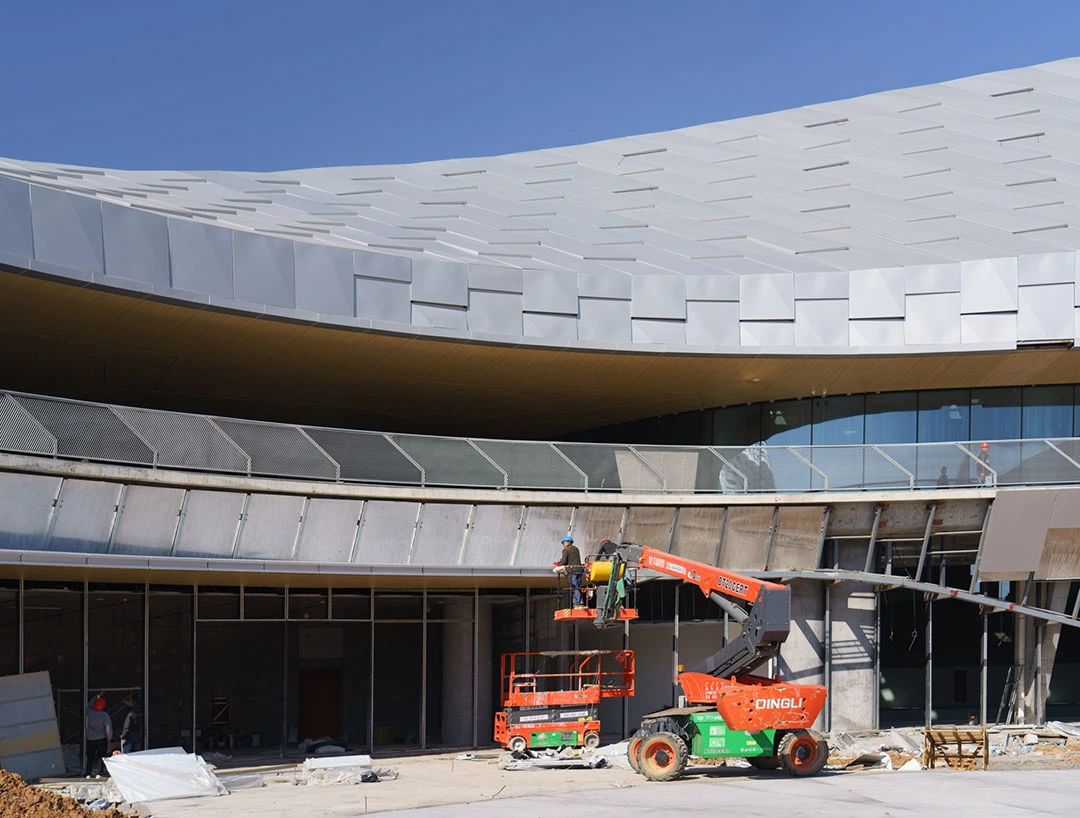

龙鳞加身的游泳馆第14张图片
▲ 幕墙单元安装过程 Curtain Wall Unit Installation Process  ©零壹城市 LYCS

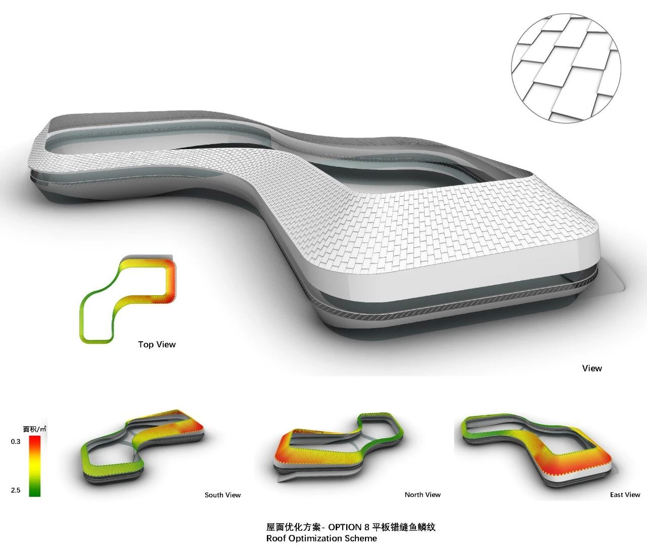

连续的立面是由一块块的幕墙金属板拼起来的。设计团队通过大量的案例研究,多方案比选,从横向工字、竖向工字、折板错缝、平板错缝、折板齐缝、折板菠萝纹等切分方案中,选择了兼顾造价与效果的折板错缝方案。
The continuous façade is composed of individual metal panels. After extensive case studies and iterative comparisons, the team selected a staggered folded plate pattern for its balance of cost efficiency and aesthetic appeal.

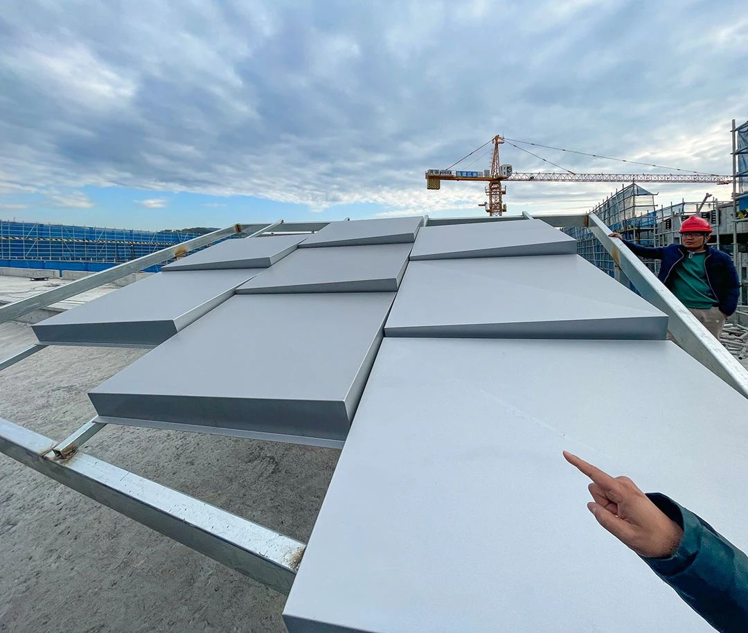

折板错缝方案的每块金属板上有一道折痕,随着光线变化,会产生一种优美的鳞片的效果。设计团队希望通过这道道折痕,在整体曲线之外,点线结合,给造型再增加一个视觉层次。
Each panel features a single fold, creating a scaly texture that interacts beautifully with changing light.These folds add a layer of visual complexity to the curves, integrating points, lines, and surfaces into the design.
龙鳞加身的游泳馆第24张图片
▲ 丰富视觉层次的折板“鳞片” Folded Scales with Rich Visual Layers  ©零壹城市 LYCS
短促不连续的折线分布于整座建筑,统一的斜度是造型成败的关键。为了保持斜度统一,在斜面与水平的各个交界面,设计团队选择了保持折线斜度的“切断”方案。
Uniform fold angles were key to achieving coherence across the façade. At the intersections of inclined and horizontal planes, the team maintained the fold angle with precise cuts, ensuring visual continuity.

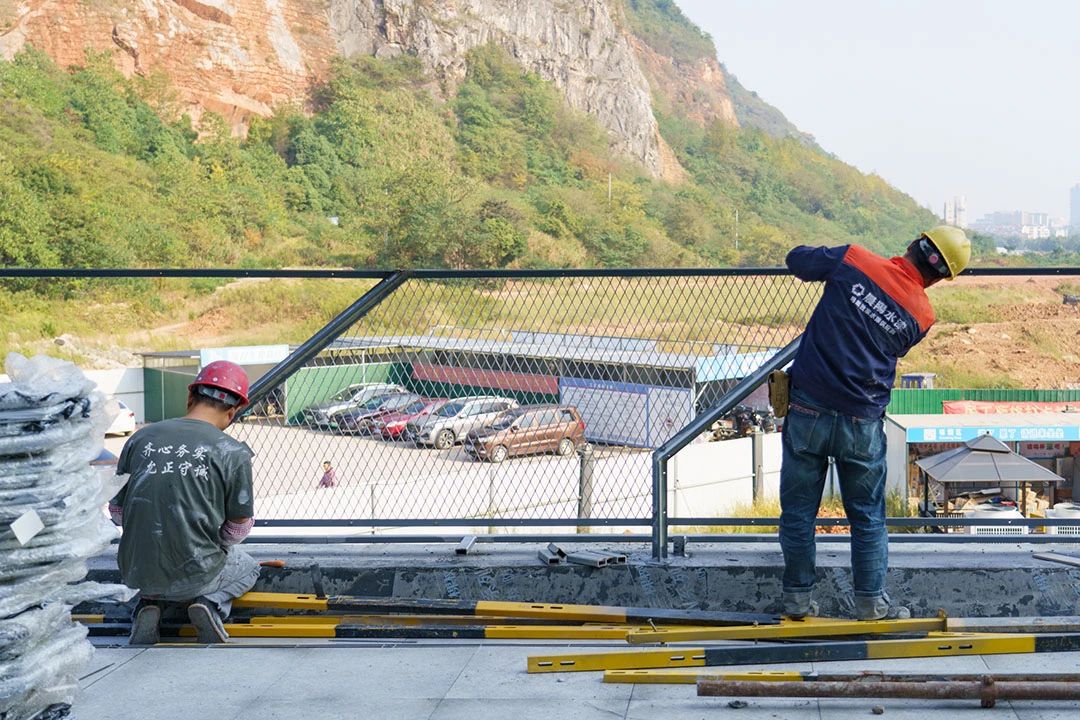

同时,在空中走廊部分,护栏在1/4以上倾斜,给走廊增加了一层微妙的速度感,也让上部立面,与下部基座,折线矩阵连接在一起。
With its guardrails tilted at over 25%, the aerial corridor adds a subtle sense of speed, linking the upper façade to the lower base with a unified matrix of folds.
龙鳞加身的游泳馆第27张图片
▲ 护栏安装过程 Railing Installation Process  ©零壹城市 LYCS
龙鳞加身的游泳馆第28张图片
▲ 护栏与折板斜率方向一致 Railing Aligned with Folded Panel Inclination  ©零壹城市 LYCS

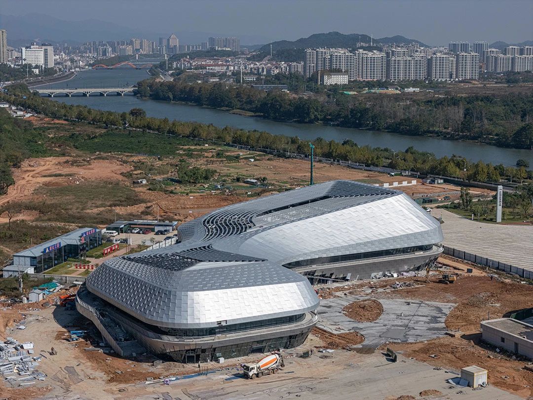

▲ 建造过程鸟瞰-Aerial-View-of-the-Construction-Process--©零壹城市-LYCS
随着幕墙完成,江山市群众体育中心游泳馆已经进行到了收尾阶段。这座现代化的体育综合体不仅将为江山市民提供一流的运动场所,还将探索一种新型的校园、民众和赛事分时公用的运营模式,将极大提升江山的体育产业和文化氛围,我们和市民一起无比期待这一项目的早日竣工!
With the façade nearing completion, the swimming pool at Jiangshan Sports Center is entering its final stages of construction. This modern sports complex will provide world-class facilities for the residents of Jiangshan and explore an innovative operational model that balances usage between schools, the public, and professional events.The team and the community eagerly anticipate its grand opening, which promises to elevate Jiangshan’s sports industry and cultural vitality.
