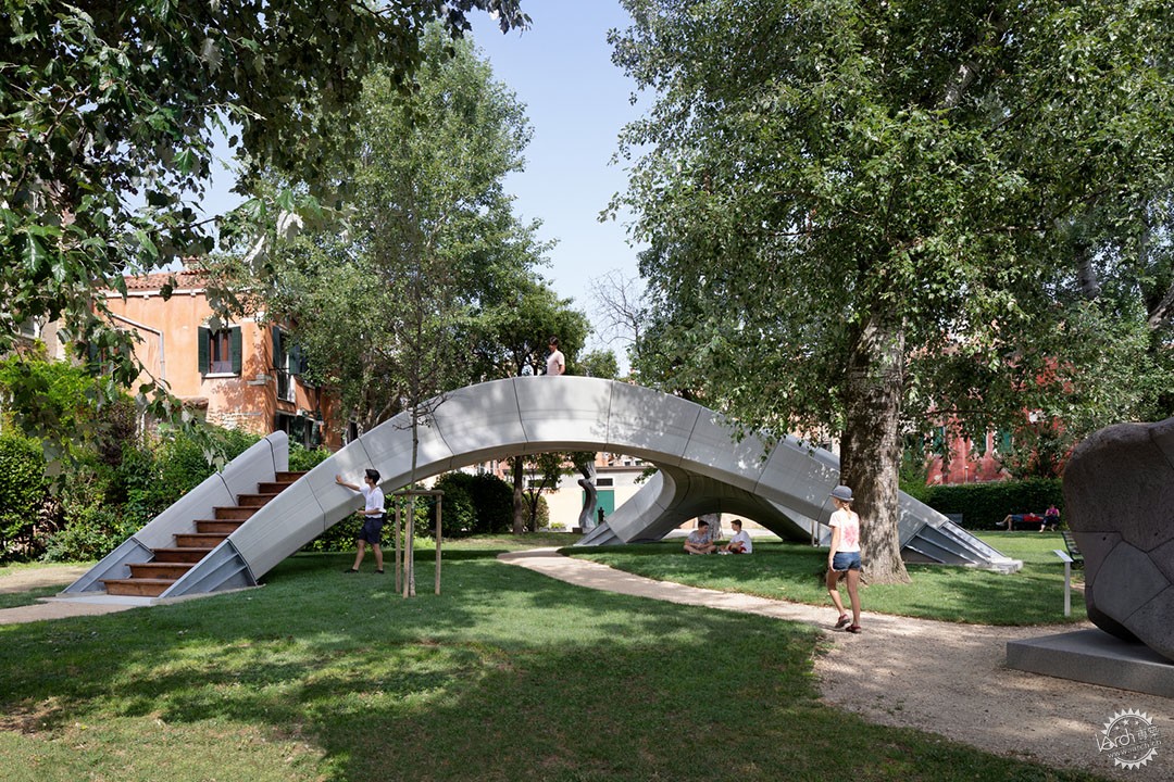

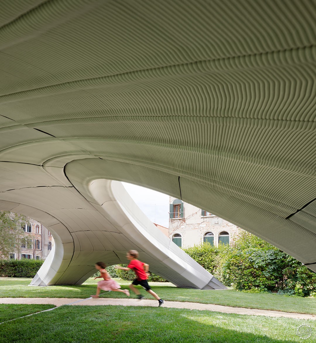

Striatus大桥是一座无钢筋砖石人行桥体,通过3D打印混凝土砌块构成,组装过程不需要用到砂浆,2021年11月,该大桥在威尼斯建筑双年展期间展出,这座16X12M的大桥是同类型作品中的首例,建筑师将传统技术和先进的计算机设计、工程技术,以及机器制造技术结合在一起。
Striatus is an arched, unreinforced masonry footbridge composed of 3D-printed concrete blocks assembled without mortar. Exhibited at the Giardini della Marinaressa during the Venice Architecture Biennale until November 2021, the 16x12-metre footbridge is the first of its kind, combining traditional techniques of master builders with advanced computational design, engineering, and robotic manufacturing technologies.

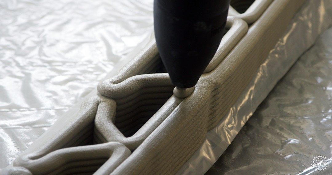

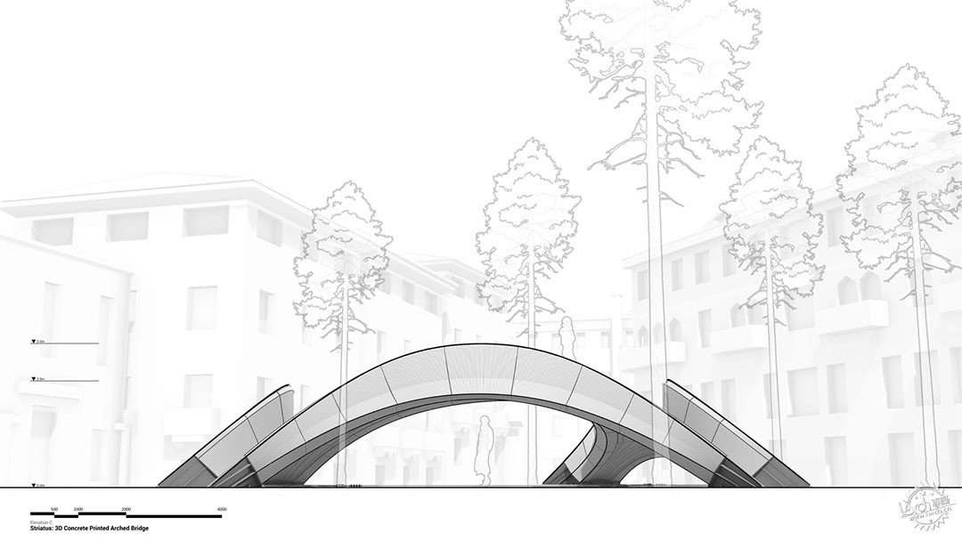

“Striatus”这个名字表达了结构逻辑和制造过程,混凝土和主要结构形成正交体系,构成了无需加固的压缩索装结构。
The name “Striatus” reflects its structural logic and fabrication process. Concrete is printed in layers orthogonal to the main structural forces to create a “striated” compression-only funicular structure that requires no reinforcement.

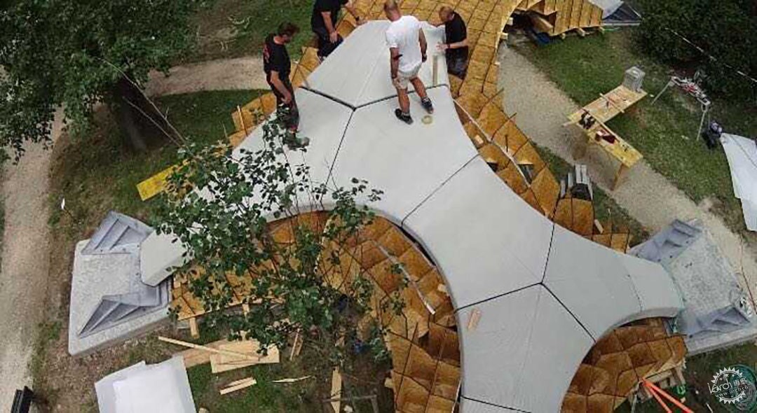

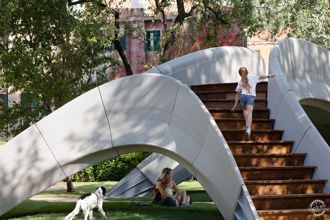

Block Research Group与扎哈建筑事务所的计算机设计团队共同合作,在威尼斯的一座公园里设计建造了一座12X16米的拱形人行桥。
这座桥体通过混凝土砌块建造而成,这些砌块构成了拱形,看起来很像传统的砖石桥,这种压缩结构让荷载能够传递到根基,并且彼此在地面连接在一起,这种组装结构让整体的几何形状保持稳定。
The Block Research Group teamed up with the Computation and Design Group at Zaha Hadid Architects to build a 12-by-16-metre arched footbridge in a park in Venice – entirely without reinforcement.
Using an additive process, the construction dubbed “Striatus” was built with concrete blocks that form an arch much like traditional masonry bridges. This compression-only structure allows the forces to travel to the footings, which are tied together on the ground. The dry-assembled construction is stable due to its geometry only.

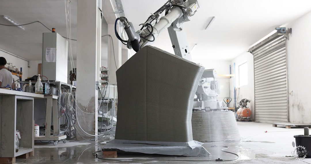

该项目通过3D打印构成,由研究人士与Incremental3D公司共同合作开发,混凝土的角度并非水平,而是有着特定的角度,从而构成压缩力,这样便能够很好地将砌块压缩在一起,后期便不需要加固,Holcim公司开发的3D打印设备所使用的混凝土墨水正是出于这个目的。
What is completely new is the type of 3D-printed concrete, which the researchers developed together with the company Incremental3D. The concrete is not applied horizontally in the usual way but instead at specific angles such that they are orthogonal to the flow of compressive forces. This keeps the printed layers in the blocks nicely pressed together, without the need for reinforcement or post-tensioning. The special concrete ink for the 3D printer was developed by the company Holcim precisely for this purpose.

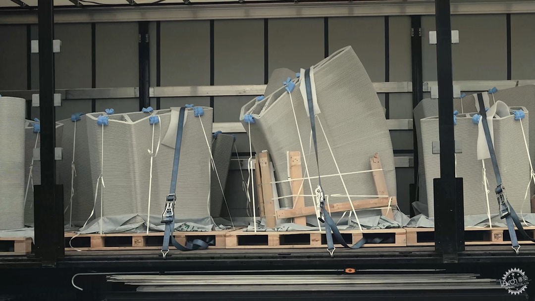

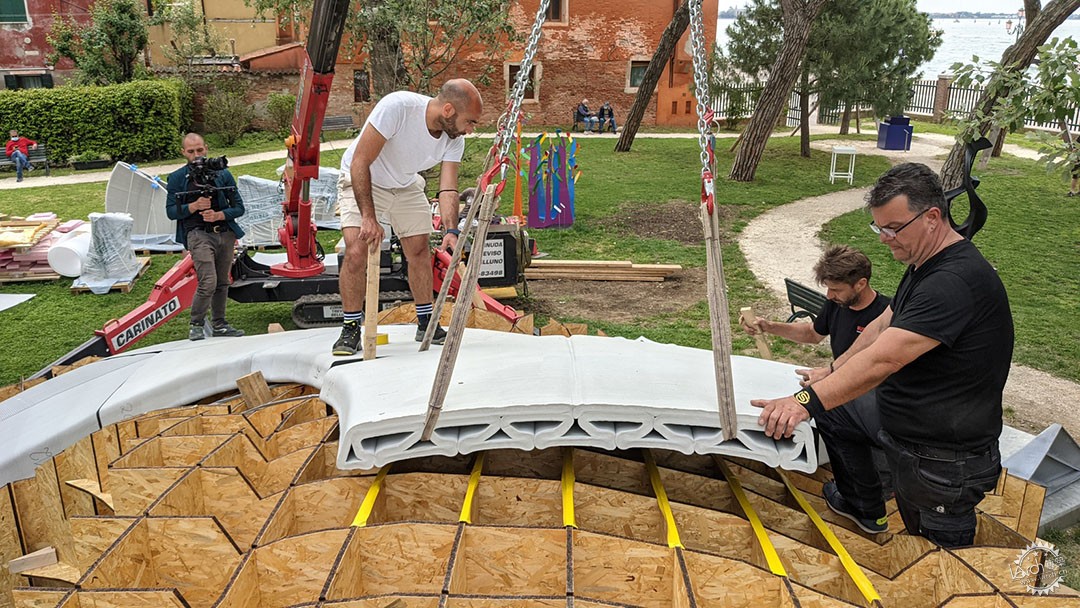

施工过程不需要砂浆,因此砌块可以拆除,并且桥体的不同位置可以重新组装,同时后期的拆除也很便捷。
Because the construction does not need mortar, the blocks can be dismantled, and the bridge reassembled again at a different location. If the construction is no longer needed, the materials can simply be separated and recycled.
