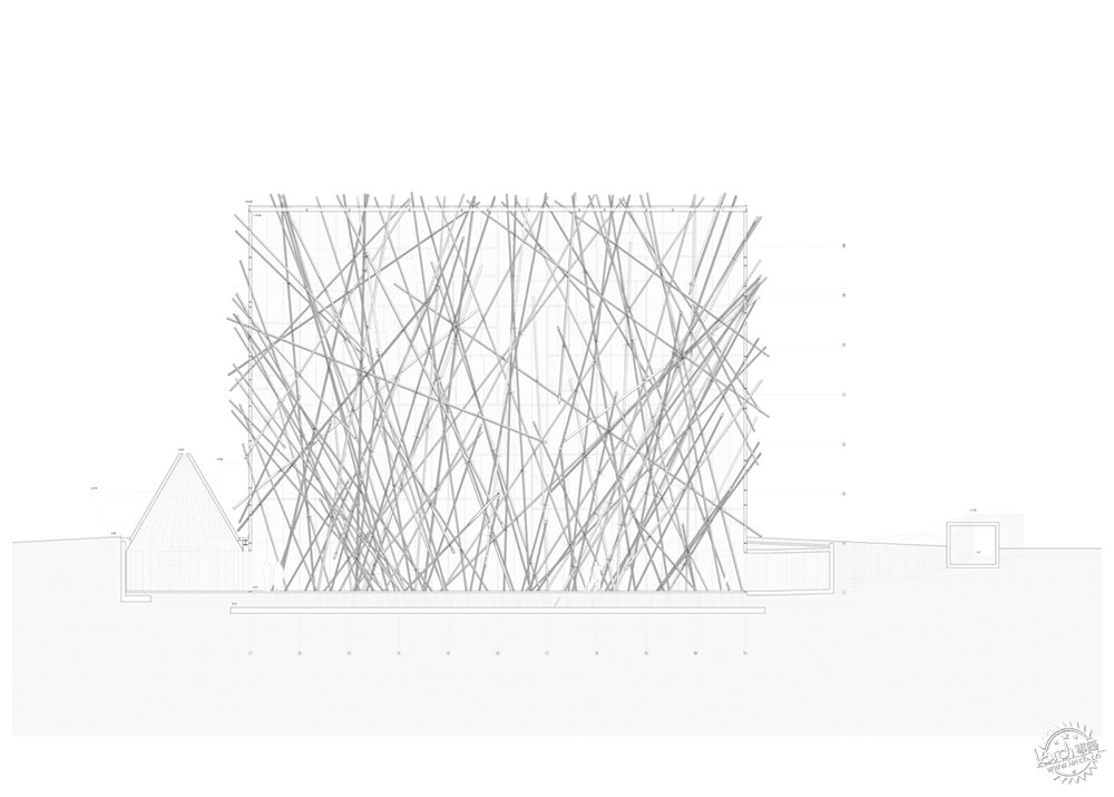

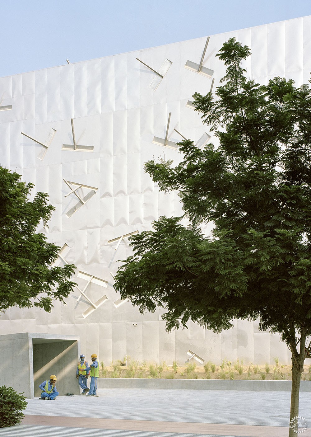

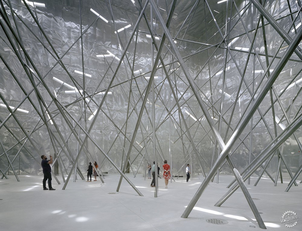

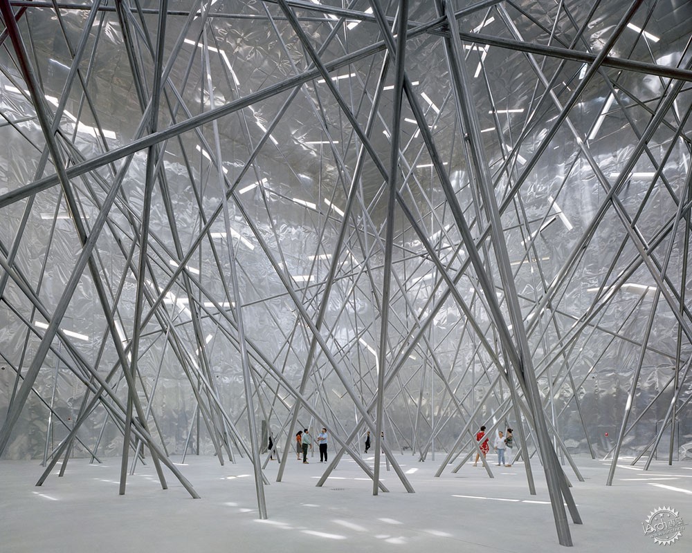

这座位于迪拜的展馆占地面积为900平方米,高度为23米,柱子和梁在水平和垂直方向上连接着建筑空间,不过在这个项目中,柱子全方位地延伸向远方,它们穿透了墙体和天花板,似乎延伸向建筑外部,而柱子布置的几何形态相互错落构成了窗洞。
Text description provided by the architects. The pavilion in Dubai consists of a hall with a floorplan area of ​​900 m2 and a height of about 23 m. Columns and beams ordinarily articulate architectural space horizontally and vertically, but here the columns spread out unfathomably in all directions. They penetrate walls and ceilings and end outside the building. The placement of the windows and the window reveals in the thin perimeter planes is a pure consequence of the geometrical arrangement of the columns.

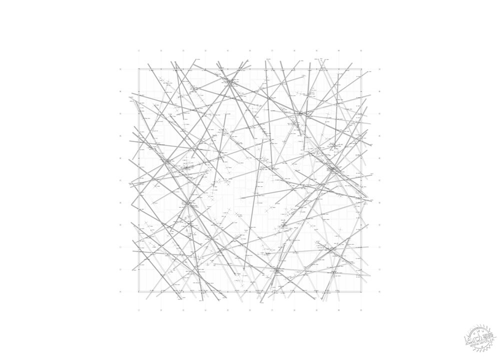

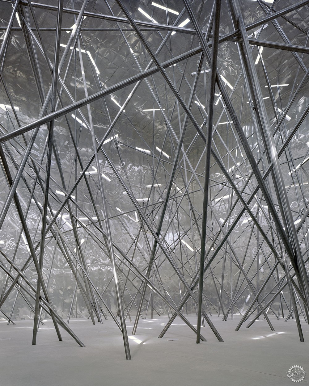

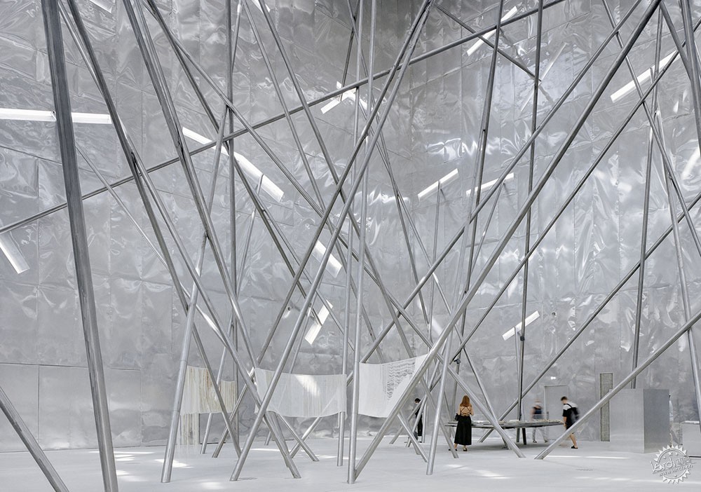

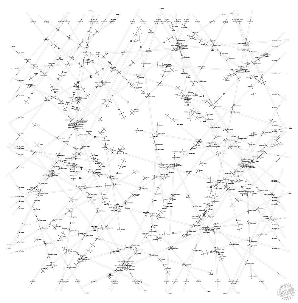

与此同时,光源形成了承重结构,并且加强了周边墙体和柱子之间的联系,倾斜的柱子在空间中彼此呼应,相遇的位置便相互焊接,也大大减少了其相对于空间实际尺寸的屈曲长度,这就是说,直径为11厘米的标准钢材就能够支撑整个空间,内部的墙体由14厘米的U型框架搭建而成,共同构成了独立的结构体系。
At the same time, this source of light forms the load-bearing and stiffens the connection between the surrounding walls and the columns. The slanted columns meet repeatedly in space and when they do, they are welded together. This drastically reduces their buckling length in relation to the actual dimensions of the space, which means that the room can be supported and stiffened solely by filigree standard steel profiles with a diameter of 11 cm. The walls are built with frames made of 14 cm thin U-profiles. Together, they work as one singular structural system.

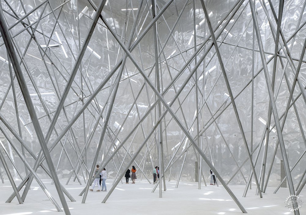

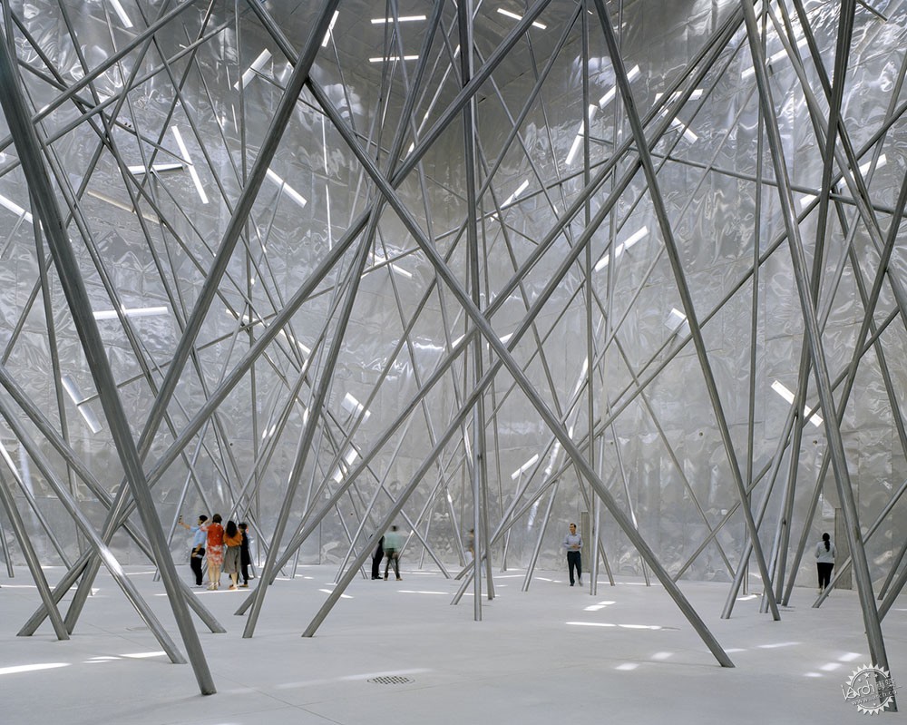

轻薄的柱子较为密集,但是它们从整个空间中穿过则显得非常轻盈,空间布局十分简约,支撑结构体系均匀地分布在空间之中,但整体又呈现了开敞的状态,除此之外,密集的柱子区域则与无支撑的开放区域交替出现。
While the thin columns seem extremely dense in overview, it is quite surprising how light and sparingly placed they appear, on walking through the built space. At first glance, the supporting structure deceptively looks as if it were evenly distributed throughout but vistas open up repeatedly across the entire expanse of the space. In addition, areas of densely spaced columns alternate with open areas that are completely free of supports.

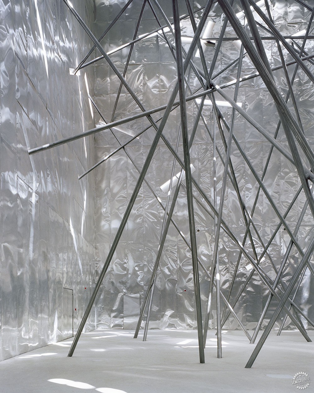

整个大厅中的开阔景观通过多种多样的视角得以表达,人们的视线会沿着柱子向各个方向延伸,很好地感受了空间的高度和广度,看到墙体甚至远方,围墙的框架覆盖着轻薄的铝板,其边界构成多重反射,外部覆层也通过略微弯曲的表面得以反射,表达了轻薄的框架网格。
The many open vistas throughout the hall are complemented by an infinite variety of additional views as the eye is repeatedly drawn up along the supports into the height and expanse of the room to the walls of the hall and beyond via the light slits. The frames of the enclosing walls are clad in thin, malleable aluminum panels, dissolving the boundaries into multiple reflections. The panels of the exterior cladding also reproduce the thin frame grid underneath through the reflections of the slightly cambered surfaces.
