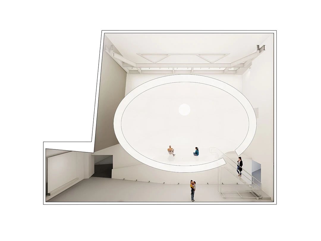

“母体——TA们的共享客厅”:泰康美术馆空间装置第11张图片
“母体——TA们的共享客厅”:泰康美术馆空间装置第12张图片
▲剖透视示意图 ©CPLUS
▲Sectional perspective drawing ©CPLUS
装置主体结构距离地面2.2米,与墙壁仅脱开一个微小的距离(最窄处不足1米),释放出强烈的空间张力。这种紧张感代表着一种膨胀与碰撞的微妙关系,暗喻了都市人面临的各种压力。
The main structure is 2.2m above the ground, and only a small distance (less than 1m at the narrowest point) away from the wall, releasing a strong spatial tension. This tension represents a subtle relationship between expansion and collision, implying a variety of metropolitan pressures.

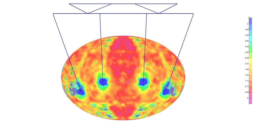

悬挂的吊点处会形成集中荷载,集中荷载会破坏表面气压形成的张拉效应,造成不美观的褶皱或者凸起,带来潜在的安全隐患。工程师通过指定力的传递路径,沿着椭球的切割剖面的切线方向设置拉索,让膜仅仅承受面内的拉应力,形成悬挂的吊篮,确保在整个应力线以下的范围内尽可能均匀的分散拉应力,消除掉应力集中的问题。
The hanging points will form concentrated loads, which will destroy the tension effect formed by the surface air pressure, causing unsightly wrinkles or bulges, and bringing in potential safety hazards. The engineers set tension load path along the tangent direction of the ellipsoid's cut section by specifying the force transmission so that the membrane only bears the tensile stress within the surface, ensuring that the tensile stresses are dispersed as evenly as possible within the range below the hanging points, eliminating the risk of stress concentration.
“母体——TA们的共享客厅”:泰康美术馆空间装置第21张图片
▲气膜结构应力分布图 ©张锦斌
▲Stress distribution diagram of air membrane structure ©Zhang Jinbin
结构总重3.8吨,球体自重1.2吨,长宽高为11.7X7.2X8.0米,充入130立方米约3.0千帕的空气。
The total weight of the structure is 3.8t, the installation weighs 1.2t, the length, width and height are 11.7X7.2X8.0m, and it is filled with 130cb.m. of air at about 3.0kPa.

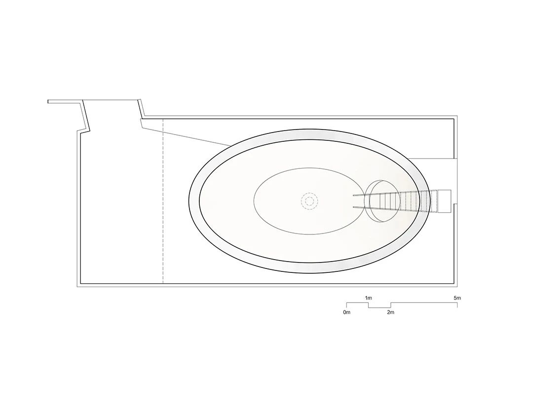

设计图纸
Project Drawings
“母体——TA们的共享客厅”:泰康美术馆空间装置第22张图片
▲平面图 ©CPLUS
▲Plan ©CPLUS
