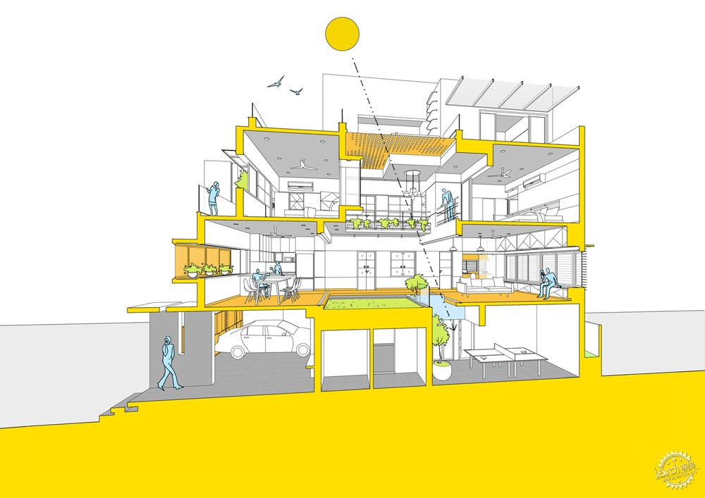

来自建筑事务所的描述:城市中居民最小使用面积为200平方米 或170平方米.针这类小户型,建筑师一般采取内向型措施,即设计中庭花园,其他住房围绕布置。因此,在该项目中,这一花园内设置停车库、女佣房和一间架起来的游戏室,平台上额外为客人增加了一间房间。
Text description provided by the architects. The smallest plot size available in most of the residential layouts of the city is about 200sqyards or 170 sqmts. A Large requirement on such a small plot called for an introverted solution with a garden at the center, around which the rest of the spaces function. This garden was lifted up to accommodate parking, a room for the domestic help and a games room on the stilt floor. An extra room was added on the terrace for guests.

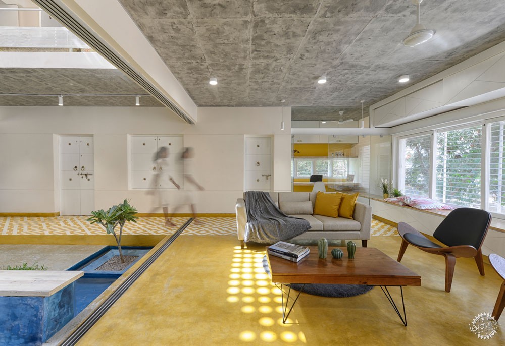

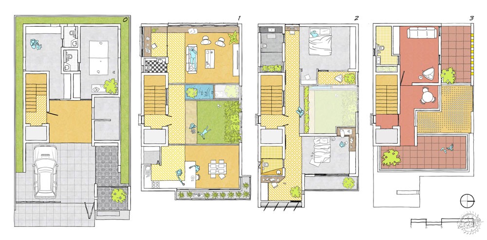

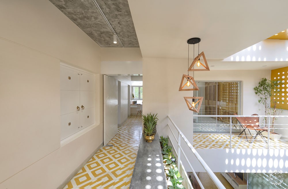

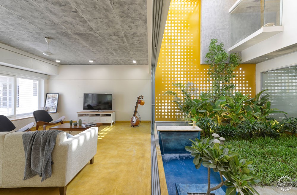

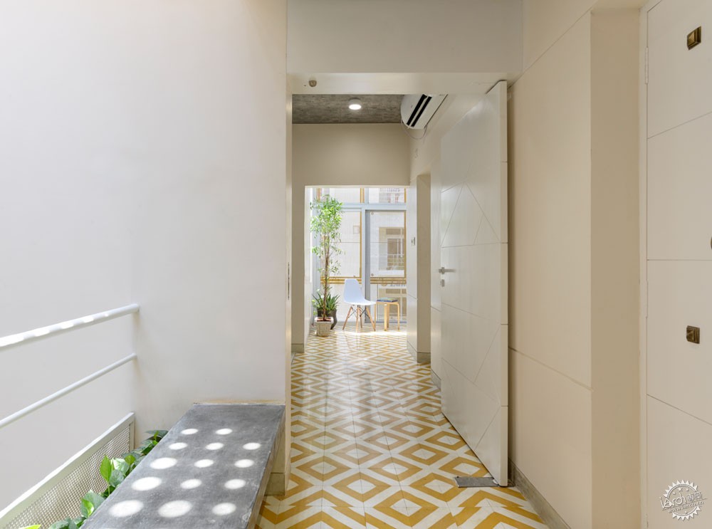

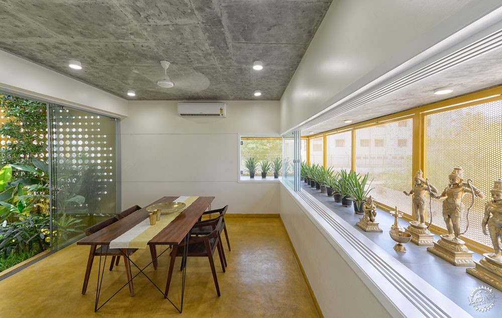

所有的服务空间都设置在南侧,可以隔绝主要空间的外部热空气。起居室和餐厅围绕花园设置,采用可移动的倾斜玻璃门分隔空间。当把门打开时,整座建筑在则变成通透的单一空间,与花园紧密相连。两间卧室设置在二层,通过平台走廊连接。
All services were pushed to the south as a buffer to the heat. The living / dining areas surrounding the garden have operable, sliding glass doors to contain the air conditioning. When these are open the whole length of the house behaves as a single space connected by the garden. Two bedrooms are pushed to the next higher level connected by a corridor with a concrete bench.

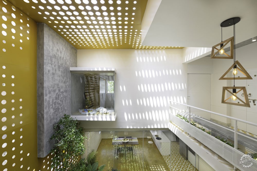

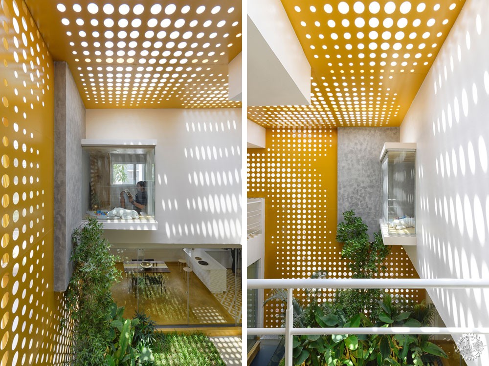

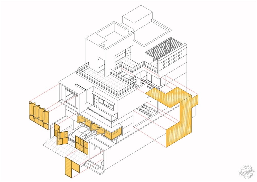

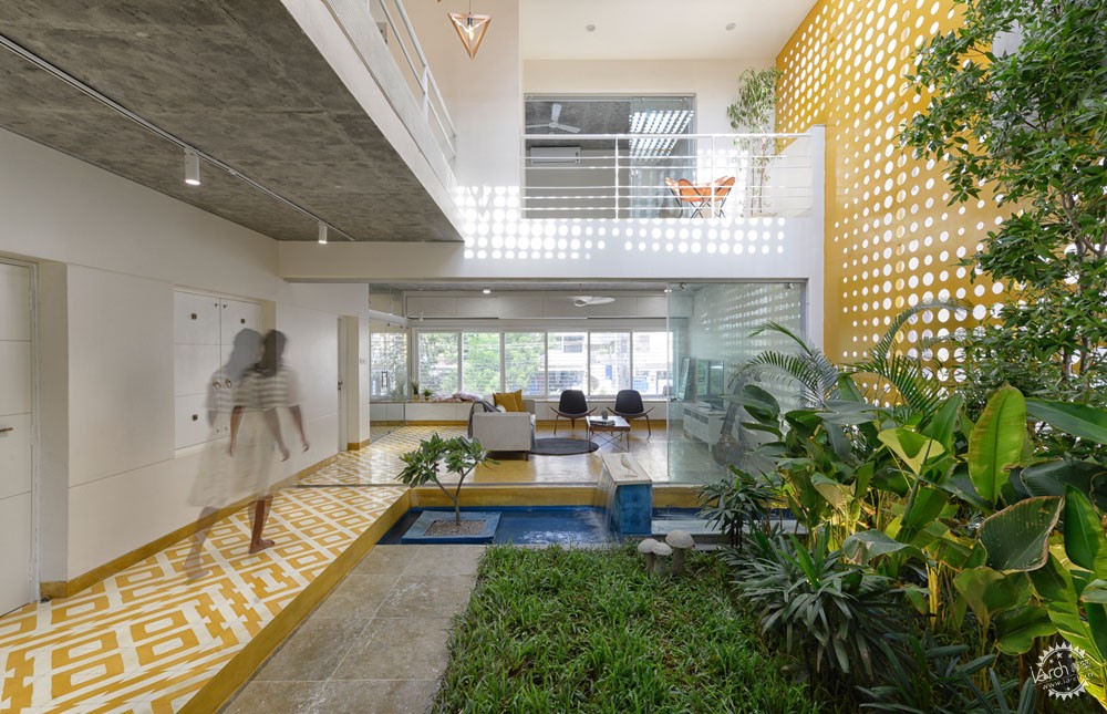

中庭通高空间四周利用激光切割出一系列带孔洞的低碳钢作为立面。这种参数化设计可以营造私密性空间。立面上有着很小的孔洞,从相邻建筑望向庭院和整座建筑时,人们只会看到黑色的建筑墙面。
The central double height court is covered with mild steel, with laser cut perforations; parametrically designed to create privacy. The perforations are smaller where the adjacent building has an opening looking into the court and larger, where the building has a blank wall.

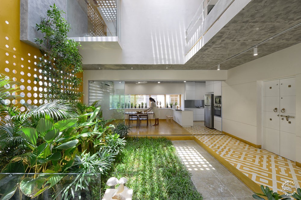

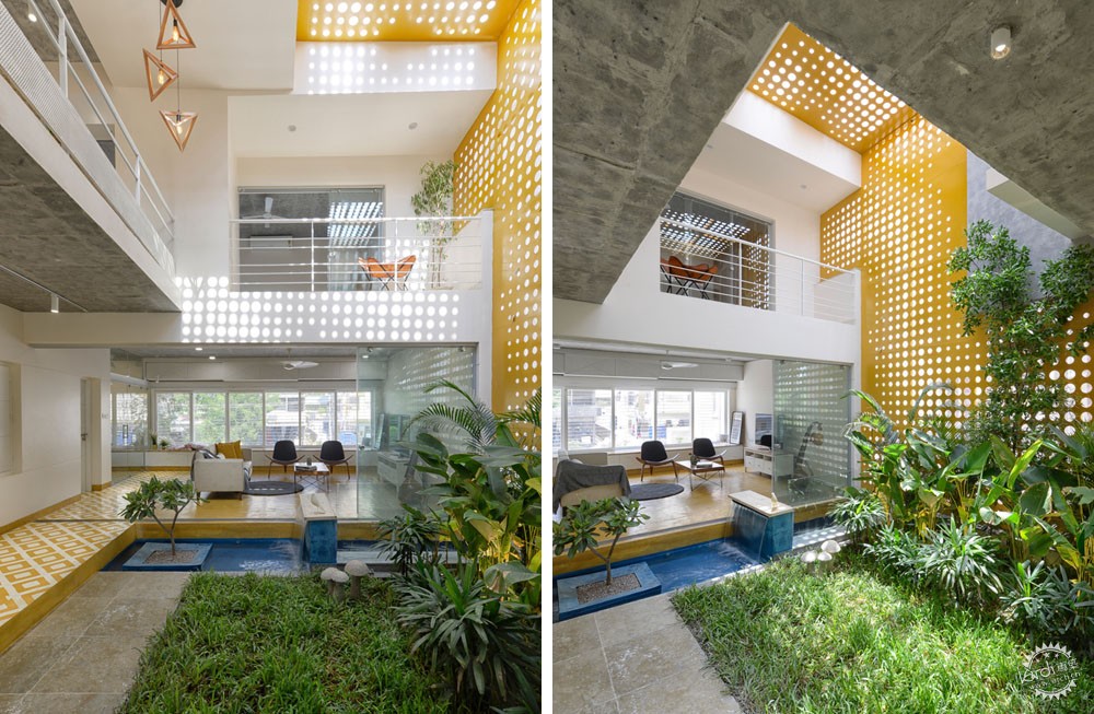

整个系统采用玻璃屋顶,立面采用不锈钢网,抵挡雨水和昆虫。阳光通过孔洞洒在中庭内,其中种植有热带植物。阳光通过洞口进入地下游戏室里,庭院中设置小型喷泉,喷泉的流水声使这一热带环境生机勃勃。无论任何人来到这里,他们都会感受到花园中的自然气息。
This system is covered with glass on top and stainless steel mesh on the side as a protection from rain and insects. The filtered light through this powers the tropical growth of the garden below. A cutout allows light all the way to the games room in the basement below.  The garden also houses a fountain which brings the tropical environment alive with its sound of water. Wherever one is in the house they’re always aware of the elemental nature of the garden.

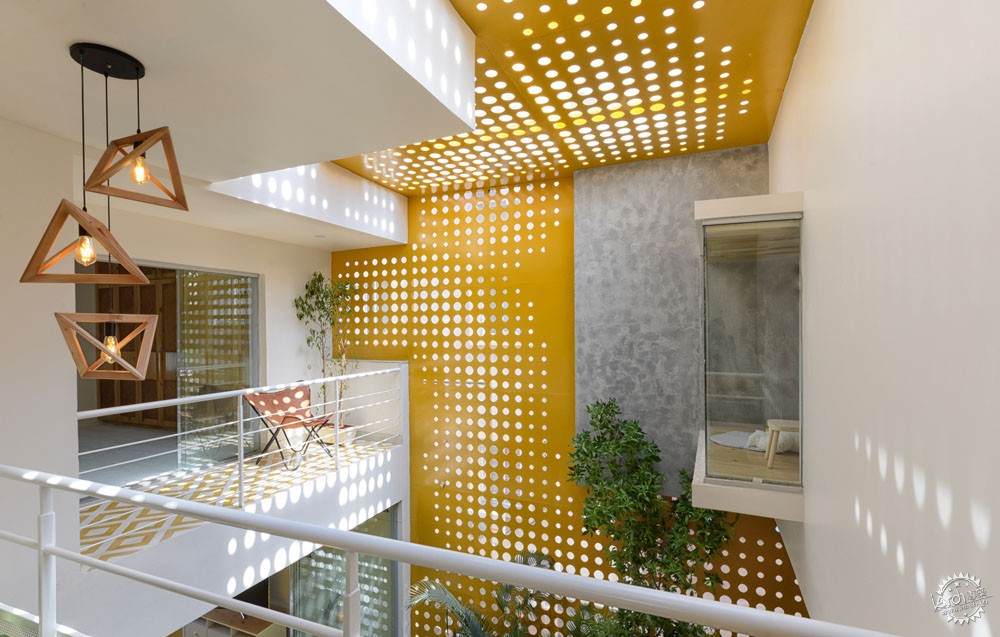

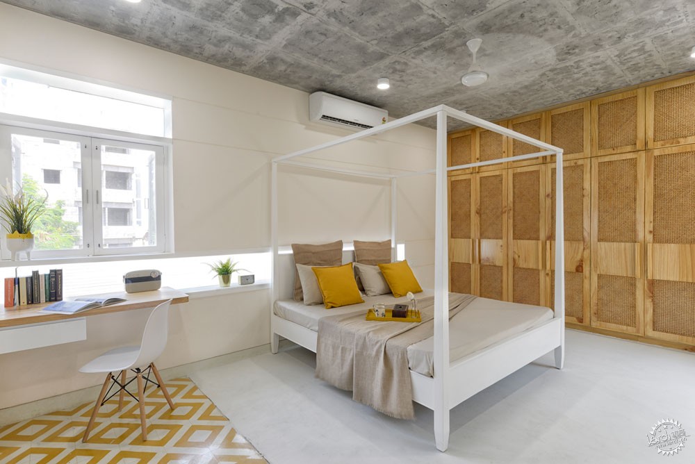

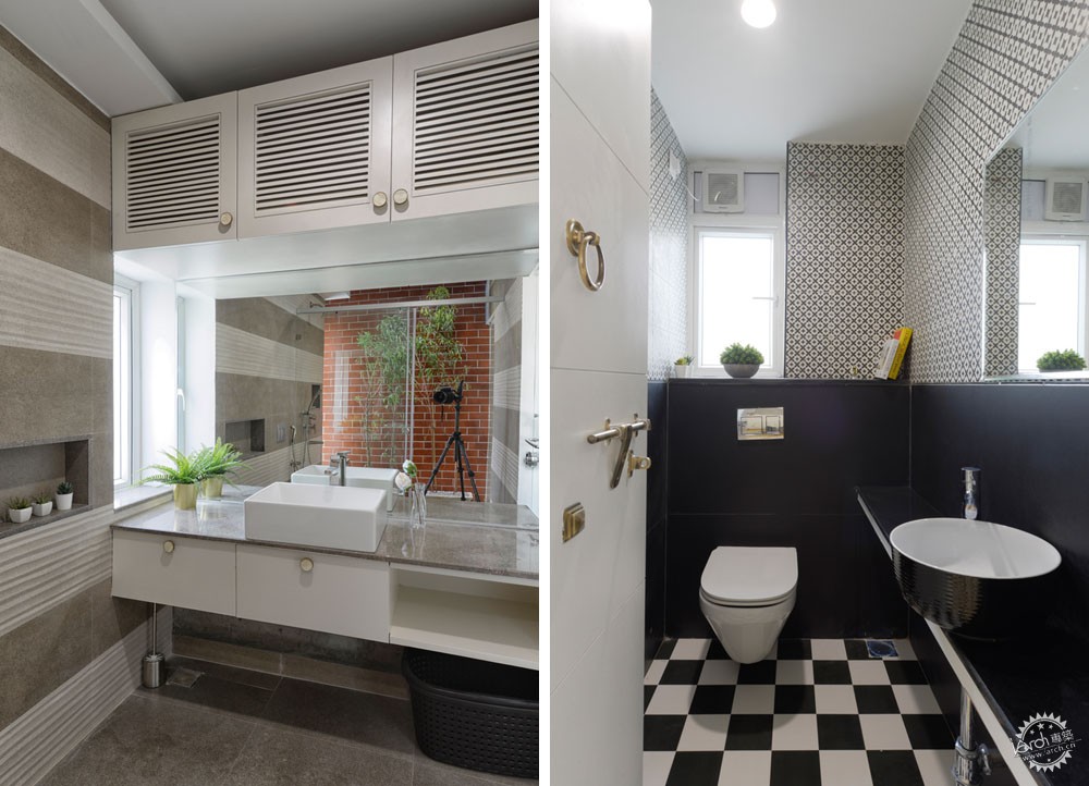

主卧室的阳台向庭院内出挑打开。壁橱采用手工制作,这种手工艺术即将失传。庭院相连的卫生间一侧开敞透明,使用者在卫生间内可以欣赏庭院的植物,卫生间的顶部也采用了天窗进行采光。
The master bedroom has an attached balcony which opens up inwards onto the garden below. The wardrobe features handmade cane work, a fast vanishing craft practice. The attached toilet is made transparent so the planters inside are visible, lit from the skylight above.

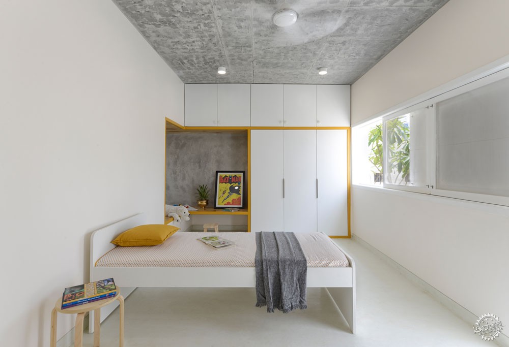

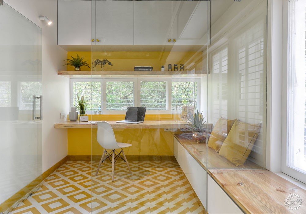

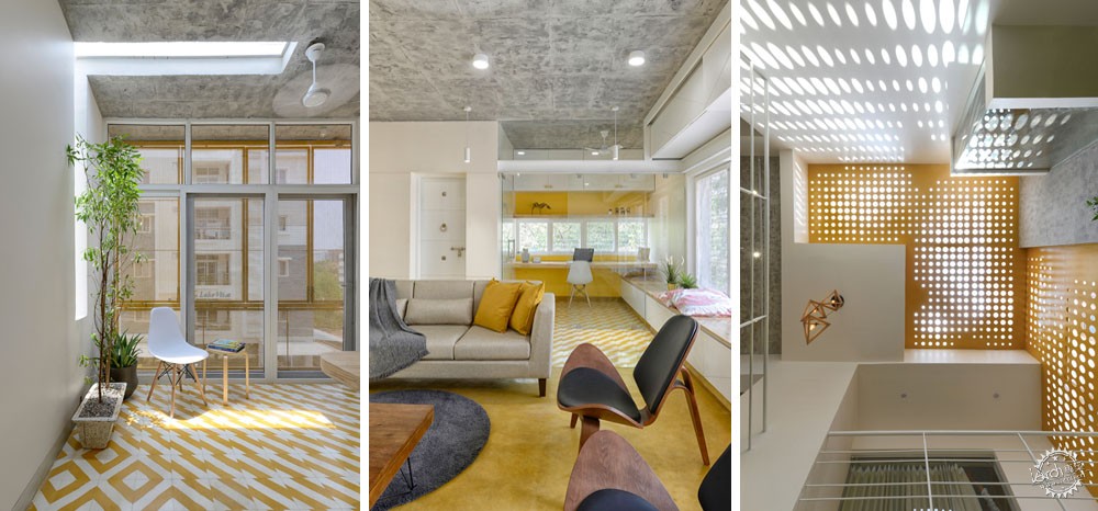

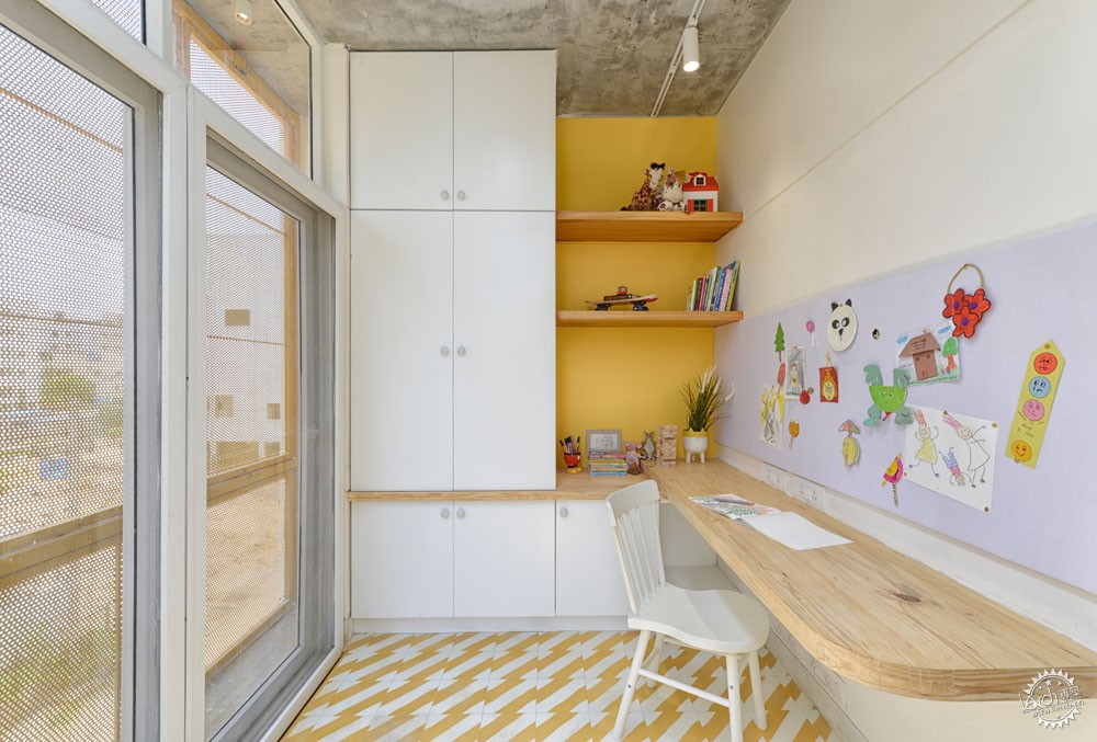

儿童房东侧设置阳台,另一侧设置一些橱柜,在这里使用者同样可以看到下面的庭院。书房屋顶设置细缝天窗,这吸引着使用者的视线。工作区域在白天有着充裕的自然采光,阳光通过光孔板的过滤,洒在书桌上。
The kid’s bedroom has a balcony which opens onto the east. A play nook is integrated into the wardrobe which looks down onto the garden as well. The study room attached has a planter under a slit skylight which forms a focal point as one enters the room. The study area is lit with the eastern sun in the mornings which filters through the perforated screen and hits the study desk.

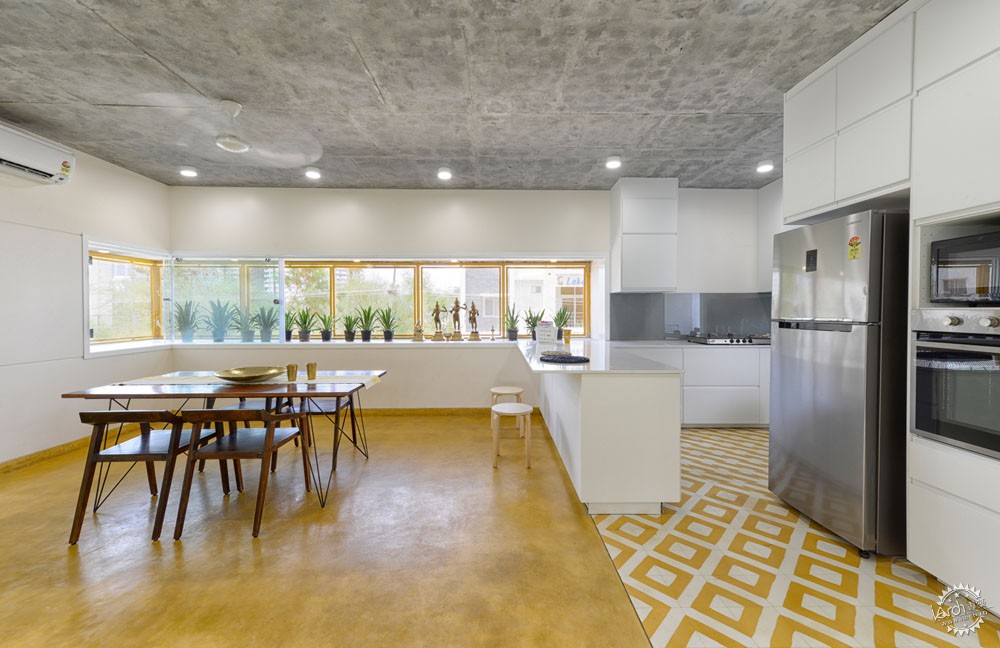

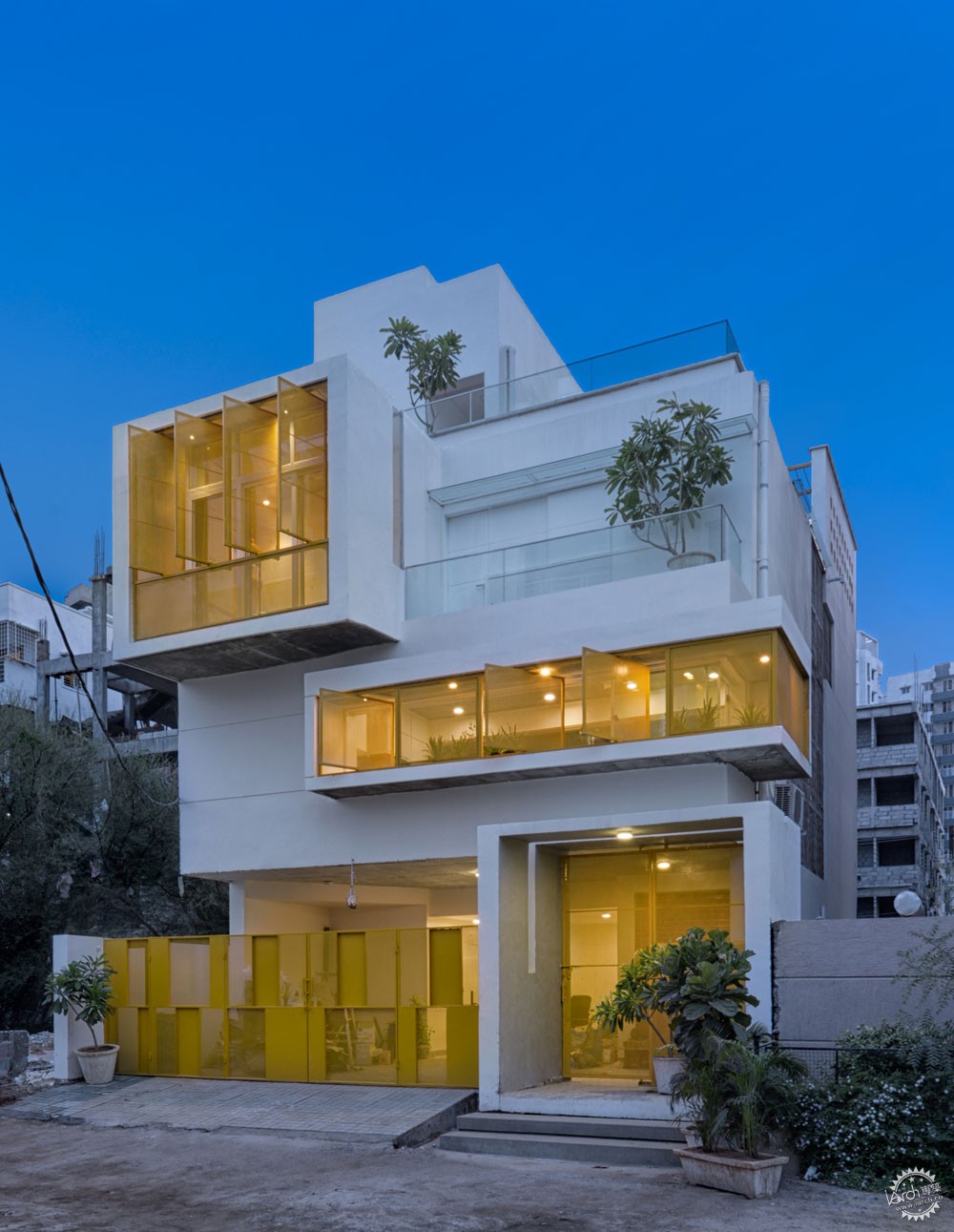

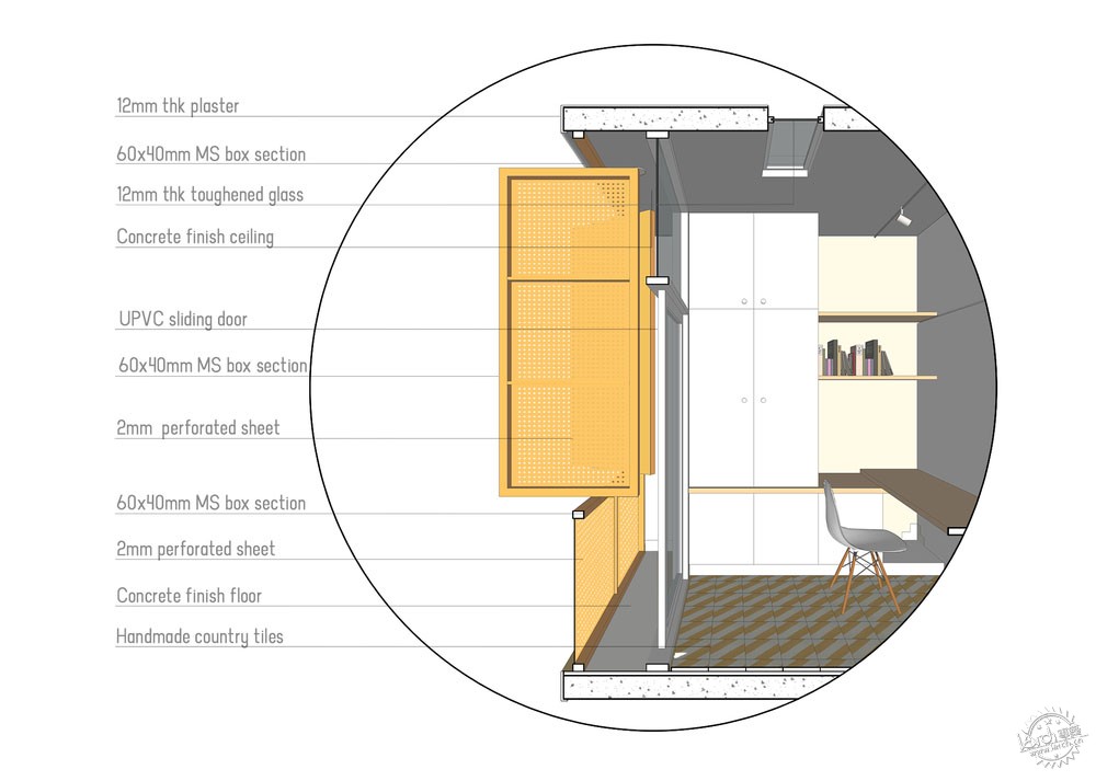

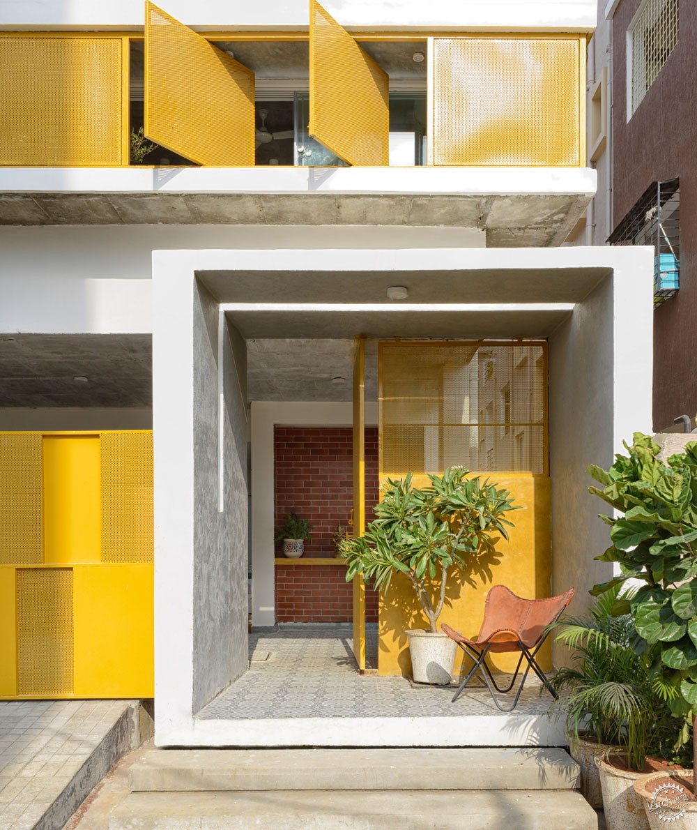

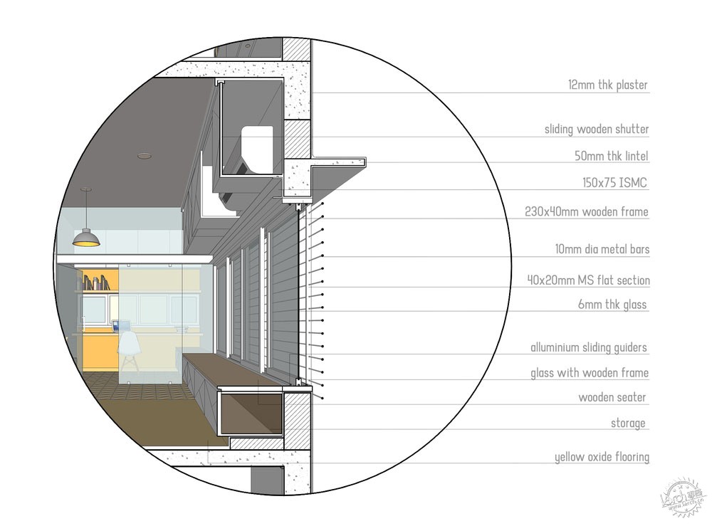

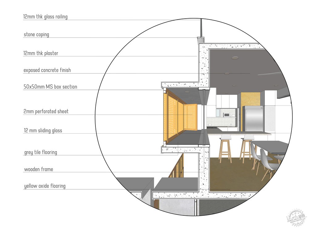

立面的低碳钢板同时作为遮阳板,它与临近的建筑分隔开,保留一定的私密性。这些光孔板并不透明,白天从外部吸收光线,夜晚则向外渗透光线,使整座建筑变得通透,散发出的光线如同黄色的宝石。地面采用黄白相间的水泥,这是由手工制成的水泥瓷砖和陶瓦砖。天花板采用粗糙的混凝土板,墙面大部分是白色的,偶尔配以黄色的轮廓线。
The façade has operable louvers made out of perforated mild steel. This offers a certain amount of privacy from the close proximity neighborhood. They are opaque from the outside during daytime and when the light shines from within in the evening, they become transparent and shine like a yellow jewel. The flooring is a mixture of yellow & white cement oxide, handmade cement tiles, yellow tandoor and terracotta tiles. The ceilings are left exposed after the de-shuttering of concrete slabs.  Walls are mostly white with an occasional yellow highlighter.
