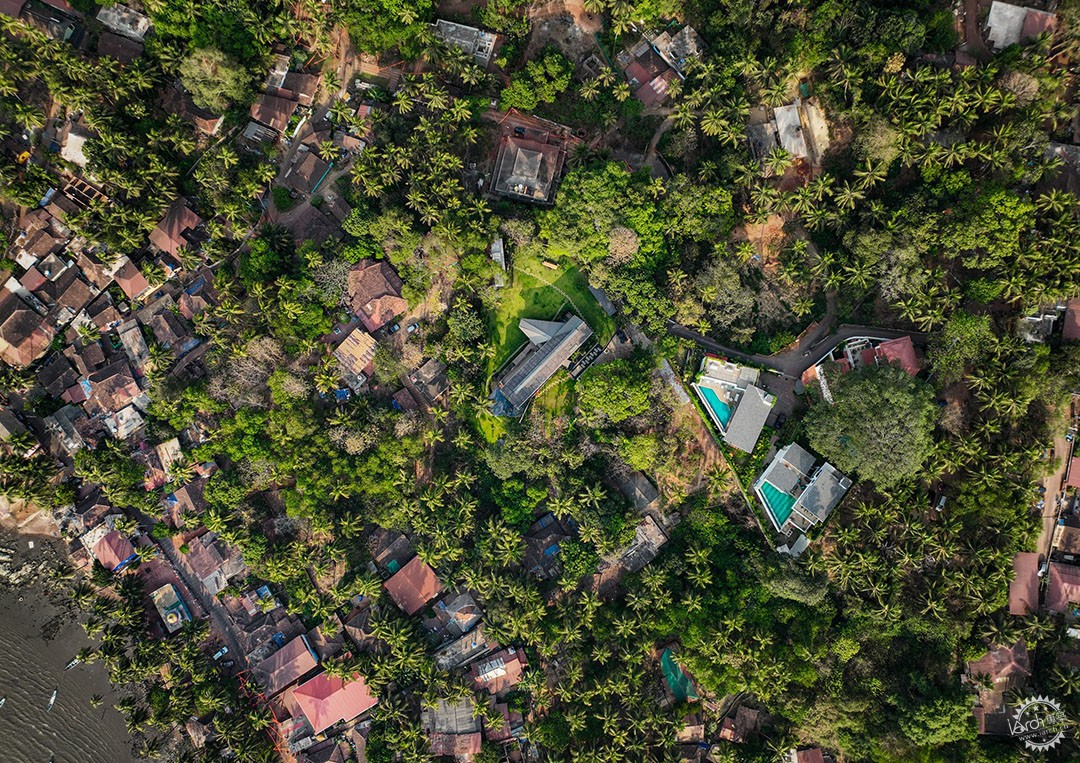

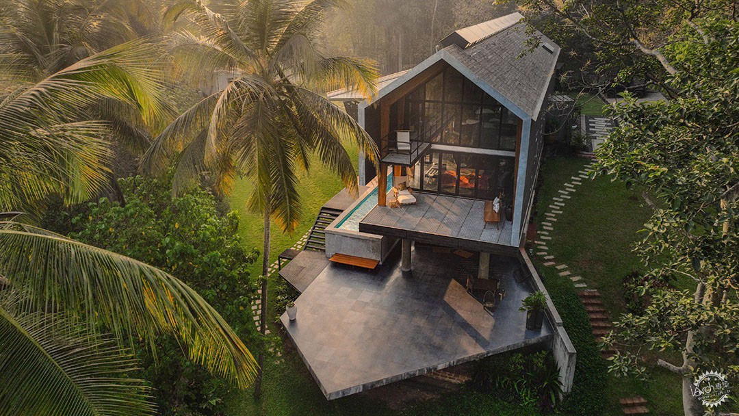

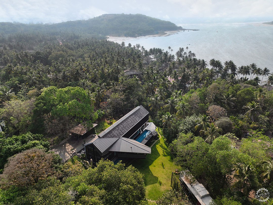

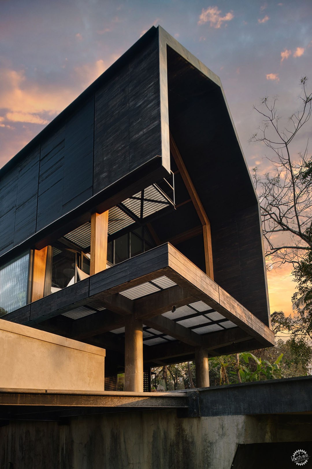

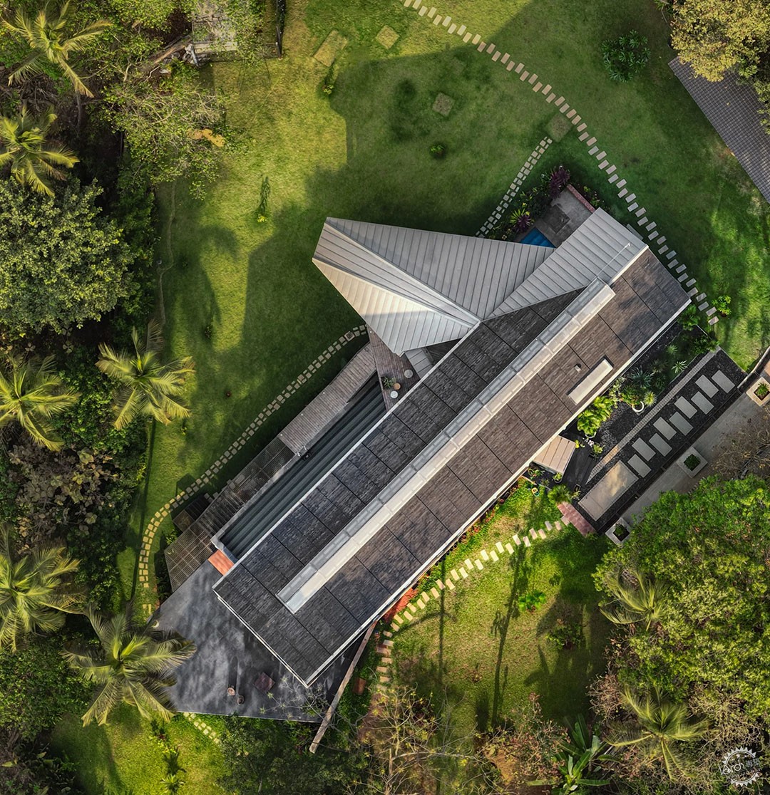

这座呈线性的建筑体坐落于果阿瓦加托(Vagator)查波拉河(Chapora River)边缘附近一处陡坡的最高点上。
该团队计划以对场地影响最小的方式建造这座住宅,于是将其搭建在桩柱基础和混凝土挡土墙之上。把楼板抬离地面这一举措,还能够有效抵御湿气以及表面张力作用,从而更好地保护房屋。
The linear block stands at the highest point of a steep site near the edge of the Chapora River in Vagator, Goa.
The team intended to construct the house in a minimally invasive manner and perched it on a foundation of stilts and concrete retaining walls. Raising the floor plate above the ground also gave protection from moisture and capillary action.

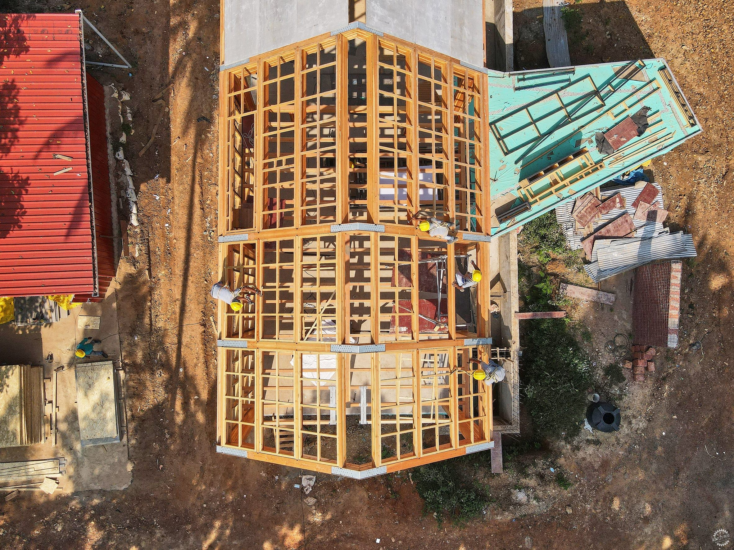

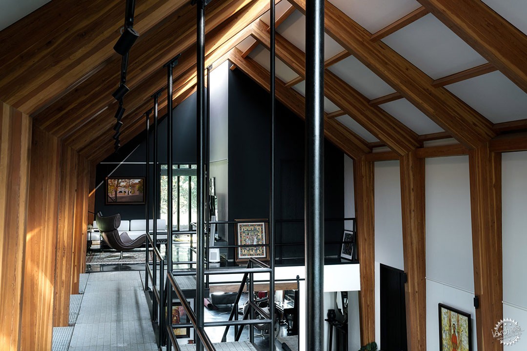

在这桩柱基础之上,胶合木门式框架构建起了房屋的整体架构。这些框架事先在德里完成预制工序,而后被运至果阿进行现场组装拼接。
“预制流程极大地确保了构建的精准度,而且在现场组装框架结构的速度相较于传统建造方法有显著提升。”Bhatt如此评价道,“最终成型的建筑结构,既洋溢着现代进步的气息,又深深扎根于当地的环境与文化,充分彰显出大型木结构在实现可持续发展目标与营造美学观感方面的独特优势与强大能力。”

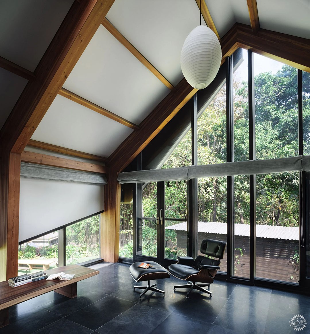

下层的起居区域采用开放式的布局规划,营造出宽敞通透的空间感,在空间的后部巧妙地设置了两间客用套房,使整体布局更显合理与完善。
起居区域的三面均安装了玻璃墙,让自然光线能够充分照入室内。这些玻璃墙与从客厅前部向外延展的露天平台相互配合,为居住者提供了周围葱郁景色的开阔视野。
Above this, the glulam portal frames, which were prefabricated in Delhi and assembled on-site in Goa, form the house's structure.
"The prefabrication process allowed for incredible precision, and assembling the structure on-site was faster than traditional methods," Bhatt commented.
"The finished structure feels progressive yet rooted, reflecting the ability of mass-timber to achieve both sustainability and aesthetics."

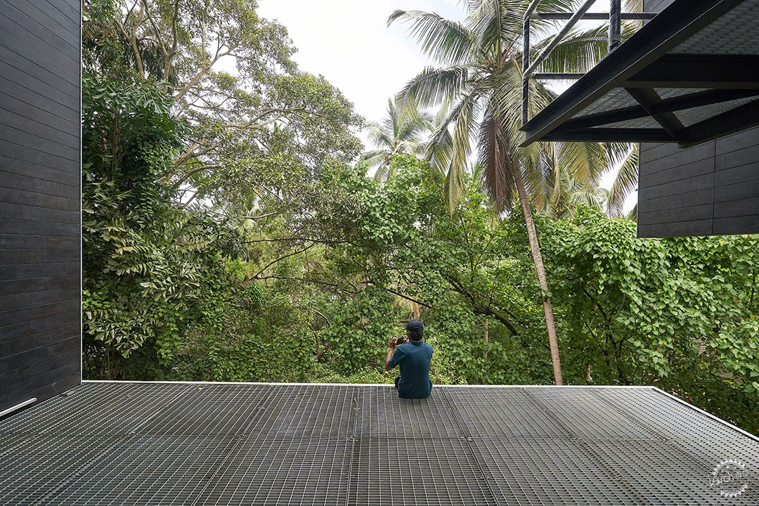

The living area is arranged in an open plan on the lower level, culminating in two guest suites at the rear.
It is lined with glazing on three sides, allowing natural light to flood the space. The glazing, along with an open deck extending from the front of the living room, provides unobstructed views of the lush surroundings.

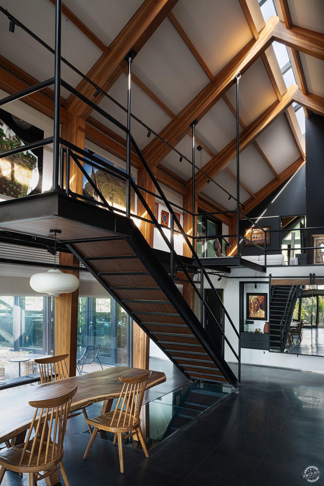

考虑到客户崇尚简约的生活理念和方式,设计团队特意甄选了款式简洁且配有精致皮革软垫的家具,其中包括一把伊姆斯椅(Eames chair)。
一个精巧的夹层空间凌空而设,从这里可以俯瞰下方开阔的起居区域,二者通过一座造型别致的金属楼梯紧密相连。设计团队在这个夹层区域打造了一处画廊式的展示空间,专门用于陈列客户的艺术藏品,由此可通向主卧室。
该工作室在室内设计上选择了简约的色调搭配,旨在展现木框架的原始形态。墙壁被刷成白色,搭配黑色花岗岩地面。
As a result of the client's minimal lifestyle, the team selected simple furniture pieces upholstered in leather, including an Eames chair .
A mezzanine level overlooks the living space, connected by a metal staircase. The team designed a gallery space here to display the client's art collection, leading into the master bedroom.
The practice chose a pared-back palette for the interiors, intending to express the raw form of the timber frames. The walls are painted white, coupled with black granite flooring.

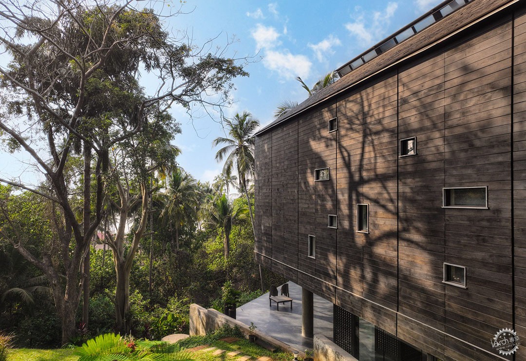

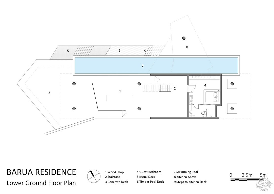

地面层的架空空间内设有一个玻璃环绕的空间,被业主用作木工工坊。
建筑外立面覆盖着烧焦的木板,这种木板采用了一种古老的日本木材保护技术 —— 烧杉板工艺制成。选择这种材料是因为它具有耐久性和防潮性,非常适合果阿的热带气候。
The stilted volume on the ground level houses a glass-lined space use by the client as a wood workshop.
The exterior surface is covered with charred timber cladding created using an age-old Japanese preservation technique called Yakisugi. The material was chosen for its durability and moisture resistance, ideal for Goa's tropical climate.

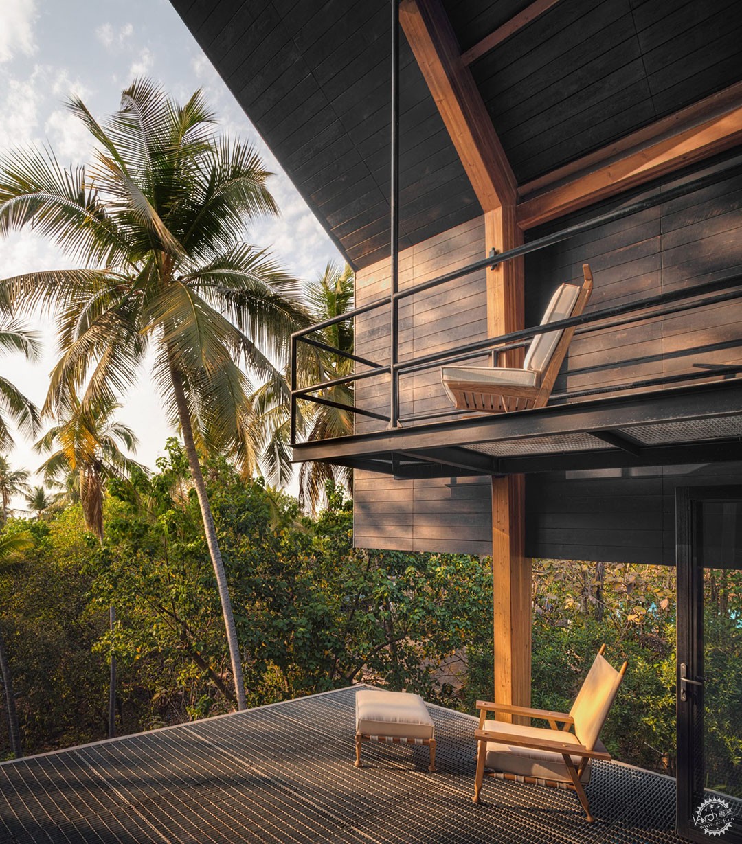

▲ 客厅向外延申连接着一个露天平台
The living room extends into a deck
