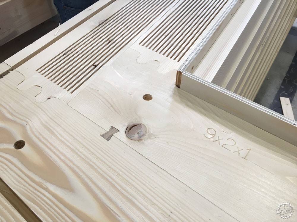

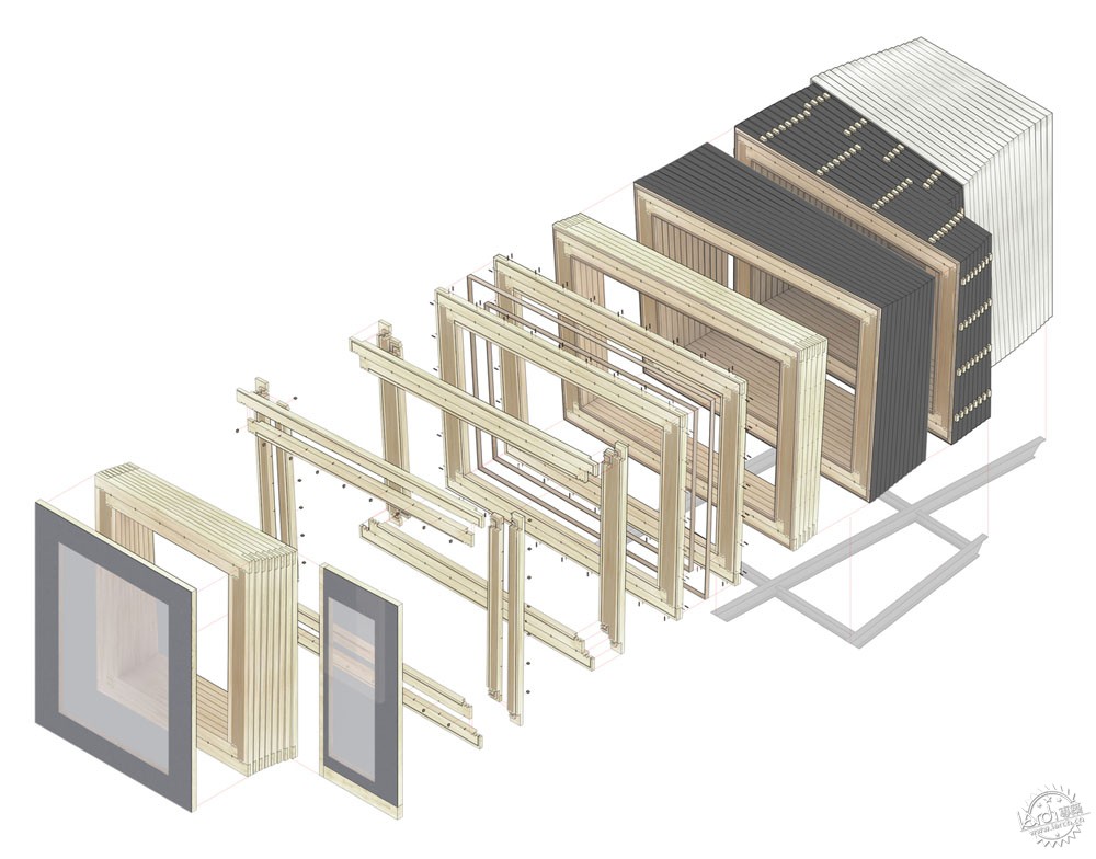

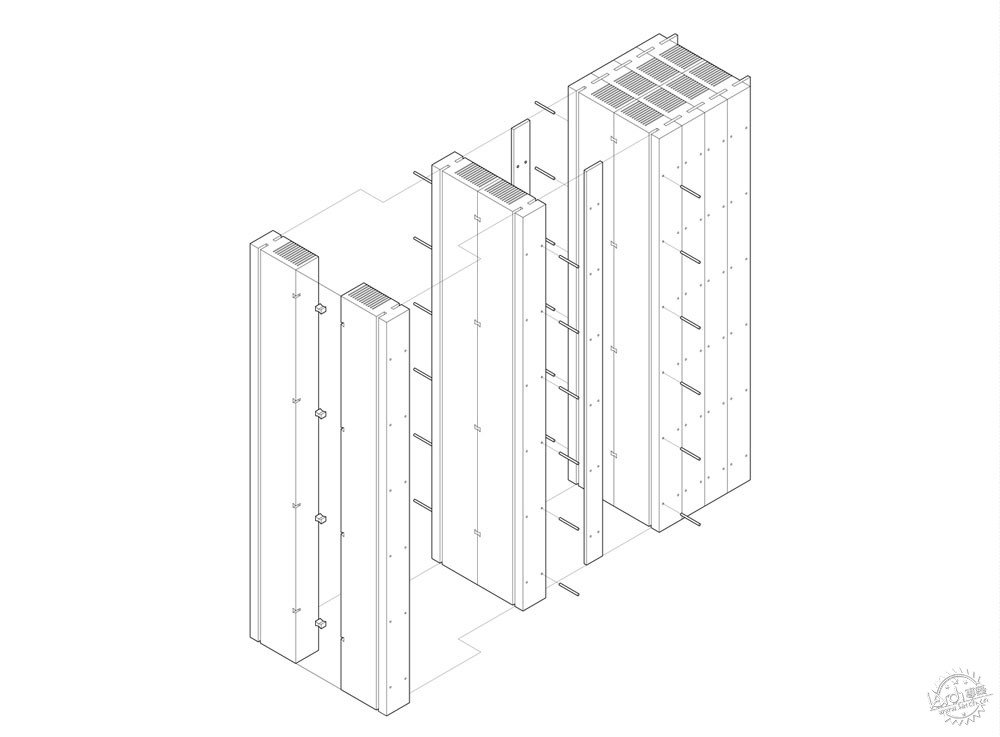

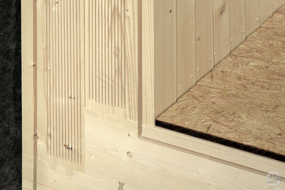

相较于水平堆叠的典型木材施工方式,该项目中的木材元素通过交错竖直的框架体系而排布。因此,其中的竖向构件有着明确的方向感,这些小狭缝能够减轻应力,防止木材开裂,同时保证了尺度感、精准性,以及密封特征,这些特征正是传统木材工艺中所缺少的几个方面。另外,这些狭缝能够减少热量的传递,提升材料的绝缘作用。数字制造常常应用于生产高紧密材料,或者应用于木材元素的连接构件之中,甚至不需要其他的金属连接件。
In contrast to the horizontal stacking of typical log construction, here the sol- id timber elements are arranged as staggered upright frames. Thus the ver- tical elements are oriented in the strong direction of the wood which allows for sawing slits in the solid timber without comprising its structural capacity. These thin slits serve as stress-relief cuts, which prevent the solid timber from splitting. This ensures dimensional stability and airtightness, both significant issues in traditional log construction. At the same time, the slits are utilized as dead-air chambers, reducing thermal conductivity and increasing the insulation values of the material. Digital fabrication is employed to produce high-precision, airtight joints for connecting the timber elements without the need for any metal fasteners or adhesives.
