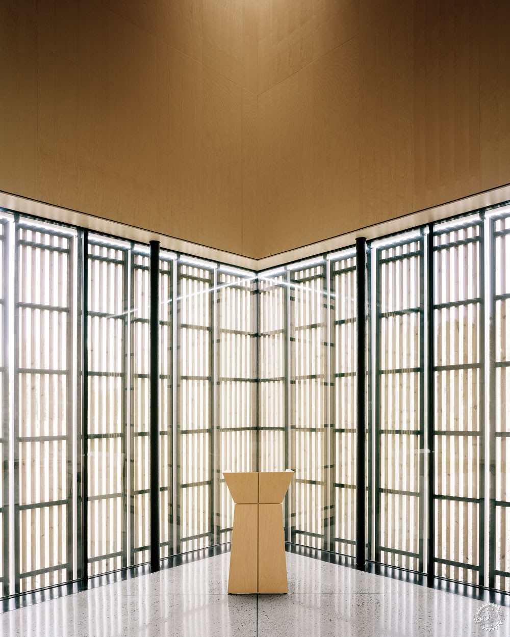

建筑师说:“最重要的元素是光线能够从不同的角度进入室内,这象征着希望,在教堂毁于火灾之后,这是光明和黑暗的对决。”
合作设计的关键是28扇窗户的设置,这些窗户贯穿主要大厅的东北角落,能够让更加充足的光线进入建筑内部。
"The most important element is the work with daylight coming into the church from different daylight openings," the architect said. "This symbolises hope, and that light defies darkness after the tragic loss of the old church."
A key outcome of the collaboration is the configuration of 28 windows that pierce the northeast corner of the main hall and allow additional daylight to fall on the altar.

而从外部来看,建筑开口如同简约的垂直凹槽,Dietrichson从内部进行了角度的切割设计,并且通过镜面来反射阳光。
建筑外部覆盖着木板,这是一种当地常用的材料。其表面呈现渐变色彩,大约每50年需要更换,也代表着教堂“将会不断重生”。
The openings appear as simple vertical slots when viewed from outside, while internally Dietrichson introduced angled cuts and mirrored surfaces to reflect the light in a pattern resembling a sunburst.
The building is clad externally in boards of heartwood pine, which is a wood commonly used in local construction. The natural facades will gradually darken, and the intention is that they be replaced every 50 years so the church "will resurrect as new for every new-born generation".
