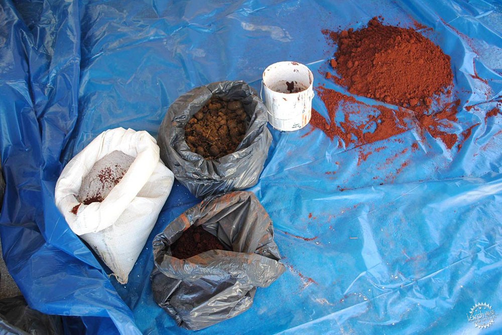

How to Make Adobe Plaster
To make adobe you need a sieve, a bucket, and a canvas
学了这招之后,自己也可以刷墙啦第3张图片
生土组成
  • 1桶泥土(选择你喜欢的颜色)
  • 1桶动物粪便(来自牲畜或马)
  • 2-3桶沙(数量取决于沙粒程度)
Adobe Composition
  • 1 bucket of dirt (choose your preferred dirt color)
  • 1 bucket of dung (from livestock or horses)
  • 2 - 3 buckets of sand (depending on the level of sand in the dirt)
  • Water

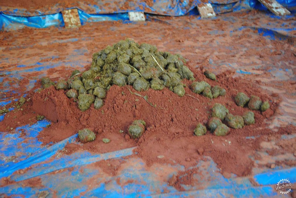

The Step-by-Step Guide
  • Mix the sand and the dirt until you get a uniform mixture
  • Ground the dung well and mix it dry with the dirt and sand
  • Build a mound with a hole in the middle, like a volcano, and pour the water into it, little by little, so as to avoid spilling it into the canvas
  • Mix it using your feet. You will be able to feel the mixture start blending and when it does, do spiral movements inside out to ensure uniformity

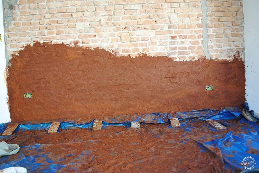

  • Apply the plaster to the wall by hand

简朴的墙体刷好了,外观上有着天然的纤维质感,同时结合有砖石细部。小贴士:这些原料混合在一起之后,动物的粪便是不会有气味的。
图片: Rafael Loschiavo | Ecoeficientes
The result is a rustic wall, naturally colored with natural fibers, with a brick line detail. It is important to stress that the dung does not smell once the mixture is applied.
